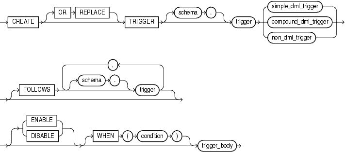

The CREATE TRIGGER statement creates or replaces a database trigger, which is either of the following:
A stored PL/SQL block associated with a table, a schema, or the database
An anonymous PL/SQL block or a call to a procedure implemented in PL/SQL or Java
the database automatically executes a trigger when specified conditions occur.

(non_dml_trigger ::=, trigger_body ::=)
(dml_event_clause ::=, referencing_clause ::=)
non_dml_trigger ::=
(plsql_block ::=, compound_trigger_block ::=, CALL routine_clause in Oracle Database SQL Language Reference)

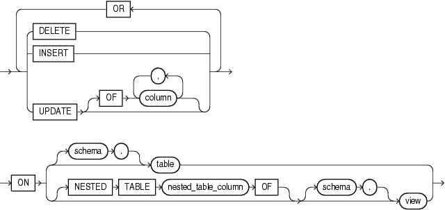

Creating an INSTEAD OF Trigger: ExampleThe DML_event_clause lets you specify one of three DML statements that can cause the trigger to fire. the database fires the trigger in the existing user transaction.
You cannot specify the MERGE keyword in the DML_event_clause. If you want a trigger to fire in relation to a MERGE operation, then you must create triggers on the INSERT and UPDATE operations to which the MERGE operation decomposes.
See Also:
Creating a DML Trigger: ExamplesDELETE Specify DELETE if you want the database to fire the trigger whenever a DELETE statement removes a row from the table or removes an element from a nested table.
INSERT Specify INSERT if you want the database to fire the trigger whenever an INSERT statement adds a row to a table or adds an element to a nested table.
UPDATE Specify UPDATE if you want the database to fire the trigger whenever an UPDATE statement changes a value in one of the columns specified after OF. If you omit OF, then the database fires the trigger whenever an UPDATE statement changes a value in any column of the table or nested table.
For an UPDATE trigger, you can specify object type, varray, and REF columns after OF to indicate that the trigger should be fired whenever an UPDATE statement changes a value in one of the columns. However, you cannot change the values of these columns in the body of the trigger itself.
Using OCI functions or theDBMS_LOB package to update LOB values or LOB attributes of object columns does not cause the database to fire triggers defined on the table containing the columns or the attributes.Restrictions on Triggers on UPDATE Operations The UPDATE clause is subject to the following restrictions:
You cannot specify UPDATE OF for an INSTEAD OF trigger. the database fires INSTEAD OF triggers whenever an UPDATE changes a value in any column of the view.
You cannot specify a nested table or LOB column in the UPDATE OF clause.
See Also:
AS subquery clause of CREATE VIEW in Oracle Database SQL Language Reference for a list of constructs that prevent inserts, updates, or deletes on a viewPerforming DML operations directly on nested table columns does not cause the database to fire triggers defined on the table containing the nested table column.
ON table | view  The ON clause lets you determine the database object on which the trigger is to be created. Specify the schema and table or view name of one of the following on which the trigger is to be created:

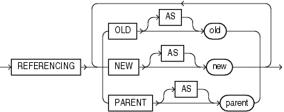

The referencing_clause lets you specify correlation names. You can use correlation names in the trigger body and WHEN condition of a row trigger to refer specifically to old and new values of the current row. The default correlation names are OLD and NEW. If your row trigger is associated with a table named OLD or NEW, then use this clause to specify different correlation names to avoid confusion between the table name and the correlation name.
If the trigger is defined on a nested table, then OLD and NEW refer to the row of the nested table, and PARENT refers to the current row of the parent table.
If the trigger is defined on an object table or view, then OLD and NEW refer to object instances.
Restriction on the referencing_clause The referencing_clause is not valid with INSTEAD OF triggers on CREATE DDL events.

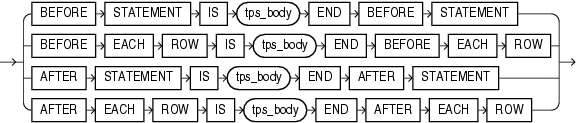

Use this clause to define a compound trigger on a DML event. The body of a COMPOUND trigger can have up to four sections, so that you can specify a before statement, before row, after row, or after statement operation in one trigger.
The dml_event_clause and the referencing_clause have the same semantics for compound DML triggers as for simple DML triggers.
Restriction on Compound Triggers You cannot specify the FOR EACH ROW clause for a compound trigger.
See Also:
Compound Trigger Restrictions for additional restrictionsUse this clause to define a single trigger on a DDL or database event.

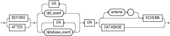

Specify one or more types of DDL statements that can cause the trigger to fire. You can create triggers for these events on DATABASE or SCHEMA unless otherwise noted. You can create BEFORE and AFTER triggers for these events. the database fires the trigger in the existing user transaction.
Restriction on Triggers on DDL Events You cannot specify as a triggering event any DDL operation performed through a PL/SQL procedure.
See Also:
Creating a DDL Trigger: ExampleThe following ddl_event values are valid:

Specify one or more particular states of the database that can cause the trigger to fire. You can create triggers for these events on DATABASE or SCHEMA unless otherwise noted. For each of these triggering events, the database opens an autonomous transaction scope, fires the trigger, and commits any separate transaction (regardless of any existing user transaction).
See Also:
Responding to Database Events Through Triggers for more information about responding to database events through triggers
Each database event is valid in either a BEFORE trigger or an AFTER trigger, but not both. The following database_event values are valid:

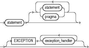

Specify the PL/SQL block, PL/SQL compound trigger block, or call procedure that the database executes to fire the trigger.
Timing point sections can be in any order, but no timing point section can be repeated. The declare_section of a compound trigger block cannot include PRAGMA AUTONOMOUS_TRANSACTION.

An INSERT statement that adds rows to the employees table
An UPDATE statement that changes values of the salary or job_id columns of the employees table
salary_check is a BEFORE row trigger, so the database fires it before changing each row that is updated by the UPDATE statement or before adding each row that is inserted by the INSERT statement.
salary_check has a trigger condition that prevents it from checking the salary of the administrative vice president (AD_VP).
Creating a DDL Trigger: Example  This example creates an AFTER statement trigger on any DDL statement CREATE. Such a trigger can be used to audit the creation of new data dictionary objects in your schema.
CREATE TRIGGER audit_db_object AFTER CREATE
   ON SCHEMA
      pl/sql_block
Calling a Procedure in a Trigger Body: Example You could create the salary_check trigger described in the preceding example by calling a procedure instead of providing the trigger body in a PL/SQL block. Assume you have defined a procedure check_sal in the hr schema, which verifies that an employee's salary is in an appropriate range. Then you could create the trigger salary_check as follows:
CREATE TRIGGER salary_check BEFORE INSERT OR UPDATE OF salary, job_id ON employees FOR EACH ROW WHEN (new.job_id <> 'AD_VP') CALL check_sal(:new.job_id, :new.salary, :new.last_name)
The procedure check_sal could be implemented in PL/SQL, C, or Java. Also, you can specify :OLD values in the CALL clause instead of :NEW values.
Creating a Database Event Trigger: Example This example shows the basic syntax for a trigger to log all errors. The hypothetical PL/SQL block does some special processing for a particular error (invalid logon, error number 1017). This trigger is an AFTER statement trigger, so it is fired after an unsuccessful statement execution, such as unsuccessful logon.
CREATE TRIGGER log_errors AFTER SERVERERROR ON DATABASE
   BEGIN
      IF (IS_SERVERERROR (1017)) THEN
         <special processing of logon error>
      ELSE
         <log error number>
      END IF;
   END;
