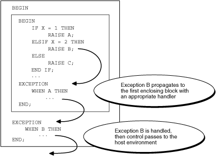

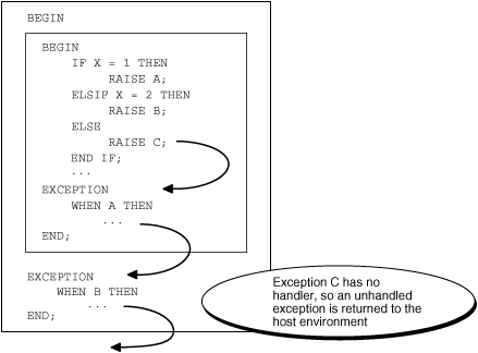

When an error occurs, an exception is raised. That is, normal execution stops and control transfers to the exception-handling part of your PL/SQL block or subprogram. Internal exceptions are raised implicitly (automatically) by the run-time system. User-defined exceptions must be raised explicitly by RAISE statements or invocations of the procedure DBMS_STANDARD.RAISE_APPLICATION_ERROR.
To handle raised exceptions, you write separate routines called exception handlers. After an exception handler runs, the current block stops executing and the enclosing block resumes with the next statement. If there is no enclosing block, control returns to the host environment. For information about managing errors when using BULK COLLECT, see Handling FORALL Exceptions (%BULK_EXCEPTIONS Attribute).

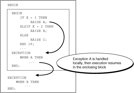

Exceptions declared in a block are considered local to that block and global to all its sub-blocks. Because a block can reference only local or global exceptions, enclosing blocks cannot reference exceptions declared in a sub-block.
If you redeclare a global exception in a sub-block, the local declaration prevails. The sub-block cannot reference the global exception, unless the exception is declared in a labeled block and you qualify its name with the block label block_label.exception_name.

The enclosing block does not handle the raised exception because the declaration of past_due in the sub-block prevails. Though they share the same name, the two past_due exceptions are different, just as the two acct_num variables share the same name but are different variables. Thus, the RAISE statement and the WHEN clause refer to different exceptions. To have the enclosing block handle the raised exception, you must remove its declaration from the sub-block or define an OTHERS handler.

Figure 11-1, Figure 11-2, and Figure 11-3 illustrate the basic propagation rules.
