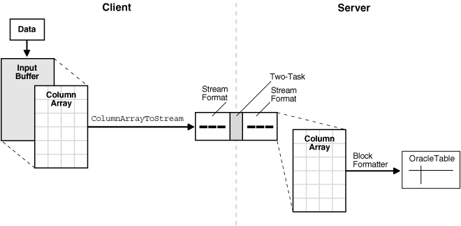

The direct path load interface enables an OCI application to access the direct path load engine of the Oracle database server to perform the functions of the Oracle SQL*Loader utility. This functionality provides the ability to load data from external files into either a table or a partition of a partitioned table.
Figure 13-1, "Direct Path Loading" introduces the subject of this chapter:
The OCI direct path load interface has the ability to load multiple rows by loading a direct path stream that contains data for multiple rows.
To use the direct path API, the client application performs the following steps:

These handles are used to present an array of rows to the direct path interface. A row is represented by three arrays: column values, column lengths, and column flags. Methods used on a column array include: allocate the array handle and set or get values corresponding to an array entry.
Both handles share the same data structure, OCIDirPathColArray. But these column array handles differ in parent handles and handle types.
A direct path column array handle is allocated with OCIHandleAlloc(). The following code fragment shows explicit allocation of the direct path column array handle:

This handle is used by the conversion operation, OCIDirPathColArrayToStream(), and by the load operation, OCIDirPathLoadStream().
Direct path stream handles is allocated by the client with OCIHandleAlloc(). The structure of a OCIDirPathStream handle can be thought of as a pair in the form (buffer, buffer length).
A direct path stream is a linear representation of Oracle table data. The conversion operations always append to the end of the stream. Load operations always start from the beginning of the stream. After a stream is completely loaded, the stream must be reset by calling OCIDirPathStreamReset().

The following sample code illustrates the use of several of the OCI direct path interfaces. It is not a complete code example.
The init_load function performs a direct path load using the direct path API on the table described by tblp. The loadctl structure given by ctlp has an appropriately initialized environment and service context. A connection has been made to the server.
STATICF void
init_load(ctlp, tblp)
struct loadctl *ctlp;
struct tbl     *tblp;
  struct  col   *colp;
  struct  fld   *fldp;
  sword          ociret;                       /* return code from OCI calls */
  OCIDirPathCtx *dpctx;                               /* direct path context */
  OCIParam      *colDesc;                     /* column parameter descriptor */
  ub1            parmtyp;
  ub1           *timestamp = (ub1 *)0;
  ub4            size;
  ub4            i;
  ub4            pos;
  /* allocate and initialize a direct path context */
  /* See cdemodp.c for the definition of OCI_CHECK */
  OCI_CHECK(ctlp->envhp_ctl, OCI_HTYPE_ENV, ociret, ctlp,
            OCIHandleAlloc((void  *)ctlp->envhp_ctl,
                           (void  **)&ctlp->dpctx_ctl,
                           (ub4)OCI_HTYPE_DIRPATH_CTX,
                           (size_t)0, (void  **)0));
  dpctx = ctlp->dpctx_ctl;                                      /* shorthand */
  OCI_CHECK(ctlp->errhp_ctl, OCI_HTYPE_ERROR, ociret, ctlp,
            OCIAttrSet((void  *)dpctx, (ub4)OCI_HTYPE_DIRPATH_CTX,
                       (void  *)tblp->name_tbl,
                       (ub4)strlen((const char *)tblp->name_tbl),
                       (ub4)OCI_ATTR_NAME, ctlp->errhp_ctl));
Additional attributes, such as OCI_ATTR_SUB_NAME and OCI_ATTR_SCHEMA_NAME, are also set here. After the attributes have been set, prepare the load.
            OCIDirPathPrepare(dpctx, ctlp->svchp_ctl, ctlp->errhp_ctl));
Note that the direct path context handle is the parent handle for the column array and stream handles. Also note that errors are returned with the environment handle associated with the direct path context.
            OCIHandleAlloc((void  *)ctlp->dpctx_ctl, (void  **)&ctlp->dpca_ctl,
                           (ub4)OCI_HTYPE_DIRPATH_COLUMN_ARRAY,
            OCIHandleAlloc((void  *)ctlp->dpctx_ctl,(void  **)&ctlp->dpstr_ctl,
                           (ub4)OCI_HTYPE_DIRPATH_STREAM,
Get number of rows and columns in the column array just allocated.
            OCIAttrGet(ctlp->dpca_ctl, (ub4)OCI_HTYPE_DIRPATH_COLUMN_ARRAY,
                       &ctlp->nrow_ctl, 0, OCI_ATTR_NUM_ROWS,
                       ctlp->errhp_ctl));
                       &ctlp->ncol_ctl, 0, OCI_ATTR_NUM_COLS,
                       ctlp->errhp_ctl));
Set the input data fields to their corresponding data columns.
ub4            rowoff;                          /* column array row offset */
ub4            clen;                                      /* column length */
ub1            cflg;                                  /* column state flag */
ub1           *cval;                             /* column character value */
            OCIDirPathColArrayEntrySet(ctlp->dpca_ctl, ctlp->errhp_ctl,
                                       rowoff, colp->id_col,
                                       cval, clen, cflg));
Reset column array state in case a previous conversion needed to be continued or a row is expecting more data.
(void) OCIDirPathColArrayReset(ctlp->dpca_ctl, ctlp->errhp_ctl);
Reset the stream state to start a new stream. Otherwise, data in the stream is appended to existing data.
(void) OCIDirPathStreamReset(ctlp->dpstr_ctl, ctlp->errhp_ctl);
After inputting the data, convert the data in the column array to stream format and filter out any bad records.
ub4            rowcnt;                   /* number of rows in column array */
ub4            startoff;         /* starting row offset into column array  */
/* convert array to stream, filter out bad records */
ocierr = OCIDirPathColArrayToStream(ctlp->dpca_ctl, ctlp->dpctx_ctl,
                                        ctlp->dpstr_ctl, ctlp->errhp_ctl,
                                        rowcnt, startoff);
Note that the position in the stream is maintained internally to the stream handle, along with offset information for the column array which produced the stream. When the conversion to stream format is done, the data is appended to the stream. It is the responsibility of the caller to reset the stream when appropriate. On errors, the position is moved to the next row, or the end of the stream if the error occurs on the last row. The next OCIDirPathLoadStream() call starts on the next row, if any. If a OCIDirPathLoadStream() call is made, and the end of a stream has been reached, OCI_NO_DATA is returned.
/* load the stream */
ociret = OCIDirPathLoadStream(ctlp->dpctx_ctl, ctlp->dpstr_ctl,
            ctlp->errhp_ctl);
/* free up server data structures for the load */
          OCIDirPathFinish(ctlp->dpctx_ctl, ctlp->errhp_ctl));
Free all the direct path handles allocated. Note that direct path column array and stream handles are freed before the parent direct path context handle is freed.
ociret = OCIHandleFree((void  *)ctlp->dpca_ctl,
                           OCI_HTYPE_DIRPATH_COLUMN_ARRAY);
ociret = OCIHandleFree((void  *)ctlp->dpstr_ctl,
                           OCI_HTYPE_DIRPATH_STREAM);
ociret = OCIHandleFree((void  *)ctlp->dpctx_ctl,
                          OCI_HTYPE_DIRPATH_CTX);
