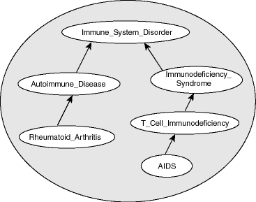

Figure 2-1 shows part of a cancer ontology, which describes the classes and properties related to cancer. One requirement is to have a PATIENTS data table with a column named DIAGNOSIS, which must contain a value from the Diseases_and_Disorders class hierarchy.
In the cancer ontology shown in Figure 2-1, the diagnosis Immune_System_Disorder includes two subclasses, Autoimmune_Disease and Immunodeficiency_Syndrome. The Autoimmune_Disease diagnosis includes the subclass Rheumatoid_Arthritis; and the Immunodeficiency_Syndrome diagnosis includes the subclass T_Cell_Immunodeficiency, which includes the subclass AIDS.
The data in the PATIENTS table might include the PATIENT_ID and DIAGNOSIS column values shown in Table 2-1.
Table 2-1 PATIENTS Table Example Data
| PATIENT_ID | DIAGNOSIS |
| 1234 | Rheumatoid_Arthritis |
| 2345 | Immunodeficiency_Syndrome |
| 3456 | AIDS |

Referring to the cancer ontology example in Section 2.1.1, consider the following query that requires semantic matching: Find all patients whose diagnosis is of the type 'Immune_System_Disorder'. A typical database query of the PATIENTS table (described in Section 2.1.1) involving syntactic match will not return any rows, because no rows have a DIAGNOSIS column containing the exact value Immune_System_Disorder. For example the following query will not return any rows:
SELECT diagnosis FROM patients WHERE diagnosis = 'Immune_System_Disorder';
However, many rows in the patient data table are relevant, because their diagnoses fall under this class. Example 2-7 uses the SEM_RELATED operator (instead of lexical equality) to retrieve all the relevant rows from the patient data table. (In this example, the term Immune_System_Disorder is prefixed with a namespace, and the default assumption is that the values in the table column also have a namespace prefix. However, that might not always be the case, as explained in Section 2.3.5.)

Distances are generated for the following properties during inference (entailment): OWL properties defined as transitive properties, and RDFS subClassOf and RDFS subPropertyOf properties. The distance between two terms linked through these properties is computed as the shortest distance between them in a hierarchical class structure. Distances of two terms linked through other properties are undefined and therefore set to null.
Each transitive property link in the original model (viewed as a hierarchical class structure) has a distance of 1, and the distance of an inferred triple is generated according to the number of links between the two terms. Consider the following hypothetical sample scenarios:
If the original graph contains C1 rdfs:subClassOf C2 and C2 rdfs:subClassOf C3, then C1 rdfs:subClassof of C3 will be derived. In this case:
C1 rdfs:subClassOf C2: distance = 1, because it exists in the model.
C2 rdfs:subClassOf C3: distance = 1, because it exists in the model.
C1 rdfs:subClassOf C3: distance = 2, because it is generated during inference.
If the original graph contains P1 rdfs:subPropertyOf P2 and P2 rdfs:subPropertyOf P3, then P1 rdfs:subPropertyOf P3 will be derived. In this case:
P1 rdfs:subPropertyOf P2: distance = 1, because it exists in the model.
P2 rdfs:subPropertyOf P3: distance = 1, because it exists in the model.
P1 rdfs:subPropertyOf P3: distance = 2, because it is generated during inference.
If the original graph contains C1 owl:equivalentClass C2 and C2 owl:equivalentClass C3, then C1 owl:equivalentClass C3 will be derived. In this case:
C1 owl:equivalentClass C2: distance = 1, because it exists in the model.
C2 owl:equivalentClass C3: distance = 1, because it exists in the model.
C1 owl:equivalentClass C3: distance = 2, because it is generated during inference.
