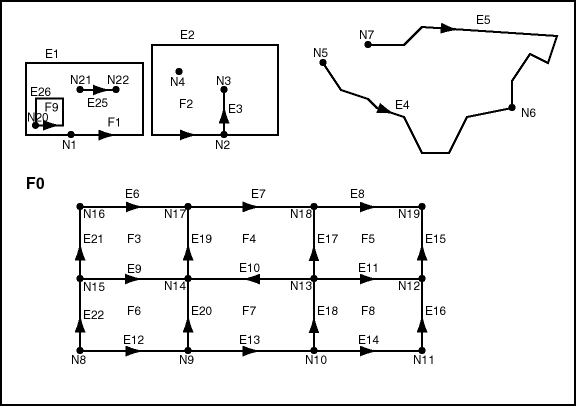

Topology is a branch of mathematics concerned with objects in space. Topological relationships include such relationships as contains, inside, covers, covered by, touch, and overlap with boundaries intersecting. Topological relationships remain constant when the coordinate space is deformed, such as by twisting or stretching. (Examples of relationships that are not topological include length of, distance between, and area of.)
The basic elements in a topology are its nodes, edges, and faces.
A node, represented by a point, can be isolated or it can be used to bound edges. Two or more edges meet at a non-isolated node. A node has a coordinate pair associated with it that describes the spatial location for that node. Examples of geographic entities that might be represented as nodes include start and end points of streets, places of historical interest, and airports (if the map scale is sufficiently large).
An edge is bounded by two nodes: the start (origin) node and the end (terminal) node. An edge has an associated geometric object, usually a coordinate string that describes the spatial representation of the edge. An edge may have several vertices making up a line string. (Circular arcs are not supported for topologies.) Examples of geographic entities that might be represented as edges include segments of streets and rivers.
The order of the coordinates gives a direction to an edge, and direction is important in determining topological relationships. The positive direction agrees with the orientation of the underlying edge, and the negative direction reverses this orientation. Each orientation of an edge is referred to as a directed edge, and each directed edge is the mirror image of its other directed edge. The start node of the positive directed edge is the end node of the negative directed edge. An edge also lies between two faces and has references to both of them. Each directed edge contains a reference to the next edge in the contiguous perimeter of the face on its left side.A face, corresponding to a polygon, has a reference to one directed edge of its outer boundary. If any island nodes or island edges are present, the face also has a reference to one directed edge on the boundary of each island. Examples of geographic entities that might be represented as faces include parks, lakes, counties, and states.
Figure 1-1 shows a simplified topology containing nodes, edges, and faces. The arrowheads on each edge indicate the positive direction of the edge (or, more precisely, the orientation of the underlying line string or curve geometry for positive direction of the edge).
Notes on Figure 1-1:
E elements (E1, E2, and so on) are edges, F elements (F0, F1, and so on) are faces, and N elements (N1, N2, and so on) are nodes.
F0 (face zero) is created for every topology. It is the universe face containing everything else in the topology. There is no geometry associated with the universe face. F0 has the face ID value of -1 (negative 1).
There is a node created for every point geometry and for every start and end node of an edge. For example, face F1 has only an edge (a closed edge), E1, that has the same node as the start and end nodes (N1). F1 also has edge E25, with start node N21 and end node N22.
An isolated node (also called an island node) is a node that is isolated in a face. For example, node N4 is an isolated node in face F2.
An isolated edge (also called an island edge) is an edge that is isolated in a face. For example, edge E25 is an isolated edge in face F1.
A loop edge is an edge that has the same node as its start node and end node. For example, edge E1 is a loop edge starting and ending at node N1.
An edge cannot have an isolated (island) node on it. The edge can be broken up into two edges by adding a node on the edge. For example, if there was originally a single edge between nodes N16 and N18, adding node N17 resulted in two edges: E6 and E7.

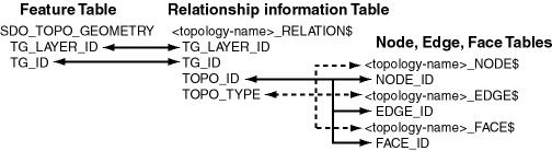

Information about the topological relationships is stored in special edge, face, and node information tables. For example, the edge information table contains the following information about edges E9 and E10. (Note the direction of the arrowheads for each edge.) The next and previous edges are based on the left and right faces of the edge.
For edge E9, the start node is N15 and the end node is N14, the next left edge is E19 and the previous left edge is -E21, the next right edge is -E22 and the previous right edge is E20, the left face is F3 and the right face is F6.
For edge E10, the start node is N13 and the end node is N14, the next left edge is -E20 and the previous left edge is E18, the next right edge is E17 and the previous right edge is -E19, the left face is F7 and the right face is F4.
For additional examples of edge-related data, including an illustration and explanations, see Section 1.5.1.

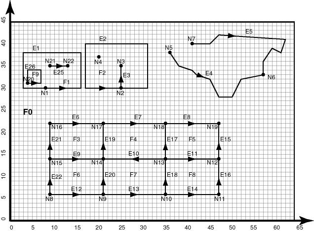

Figure 1-2 shows the same topology illustrated in Figure 1-1, but it adds a grid and unit numbers along the x-axis and y-axis. Figure 1-2 is useful for understanding the output of some of the examples in Chapter 3 and Chapter 4.
Figure 1-2 Simplified Topology, with Grid Lines and Unit Numbers

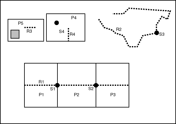

Often, there are fewer features in a topology than there are topological elements (nodes, edges, and faces). For example, a road feature may consist of many edges, an area feature such as a park may consist of many faces, and some nodes may not be associated with point features. Figure 1-3 shows point, line, and area features associated with the topology that was shown in Figure 1-1 in Section 1.2.
Figure 1-3 shows the following kinds of features in the topology:
Point features (traffic signs), shown as dark circles: S1, S2, S3, and S4
Linear features (roads or streets), shown as dashed lines: R1, R2, R3, and R4
Area features (land parcels), shown as rectangles: P1, P2, P3, P4, and P5
Land parcel P5 does not include the shaded area within its area. (Specifically, P5 includes face F1 but not face F9. These faces are shown in Figure 1-1 in Section 1.2.)
Example 1-12 in Section 1.12.1 defines these features.

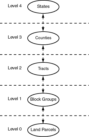

In some topologies, the topology geometry layers (feature layers) have one or more parent-child relationships in a topology hierarchy. That is, the layer at the topmost level consists of features in its child layer at the next level down in the hierarchy; the child layer might consist of features in its child layer at the next layer farther down; and so on. For example, a land use topology might have the following topology geometry layers at different levels of hierarchy:
States at the highest level, which consists of features from its child layer, Counties
Counties at the next level down, which consists of features from its child layer, Tracts
Tracts at the next level down, which consists of features from its child layer, Block Groups
Block Groups at the next level down, which consists of features from its child layer, Land Parcels
Land Parcels at the lowest level of the hierarchy
If the topology geometry layers in a topology have this hierarchical relationship, it is far more efficient if you model the layers as hierarchical than if you specify all topology geometry layers at a single level (that is, with no hierarchy). For example, it is more efficient to construct SDO_TOPO_GEOMETRY objects for counties by specifying only the tracts in the county than by specifying all land parcels in all block groups in all tracts in the county.
The lowest level (for the topology geometry layer containing the smallest kinds of features) in a hierarchy is level 0, and successive higher levels are numbered 1, 2, and so on. Topology geometry layers at adjacent levels of a hierarchy have a parent-child relationship. Each topology geometry layer at the higher level is the parent layer for one layer at the lower level, which is its child layer. A parent layer can have only one child layer, but a child layer can have one or more parent layers. Using the preceding example, the Counties layer can have only one child layer, Tracts; however, the Tracts layer could have parent layers named Counties and Water Districts.
Note: Topology geometry layer hierarchy is somewhat similar to network hierarchy, which is described in Section 5.5; however, there are significant differences, and you should not confuse the two. For example, the lowest topology geometry layer hierarchy level is 0, and the lowest network hierarchy level is 1; and in a topology geometry layer hierarchy each parent must have one child and each child can have many parents, while in a network hierarchy each parent can have many children and each child must have one parent. |
Figure 1-4 shows the preceding example topology geometry layer hierarchy. Each level of the hierarchy shows the level number and the topology geometry layer in that level.
Figure 1-4 Topology Geometry Layer Hierarchy
To model topology geometry layers as hierarchical, specify the child layer in the child_layer_id parameter when you call the SDO_TOPO.ADD_TOPO_GEOMETRY_LAYER procedure to add a parent topology geometry layer to the topology. Add the lowest-level (level 0) topology geometry layer first; then add the level 1 layer, specifying the level 0 layer as its child; then add the level 2 layer, specifying the level 1 layer as its child; and so on. Example 1-2 shows five topology geometry layers being added so that the 5-level hierarchy is established.

Within each level above level 0, each layer can contain features built from features at the next lower level (as is done in Example 1-2), features built from topological elements (faces, nodes, edges), or a combination of these. For example, a tracts layer can contain tracts built from block groups or tracts built from faces, or both. However, each feature within the layer must be built only either from features from the next lower level or from topological elements. For example, a specific tract can consist of block groups or it can consist of faces, but it cannot consist of a combination of block groups and faces.
To insert or update topology geometry objects in feature tables for the levels in a hierarchy, use the appropriate forms of the SDO_TOPO_GEOMETRY constructor. Feature tables are described in Section 1.3, and SDO_TOPO_GEOMETRY constructors are described in Section 1.6.2.
Note: The TOPO_ID and TOPO_TYPE attributes in the relationship information table have special meanings when applied to parent layers in a topology with a topology geometry layer hierarchy. See the explanations of these attributes in Table 1-5 in Section 1.5.4. |

Spatial automatically maintains a relationship information (<topology-name>_RELATION$) table for each topology, which is created the first time that a feature table is associated with a topology (that is, at the first call to the SDO_TOPO.ADD_TOPO_GEOMETRY_LAYER procedure that specifies the topology). The relationship information table is described in Section 1.5.4.
Figure 1-5 shows the role of the relationship information table in connecting information in a feature table with information in its associated node, edge, or face table.
Figure 1-5 Mapping Between Feature Tables and Topology Tables
As shown in Figure 1-5, the mapping between feature tables and the topology node, edge, and face tables occurs through the <topology-name>_RELATION$ table. In particular:
Each feature table includes a column of type SDO_TOPO_GEOMETRY. This type includes a TG_LAYER_ID attribute (the unique ID assigned by Oracle Spatial when the layer is created), as well as a TG_ID attribute (the unique ID assigned to each feature in a layer). The values in these two columns have corresponding values in the TG_LAYER_ID and TG_ID columns in the <topology-name>_RELATION$ table.
Each feature has one or more rows in the <topology-name>_RELATION$ table.
Given the TG_LAYER_ID and TG_ID values for a feature, the set of nodes, faces, and edges associated with the feature can be determined by matching the TOPO_ID value (the node, edge, or face ID) in the <topology-name>_RELATION$ table with the corresponding ID value in the <topology-name>_NODE$, <topology-name>_EDGE$, or <topology-name>_FACE$ table.

The NEXT_LEFT_EDGE_ID and NEXT_RIGHT_EDGE_ID values refer to the next directed edges in the counterclockwise delineation of the perimeters of the left and right faces, respectively. The PREV_LEFT_EDGE_ID and PREV_RIGHT_EDGE_ID values refer to the previous directed edges in the counterclockwise delineation of the perimeters of the left and right faces, respectively. The LEFT_FACE_ID value refers to the face to the left of the positive directed edge, and the RIGHT_FACE_ID value refers to the face to the left of the negative directed edge. For any numeric ID value, the sign indicates which orientation of the target edge is being referred to.
Figure 1-6 shows nodes, edges, and faces that illustrate the relationships among the various ID columns in the edge information table. (In Figure 1-6, thick lines show the edges, and thin lines with arrowheads show the direction of each edge.)
Table 1-2 shows the ID column values in the edge information table for edges E4 and E8 in Figure 1-6. (For clarity, Table 1-2 shows ID column values with alphabetical characters, such as E4 and N1; however, the ID columns actually contain numeric values only, specifically the numeric ID value associated with each named object.)
Table 1-2 Edge Table ID Column Values
| EDGE_ID | START_NODE_ID | END_NODE_ID | NEXT_LEFT_EDGE_ID | PREV_LEFT_EDGE_ID | NEXT_RIGHT_EDGE_ID | PREV_RIGHT_EDGE_ID | LEFT_FACE_ID | RIGHT_FACE_ID |
E4 |
N1 |
N2 |
-E5 |
E3 |
E2 |
-E6 |
F1 |
F2 |
E8 |
N4 |
N3 |
-E8 |
-E8 |
E8 |
E8 |
F2 |
F2 |
In Figure 1-6 and Table 1-2:
The start node and end node for edge E4 are N1 and N2, respectively. The next left edge for edge E4 is E5, but its direction is the opposite of edge E4, and therefore the next left edge for E4 is stored as -E5 (negative E5).
The previous left edge for edge E4 is E3, and because it has the same direction as edge E4, the previous left edge for E4 is stored as E3.
The next right face is determined using the negative directed edge of E4. This can be viewed as reversing the edge direction and taking the next left edge and previous left edge. In this case, the next right edge is E2 and the previous right edge is -E6 (the direction of edge E6 is opposite the negative direction of edge E4). For edge E4, the left face is F1 and the right face is F2.
Edges E1 and E7 are neither leftmost nor rightmost edges with respect to edge E4, and therefore they do not appear in the edge table row associated with edge E4.

There are two sets of topology metadata views for each schema (user): xxx_SDO_TOPO_INFO and xxx_SDO_TOPO_METADATA, where xxx can be USER or ALL. These views are read-only to users; they are created and maintained by Spatial.
The xxx_SDO_TOPO_METADATA views contain the most detailed information, and each xxx_SDO_TOPO_INFO view contains a subset of the information in its corresponding xxx_SDO_TOPO_METADATA view.
The following views contain basic information about topologies:
USER_SDO_TOPO_INFO contains topology information for all feature tables owned by the user.

The following views contain detailed information about topologies:
USER_SDO_TOPO_METADATA contains topology information for all tables owned by the user.
ALL_SDO_TOPO_METADATA contains topology information for all tables on which the user has SELECT permission.
The USER_SDO_TOPO_METADATA and ALL_SDO_TOPO_METADATA views contain the same columns, as shown Table 1-9. (The columns are listed in their order in the view definition.)

When you use spatial operators with topologies, the formats of the first two parameters can be any one of the following:
Two topology geometry objects (type SDO_TOPO_GEOMETRY)
For example, the following statement finds all city streets features that have any interaction with a land parcel feature named P3. (This example uses definitions and data from Section 1.12.1.)
SELECT c.feature_name FROM city_streets c, land_parcels l
WHERE l.feature_name = 'P3' AND
SDO_ANYINTERACT (c.feature, l.feature) = 'TRUE';
FEATURE_NAME
R1
A topology geometry object (type SDO_TOPO_GEOMETRY) as the first parameter and a spatial geometry (type SDO_GEOMETRY) as the second parameter
For example, the following statement finds all city streets features that have any interaction with a geometry object that happens to be a polygon identical to the boundary of the land parcel feature named P3. (This example uses definitions and data from Section 1.12.2.)
WHERE SDO_ANYINTERACT (c.feature,
SDO_GEOMETRY(2003, NULL, NULL, SDO_ELEM_INFO_ARRAY(1,1003,1),
SDO_ORDINATE_ARRAY(35,6, 47,6, 47,14, 47,22, 35,22, 35,14, 35,6))) = 'TRUE';
FEATURE_NAME
R1
A topology geometry object (type SDO_TOPO_GEOMETRY) as the first parameter and a topology object array object (type SDO_TOPO_OBJECT_ARRAY) as the second parameter
For example, the following statement finds all city streets features that have any interaction with an SDO_TOPO_OBJECT_ARRAY object that happens to be identical to the land parcel feature named P3. (This example uses definitions and data from Section 1.12.2.)
SELECT c.feature_name FROM city_streets c WHERE SDO_ANYINTERACT (c.feature, SDO_TOPO_OBJECT_ARRAY (SDO_TOPO_OBJECT (5, 3), SDO_TOPO_OBJECT (8, 3))) = 'TRUE'; FEATURE_NAME ------------------------------ R1

This section presents simplified PL/SQL examples that perform topology data model operations. The examples refer to concepts that are explained in this chapter. They use SDO_TOPO and SDO_TOPO_MAP functions and procedures, which are documented in Chapter 3 and Chapter 4, and the SDO_ANYINTERACT topology operator (see Section 1.8.1).
Both examples are based on the "city data" topology shown in Figure 1-1 in Section 1.2, and the features shown in Figure 1-3 in Section 1.3.1. However, the topologies created are not identical, because the topology built from Spatial geometries (Example 1-13) does not contain all the edges, nodes, and faces that are defined for the topology build from topology data (Example 1-12).
Example 1-12 uses a topology built from edge, node, and face data.

-- 1. Create the topology. (Null SRID in this example.)
EXECUTE SDO_TOPO.CREATE_TOPOLOGY('CITY_DATA', 0.00005);
-- 2. Load topology data (node, edge, and face tables).
-- Use INSERT statements here instead of a bulk-load utility.
-- 2A. Insert data into <topology_name>_EDGE$ table.
-- E1
INSERT INTO city_data_edge$ (edge_id, start_node_id, end_node_id,
next_left_edge_id, prev_left_edge_id, next_right_edge_id,
prev_right_edge_id, left_face_id, right_face_id, geometry)
VALUES(1, 1, 1, 1, 1, -1, -1, 1, -1,
SDO_GEOMETRY(2002, NULL, NULL, SDO_ELEM_INFO_ARRAY(1, 2, 1),
SDO_ORDINATE_ARRAY(8,30, 16,30, 16,38, 3,38, 3,30, 8,30)));
-- E2
VALUES(2, 2, 2, 3, -3, -2, -2, 2, -1,
SDO_ORDINATE_ARRAY(25,30, 31,30, 31,40, 17,40, 17,30, 25,30)));
-- E3
VALUES(3, 2, 3, -3, 2, 2, 3, 2, 2,
SDO_ORDINATE_ARRAY(25,30, 25,35)));
-- E4
VALUES(4, 5, 6, -5, -4, 4, 5, -1, -1,
SDO_ORDINATE_ARRAY(36,38, 38,35, 41,34, 42,33, 45,32, 47,28, 50,28, 52,32,
57,33)));
-- E5
VALUES(5, 7, 6, -4, -5, 5, 4, -1, -1,
SDO_ORDINATE_ARRAY(41,40, 45,40, 47,42, 62,41, 61,38, 59,39, 57,36,
57,33)));
-- E6
VALUES(6, 16, 17, 7, 21, -21, 19, -1, 3,
SDO_ORDINATE_ARRAY(9,22, 21,22)));
-- E7
VALUES(7, 17, 18, 8, 6, -19, 17, -1, 4,
SDO_ORDINATE_ARRAY(21,22, 35,22)));
-- E8
VALUES(8, 18, 19, -15, 7, -17, 15, -1, 5,
SDO_ORDINATE_ARRAY(35,22, 47,22)));
-- E9
VALUES(9, 15, 14, 19, -21, -22, 20, 3, 6,
SDO_ORDINATE_ARRAY(9,14, 21,14)));
-- E10
VALUES(10, 13, 14, -20, 18, 17, -19, 7, 4,
SDO_ORDINATE_ARRAY(35,14, 21,14)));
-- E11
VALUES(11, 13, 12, 15, -17, -18, 16, 5, 8,
SDO_ORDINATE_ARRAY(35,14, 47,14)));
-- E12
VALUES(12, 8, 9, 20, -22, 22, -13, 6, -1,
SDO_ORDINATE_ARRAY(9,6, 21,6)));
-- E13
VALUES(13, 9, 10, 18, -20, -12, -14, 7, -1,
SDO_ORDINATE_ARRAY(21,6, 35,6)));
-- E14
VALUES(14, 10, 11, 16, -18, -13, -16, 8, -1,
SDO_ORDINATE_ARRAY(35,6, 47,6)));
-- E15
VALUES(15, 12, 19, -8, 11, -16, 8, 5, -1,
SDO_ORDINATE_ARRAY(47,14, 47,22)));
-- E16
VALUES(16, 11, 12, -11, 14, -14, -15, 8, -1,
SDO_ORDINATE_ARRAY(47,6, 47,14)));
-- E17
VALUES(17, 13, 18, -7, -10, 11, -8, 4, 5,
SDO_ORDINATE_ARRAY(35,14, 35,22)));
-- E18
VALUES(18, 10, 13, 10, 13, 14, -11, 7, 8,
SDO_ORDINATE_ARRAY(35,6, 35,14)));
-- E19
VALUES(19, 14, 17, -6, 9, -10, -7, 3, 4,
SDO_ORDINATE_ARRAY(21,14, 21,22)));
-- E20
VALUES(20, 9, 14, -9, 12, 13, 10, 6, 7,
SDO_ORDINATE_ARRAY(21,6, 21,14)));
-- E21
VALUES(21, 15, 16, 6, 22, 9, -6, -1, 3,
SDO_ORDINATE_ARRAY(9,14, 9,22)));
-- E22
VALUES(22, 8, 15, 21, -12, 12, -9, -1, 6,
SDO_ORDINATE_ARRAY(9,6, 9,14)));
-- E25
VALUES(25, 21, 22, -25, -25, 25, 25, 1, 1,
SDO_ORDINATE_ARRAY(9,35, 13,35)));
-- E26
VALUES(26, 20, 20, 26, 26, -26, -26, 9, 1,
SDO_ORDINATE_ARRAY(4,31, 7,31, 7,34, 4,34, 4,31)));

-- 2C. Insert data into <topology_name>_FACE$ table.
-- F0 (id = -1, not 0)
INSERT INTO city_data_face$ (face_id, boundary_edge_id,
island_edge_id_list, island_node_id_list, mbr_geometry)
VALUES(-1, NULL, SDO_LIST_TYPE(-1, -2, 4, 6),
SDO_LIST_TYPE(), NULL);
-- F1
VALUES(1, 1, SDO_LIST_TYPE(25, -26), SDO_LIST_TYPE(),
SDO_GEOMETRY(2003, NULL, NULL, SDO_ELEM_INFO_ARRAY(1,1003,3),
SDO_ORDINATE_ARRAY(3,30, 15,38)));
-- F2
VALUES(2, 2, SDO_LIST_TYPE(), SDO_LIST_TYPE(4),
SDO_ORDINATE_ARRAY(17,30, 31,40)));
-- F3
VALUES(3, 19, SDO_LIST_TYPE(), SDO_LIST_TYPE(),
SDO_ORDINATE_ARRAY(9,14, 21,22)));
-- F4
VALUES(4, 17, SDO_LIST_TYPE(), SDO_LIST_TYPE(),
SDO_ORDINATE_ARRAY(21,14, 35,22)));
-- F5
VALUES(5, 15, SDO_LIST_TYPE(), SDO_LIST_TYPE(),
SDO_ORDINATE_ARRAY(35,14, 47,22)));
-- F6
VALUES(6, 20, SDO_LIST_TYPE(), SDO_LIST_TYPE(),
SDO_ORDINATE_ARRAY(9,6, 21,14)));
-- F7
VALUES(7, 10, SDO_LIST_TYPE(), SDO_LIST_TYPE(),
SDO_ORDINATE_ARRAY(21,6, 35,14)));
-- F8
VALUES(8, 16, SDO_LIST_TYPE(), SDO_LIST_TYPE(),
SDO_ORDINATE_ARRAY(35,6, 47,14)));
-- F9
VALUES(9,26,SDO_LIST_TYPE(), SDO_LIST_TYPE(),
SDO_ORDINATE_ARRAY(4,31, 7,34)));

-- 6. Load feature tables using the SDO_TOPO_GEOMETRY constructor.
-- Each topology feature can consist of one or more objects (face, edge, node)
-- of an appropriate type. For example, a land parcel can consist of one face,
-- or two or more faces, as specified in the SDO_TOPO_OBJECT_ARRAY.
-- There are typically fewer features than there are faces, nodes, and edges.
-- In this example, the only features are these:
-- Area features (land parcels): P1, P2, P3, P4, P5
-- Point features (traffic signs): S1, S2, S3, S4
-- Linear features (roads/streets): R1, R2, R3, R4
-- 6A. Load LAND_PARCELS table.
-- P1
INSERT INTO land_parcels VALUES ('P1', -- Feature name
SDO_TOPO_GEOMETRY(
'CITY_DATA', -- Topology name
3, -- Topology geometry type (polygon/multipolygon)
1, -- TG_LAYER_ID for this topology (from ALL_SDO_TOPO_METADATA)
SDO_TOPO_OBJECT (3, 3), -- face_id = 3
SDO_TOPO_OBJECT (6, 3))) -- face_id = 6
-- P2
INSERT INTO land_parcels VALUES ('P2', -- Feature name
SDO_TOPO_GEOMETRY(
SDO_TOPO_OBJECT (4, 3), -- face_id = 4
SDO_TOPO_OBJECT (7, 3))) -- face_id = 7
-- P3
INSERT INTO land_parcels VALUES ('P3', -- Feature name
SDO_TOPO_GEOMETRY(
SDO_TOPO_OBJECT (5, 3), -- face_id = 5
SDO_TOPO_OBJECT (8, 3))) -- face_id = 8
-- P4
INSERT INTO land_parcels VALUES ('P4', -- Feature name
SDO_TOPO_GEOMETRY(
SDO_TOPO_OBJECT (2, 3))) -- face_id = 2
-- P5 (Includes F1, but not F9.)
INSERT INTO land_parcels VALUES ('P5', -- Feature name
SDO_TOPO_GEOMETRY(
SDO_TOPO_OBJECT (1, 3))) -- face_id = 1
-- 6B. Load TRAFFIC_SIGNS table.
-- S1
INSERT INTO traffic_signs VALUES ('S1', -- Feature name
SDO_TOPO_GEOMETRY(
1, -- Topology geometry type (point)
2, -- TG_LAYER_ID for this topology (from ALL_SDO_TOPO_METADATA)
SDO_TOPO_OBJECT (14, 1))) -- node_id = 14
-- S2
INSERT INTO traffic_signs VALUES ('S2', -- Feature name
SDO_TOPO_GEOMETRY(
SDO_TOPO_OBJECT (13, 1))) -- node_id = 13
-- S3
INSERT INTO traffic_signs VALUES ('S3', -- Feature name
SDO_TOPO_GEOMETRY(
SDO_TOPO_OBJECT (6, 1))) -- node_id = 6
-- S4
INSERT INTO traffic_signs VALUES ('S4', -- Feature name
SDO_TOPO_GEOMETRY(
SDO_TOPO_OBJECT (4, 1))) -- node_id = 4
-- 6C. Load CITY_STREETS table.
-- (Note: "R" in feature names is for "Road", because "S" is used for signs.)
-- R1
INSERT INTO city_streets VALUES ('R1', -- Feature name
SDO_TOPO_GEOMETRY(
2, -- Topology geometry type (line string)
3, -- TG_LAYER_ID for this topology (from ALL_SDO_TOPO_METADATA)
SDO_TOPO_OBJECT (9, 2),
SDO_TOPO_OBJECT (-10, 2),
SDO_TOPO_OBJECT (11, 2))) -- edge_ids = 9, -10, 11
-- R2
INSERT INTO city_streets VALUES ('R2', -- Feature name
SDO_TOPO_GEOMETRY(
SDO_TOPO_OBJECT (4, 2),
SDO_TOPO_OBJECT (-5, 2))) -- edge_ids = 4, -5
-- R3
INSERT INTO city_streets VALUES ('R3', -- Feature name
SDO_TOPO_GEOMETRY(
SDO_TOPO_OBJECT (25, 2))) -- edge_id = 25
-- R4
INSERT INTO city_streets VALUES ('R4', -- Feature name
SDO_TOPO_GEOMETRY(
SDO_TOPO_OBJECT (3, 2))) -- edge_id = 3

-- Load these tables (names and geometries for city streets/roads,
-- traffic signs, and land parcels).
-- Insert data into city street line geometries.
-- R1
INSERT INTO city_streets_geom VALUES('R1',
SDO_ORDINATE_ARRAY(9,14, 21,14, 35,14, 47,14)));
-- R2
INSERT INTO city_streets_geom VALUES('R2',
57,33, 57,36, 59,39, 61,38, 62,41, 47,42, 45,40, 41,40)));
-- R3
INSERT INTO city_streets_geom VALUES('R3',
-- R4
INSERT INTO city_streets_geom VALUES('R4',
-- Insert data into traffic sign point geometries.
-- S1
INSERT INTO traffic_signs_geom VALUES('S1',
SDO_GEOMETRY(2001, NULL, SDO_POINT_TYPE(21,14,NULL), NULL, NULL));
-- S2
INSERT INTO traffic_signs_geom VALUES('S2',
SDO_GEOMETRY(2001, NULL, SDO_POINT_TYPE(35,14,NULL), NULL, NULL));
-- S3
INSERT INTO traffic_signs_geom VALUES('S3',
SDO_GEOMETRY(2001, NULL, SDO_POINT_TYPE(57,33,NULL), NULL, NULL));
-- S4
INSERT INTO traffic_signs_geom VALUES('S4',
SDO_GEOMETRY(2001, NULL, SDO_POINT_TYPE(20,37,NULL), NULL, NULL));
-- Insert data into land parcel polygon geometries.
-- P1
INSERT INTO land_parcels_geom VALUES('P1',
SDO_GEOMETRY(2003, NULL, NULL, SDO_ELEM_INFO_ARRAY(1, 1003, 1),
SDO_ORDINATE_ARRAY(9,6, 21,6, 21,14, 21,22, 9,22, 9,14, 9,6)));
-- P2
INSERT INTO land_parcels_geom VALUES('P2',
SDO_ORDINATE_ARRAY(21,6, 35,6, 35,14, 35,22, 21,22, 21,14, 21,6)));
-- P3
INSERT INTO land_parcels_geom VALUES('P3',
SDO_ORDINATE_ARRAY(35,6, 47,6, 47,14, 47,22, 35,22, 35,14, 35,6)));
-- P4
INSERT INTO land_parcels_geom VALUES('P4',
SDO_ORDINATE_ARRAY(17,30, 31,30, 31,40, 17,40, 17,30)));
-- P5 (polygon with a hole; exterior ring and one interior ring)
INSERT INTO land_parcels_geom VALUES('P5',
SDO_GEOMETRY(2003, NULL, NULL, SDO_ELEM_INFO_ARRAY(1,1003,1, 11,2003,1),
SDO_ORDINATE_ARRAY(3,30, 16,30, 16,38, 3,38, 3,30, 4,31, 4,34, 7,34, 7,31, 4,31)));
-- Validate the layers.
