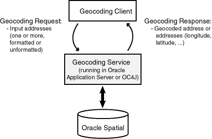

Geocoding is the process of associating spatial locations (longitude and latitude coordinates) with postal addresses. This chapter includes the following major sections:
This section describes concepts that you must understand before you use the Spatial geocoding capabilities.
Addresses to be geocoded can be represented either as formatted addresses or unformatted addresses.

Figure 11-1 shows the basic flow of action with the geocoding service: a client locates a remote the geocoding service instance, sends a geocoding request, and processes the response returned by the geocoding service instance.
Figure 11-1 Basic Flow of Action with the Spatial Geocoding Service
As shown in Figure 11-1:
The client sends an XML geocoding request, containing one or more input addresses to be geocoded, to the geocoding service using the HTTP protocol.
The geocoding service parses the input request and looks up the input address in the database.
The geocoding service sends the geocoded result in XML format to the client using the HTTP protocol.
