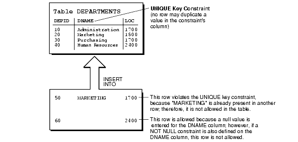

Choose columns for unique keys carefully. The purpose of these constraints is different from that of primary keys. Unique key constraints are appropriate for any column where duplicate values are not allowed. Primary keys identify each row of the table uniquely, and typically contain values that have no significance other than being unique. Figure 6-1 shows an example of a table with a unique key constraint.
Figure 6-1 Table with a UNIQUE Constraint
You cannot have identical values in the non-null columns of a compositeUNIQUE key constraint (UNIQUE key constraints allow NULL values).Some examples of good unique keys include:
An employee social security number (the primary key might be the employee number)
A truck license plate number (the primary key might be the truck number)
A customer phone number, consisting of the two columns AREA_CODE and LOCAL_PHONE (the primary key might be the customer number)
A department name and location (the primary key might be the department number)

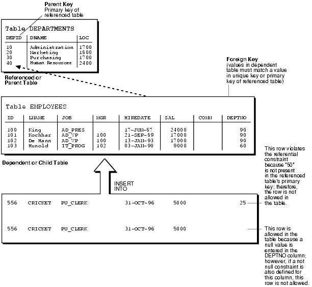

Foreign keys can be comprised of multiple columns. Such a composite foreign key must reference a composite primary or unique key of the exact same structure, with the same number of columns and the same data types. Because composite primary and unique keys are limited to 32 columns, a composite foreign key is also limited to 32 columns.
Figure 6-2 Tables with FOREIGN KEY Constraints
Foreign keys allow key values that are all NULL, even if there are no matching PRIMARY or UNIQUE keys.
By default (without any NOT NULL or CHECK clauses), the FOREIGN KEY constraint enforces the match none rule for composite foreign keys in the ANSI/ISO standard.
To enforce the match full rule for NULL values in composite foreign keys, which requires that all components of the key be NULL or all be non-null, define a CHECK constraint that allows only all nulls or all non-nulls in the composite foreign key. For example, with a composite key comprised of columns A, B, and C:
CHECK ((A IS NULL AND B IS NULL AND C IS NULL) OR
       (A IS NOT NULL AND B IS NOT NULL AND C IS NOT NULL))
In general, it is not possible to use declarative referential integrity to enforce the match partial rule for NULL values in composite foreign keys, which requires the non-null portions of the key to appear in the corresponding portions in the primary or unique key of a single row in the referenced table. You can often use triggers to handle this case, as described in Oracle Database PL/SQL Language Reference.
Several relationships between parent and child tables can be determined by the other types of constraints defined on the foreign key in the child table.
No Constraints on the Foreign Key When no other constraints are defined on the foreign key, any number of rows in the child table can reference the same parent key value. This model allows nulls in the foreign key.
This model establishes a one-to-many relationship between the parent and foreign keys that allows undetermined values (nulls) in the foreign key. An example of such a relationship is shown in Figure 6-2 between the employee and department tables. Each department (parent key) has many employees (foreign key), and some employees might not be in a department (nulls in the foreign key).
NOT NULL Constraint on the Foreign Key When nulls are not allowed in a foreign key, each row in the child table must explicitly reference a value in the parent key because nulls are not allowed in the foreign key.
Any number of rows in the child table can reference the same parent key value, so this model establishes a one-to-many relationship between the parent and foreign keys. However, each row in the child table must have a reference to a parent key value; the absence of a value (a null) in the foreign key is not allowed. The same example in the previous section can be used to illustrate such a relationship. However, in this case, employees must have a reference to a specific department.
UNIQUE Constraint on the Foreign Key When a UNIQUE constraint is defined on the foreign key, only one row in the child table can reference a given parent key value. This model allows nulls in the foreign key.
This model establishes a one-to-one relationship between the parent and foreign keys that allows undetermined values (nulls) in the foreign key. For example, assume that the employee table had a column named MEMBERNO, referring to an employee membership number in the company insurance plan. Also, a table named INSURANCE has a primary key named MEMBERNO, and other columns of the table keep respective information relating to an employee insurance policy. The MEMBERNO in the employee table must be both a foreign key and a unique key:
To enforce referential integrity rules between the EMP_TAB and INSURANCE tables (the FOREIGN KEY constraint)
To guarantee that each employee has a unique membership number (the UNIQUE key constraint)
UNIQUE and NOT NULL Constraints on the Foreign Key When both UNIQUE and NOT NULL constraints are defined on the foreign key, only one row in the child table can reference a given parent key value, and because NULL values are not allowed in the foreign key, each row in the child table must explicitly reference a value in the parent key.
This model establishes a one-to-one relationship between the parent and foreign keys that does not allow undetermined values (nulls) in the foreign key. If you expand the previous example by adding a NOT NULL constraint on the MEMBERNO column of the employee table, in addition to guaranteeing that each employee has a unique membership number, you also ensure that no undetermined values (nulls) are allowed in the MEMBERNO column of the employee table.
Oracle Database allows a column to be referenced by multiple FOREIGN KEY constraints; there is no limit on the number of dependent keys. This situation might be present if a single column is part of two different composite foreign keys.

FOREIGN KEY constraints enforce relationships between columns in different tables. Therefore, they cannot be enabled if the constraint of the referenced primary or unique key is not present or not enabled.
You must use the same data type for corresponding columns in the dependent and referenced tables. The column names need not match.
Because foreign keys reference primary and unique keys of the parent table, and PRIMARY KEY and UNIQUE key constraints are enforced using indexes, composite foreign keys are limited to 32 columns.
If the column list is not included in the REFERENCES option when defining a FOREIGN KEY constraint (single column or composite), then Oracle Database assumes that you intend to reference the primary key of the specified table. Alternatively, you can explicitly specify the column(s) to reference in the parent table within parentheses. Oracle Database automatically checks to verify that this column list references a primary or unique key of the parent table. If it does not, then an informative error is returned.
To create a FOREIGN KEY constraint, the creator of the constraint must have privileged access to the parent and child tables.
Parent Table The creator of the referential integrity constraint must own the parent table or have REFERENCES object privileges on the columns that constitute the parent key of the parent table.
Child Table The creator of the referential integrity constraint must have the ability to create tables (that is, the CREATE TABLE or CREATE ANY TABLE system privilege) or the ability to alter the child table (that is, the ALTER object privilege for the child table or the ALTER ANY TABLE system privilege).
In both cases, necessary privileges cannot be obtained through a role; they must be explicitly granted to the creator of the constraint.
These restrictions allow:
The owner of the child table to explicitly decide which constraints are enforced and which other users can create constraints
The owner of the parent table to explicitly decide if foreign keys can depend on the primary and unique keys in her tables
Oracle Database allows different types of referential integrity actions to be enforced, as specified with the definition of a FOREIGN KEY constraint:
