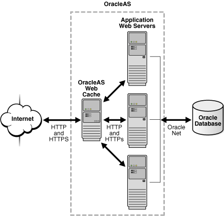

Good candidates for CQN are applications that cache the result sets of queries on infrequently changed objects in the middle tier, to avoid network round trips to the database. These applications can use CQN to register the queries to be cached. When such an application receives a notification, it can refresh its cache by reexecuting the registered queries.
An example of such an application is a web forum. Because its users need not view new content as soon as it is inserted into the database, this application can cache information in the middle tier and have CQN tell it when it when to refresh the cache.

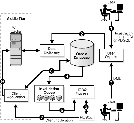

Figure 12-1 illustrates a typical scenario in which the database serves data that is cached in the middle tier and then accessed over the Internet.
Applications in the middle tier require rapid access to cached copies of database objects while keeping the cache as current as possible in relation to the database. Cached data becomes obsolete when a transaction modifies the data and commits, thereby putting the application at risk of accessing incorrect results. If the application uses CQN, the database can publish a notification when a change occurs to registered objects with details on what changed. In response to the notification, the application can refresh cached data by fetching it from the back-end database.
Figure 12-2 illustrates the process by which middle-tier Web clients receive and process notifications.
Figure 12-2 Basic Process of Continuous Query Notification (CQN)
Explanation of steps in Figure 12-2 (assuming that registrations are created using PL/SQL and that the application has cached the result set of a query on HR.EMPLOYEES):
The developer uses PL/SQL to create a CQN registration for the query, which consists of creating a stored PL/SQL procedure to process notifications and then using the PL/SQL CQN interface to create a registration for the query, specifying the PL/SQL procedure as the notification handler.
The database populates the registration information in the data dictionary.
A user updates a row in the HR.EMPLOYEES table in the back-end database and commits the update, causing the query result to change. The data for HR.EMPLOYEES cached in the middle tier is now outdated.
The database adds a message that describes the change to an internal queue.
The database notifies a JOBQ background process of a new notification message.
The JOBQ process executes the stored procedure specified by the client application. In this example, JOBQ passes the data to a server-side PL/SQL procedure. The implementation of the PL/SQL notification handler determines how the notification is handled.
Inside the server-side PL/SQL procedure, the developer can implement logic to notify the middle-tier client application of the changes to the registered objects. For example, it notifies the application of the ROWID of the changed row in HR.EMPLOYEES.
The client application in the middle tier queries the back-end database to retrieve the data in the changed row.
The client application updates the cache with the new data.
