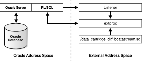

PL/SQL alerts a Listener process, which in turn starts a session-specific agent. Unless some other particular agent has been designated either in the CREATE LIBRARY
statement for the procedure's specified library or in the agent argument of the CREATE PROCEDURE
statement, the default agent extproc
is launched. The Listener hands over the connection to the agent. PL/SQL passes the agent the name of the DLL, the name of the external procedure, and any parameters passed in by the caller. The rest of this account assumes that the agent launched is the default agent extproc
After receiving the name of the DLL and the external procedure, extproc
loads the DLL and runs the external procedure. Also, extproc
handles service calls, such as raising an exception, and callbacks to the Oracle server. Finally, extproc
passes to PL/SQL any values returned by the external procedure. Figure 5-1 shows the flow of control.
Figure 5-1 How to Call an External Procedure
After the external procedure completes, extproc
remains active throughout your Oracle session. Thus, you incur the cost of spawning extproc
only once, no matter how many calls you make. Still, you should call an external procedure only when the computational benefits outweigh the cost. When you log off, extproc
is killed.
