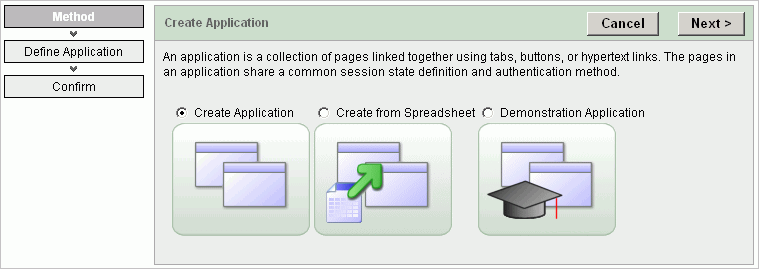

For Method, accept the default, Create Application, and click Next.

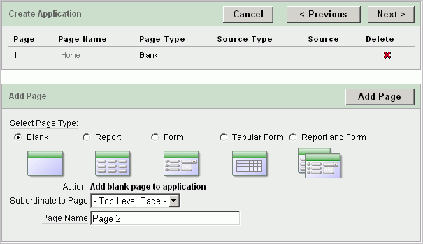

Next, add a page to your application.
For Pages, specify the following in the Add Page section:
Select Page Type - Accept the default, Blank.
Tip:
Explanatory information for each option appears on the right side of the page. This page-level help appears throughout the application.Page Name - Enter Home
Click Add Page.
The new page is listed in the top area. Also, note that the Add Page area appears so you can continue adding pages to your initial application.

In the Add Page section, specify the following:
Select Page Type - Select Report.
Subordinate to Page - Select Home.
This sets up the hierarchy among the pages in your application.
Page Source - Accept the default, Table.
Table Name - Select OEHR_DEPARTMENTS.
The list shows all tables and views in the schema associated with the application.
Include Analysis Pages - Do not select.
If selected, you are prompted for information about additional summary reports and charts you can add to this page.
Click Add Page.
Notice that the pages listed in the Create Application section reflect the hierarchy of the pages in your application.

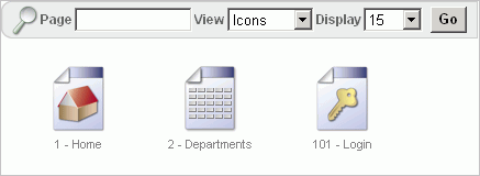

The two pages you created, Home and Departments, appear as icons by default.
To view the pages in a list instead of as icons, from the View list select Details and click Go. Your view setting is retained from session to session.Because these steps use the default setting, switch back to Icons view before continuing.
Notice that Application Express adds a Login page automatically to your application.

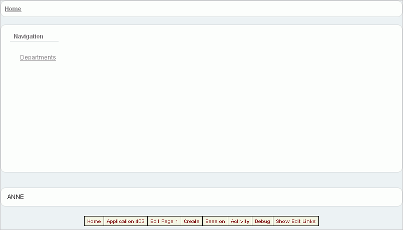

The Home page of your application appears.
Notice that a link to the Departments page appears on the Home page because you set up that hierarchy.
Also notice the Developer toolbar at the bottom of the page. These links appear when you run an application within the development environment. The Developer toolbar offers a quick way to edit the current page; create a new page, region, or page control; view session state; or toggle in and out of Debug mode.

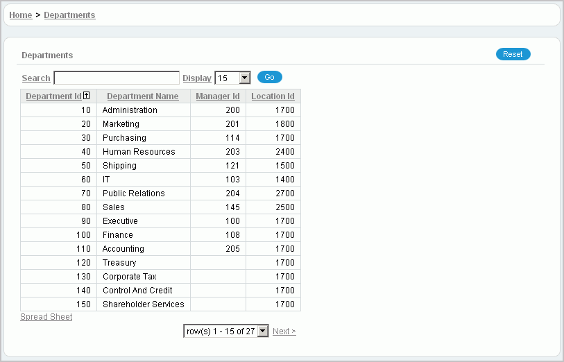

The Departments page appears.
Notice that Application Express includes several features that let you perform certain tasks quickly:
Breadcrumbs - Display the hierarchy and path of the pages. Click a breadcrumb to move to a previous page.
Sort - Click a column heading to sort the data.
Search - Enter data to locate a record within the table. Search is not case sensitive.
Display - Select the number of records you want to view on the page.
Spread Sheet - Click the link to save the data to a CSV file.
Next and Previous - Click the links to move quickly from one set of records to another.
Row list - Select which set of records to view on the page.

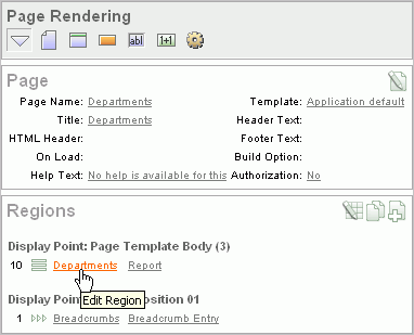

Click the Edit Page 2 link on the Developer toolbar (at the bottom of the page).
The Page Definition for Page 2 appears. A page is the basic building block of an application. Pages contain user interface elements such as tabs, lists, buttons, items, and regions. To see the definition of each page belonging to your application, you use the Page Definition page. For more information, see "What Is Application Builder?".

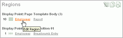

Under Page Rendering, locate the Regions section.
Click Departments.
Scroll down to Source, and replace the default Region Source script with the following:

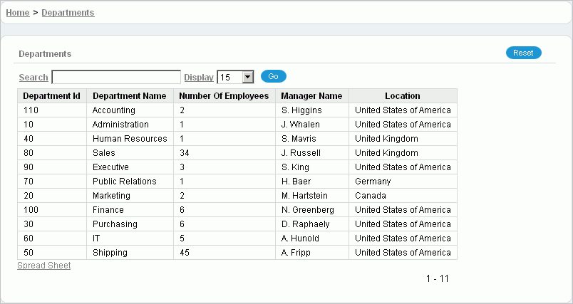

To see how the page looks to end users, run the page. When you run a page, the Application Express engine dynamically renders and processes the page to display viewable HTML.
To run the page:
Click the Run Page icon in the upper right corner.
The revised Departments report appears.
Note that the revised report has three new columns: Number of Employees, Manager Name, and Location. Also note that your data might appear in a different order. You can ignore this difference and continue with the steps.

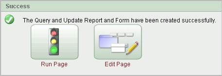

For Confirm, verify the information and click Finish.

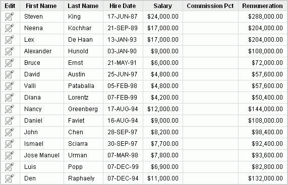

To preview the two pages you just created, run the current page. From the Employees report, you can then preview the form.
To preview the pages:
Click the Run Page icon.

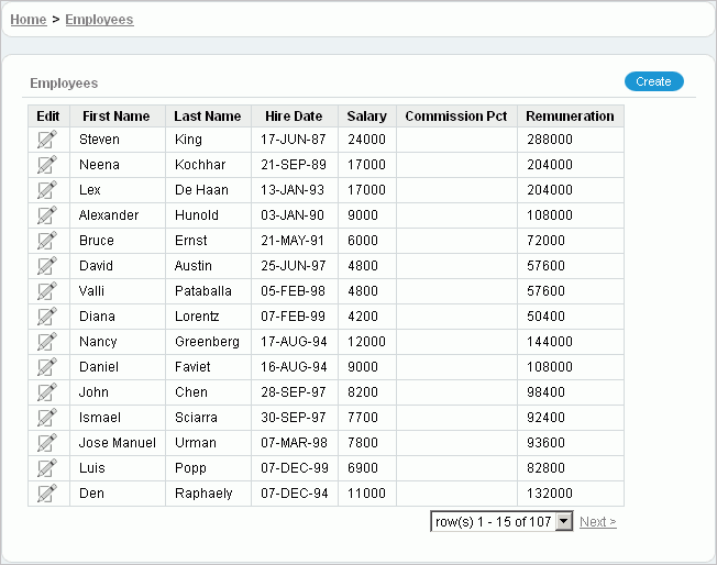

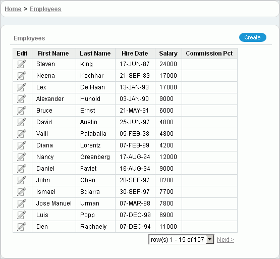

The Employees report appears.
Note the following about the Employees report:
The Edit icon you selected appears in each row. You can click the Edit icon to update the employee record.
The Create button appears in the upper right corner. You can click the Create button to add an employee to the underlying table.
The Employees report includes the five columns you specified. When you selected the columns and applied the changes, Application Express created the appropriate SQL code in the background to produce this result.
Your data might appear in a different order. If so, ignore this difference and continue with these steps.

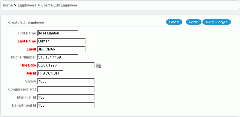

To review the form you also created, click the Edit icon in an Employee row.
The Create/Edit Employee form appears.
Note the following about the Create/Edit Employee form:
The form includes Cancel, Delete, and Apply Changes buttons.
The Hire Date field displays a calender, which is included because the data type of the underlying column is DATE

On the Workspace home page, click Application Builder.
Select the AnyCo Corp application.
Click 3 - Employees.
The Page Definition for page 3, Employees, appears.
Under Regions, click the Employees link (next to Report).
Scroll down to Source, and replace the existing code with the following:
SELECT "EMPLOYEE_ID", "FIRST_NAME", "LAST_NAME", "HIRE_DATE", "SALARY", "COMMISSION_PCT", calc_remuneration(salary, commission_pct) REMUNERATION FROM "#OWNER#"."OEHR_EMPLOYEES"
Click Apply Changes.
To preview the page, click the Run Page icon in the upper right corner. Notice the addition of the new column, Remuneration.
Next, change the format of the columns that contain numeric values.
To change the column format:
Click Edit Page 3 on the Developer toolbar (at the bottom of the page).
The Page Definition appears.
Under Regions, click Report.
The Report Attributes page appears.
Locate the Column Attributes section.
Next, change the column and heading alignment for the appropriate columns.
For Column Alignment, select right for SALARY
, COMMISSION_PCT
, and REMUNERATION
For Heading Alignment, select center for SALARY
, COMMISSION_PCT
, and REMUNERATION
Next, edit the format of the value in the column.
To edit the format of SALARY
Under Column Attributes, click the Edit icon next to SALARY.
The Column Attributes page appears.
For Number/Date Format, select $5,234.10 from the list.
Notice that the appropriate format mask appears in the field.
Repeat the previous step for REMUNERATION
Click the Run Page icon in the upper right corner to preview the page.
Notice that the numbers in the Salary and Remuneration columns now appear with the dollar sign, include commas and decimals, and are correctly aligned.

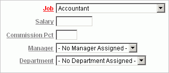

After you create the lists of values, you need to edit these items so that they display as select lists. By default, the items display as text fields.
You also rename the P4_JOB_ID, P4_MANAGER_ID, and P4_DEPARTMENT_ID items.
To edit the job item:

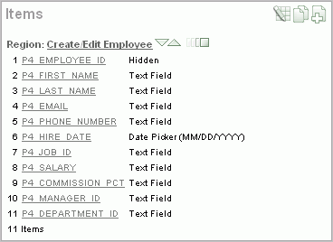

Under Page Rendering, scroll down to the Items section.
Notice that the Items section lists all the items for this page. Currently all but two items show the default type of Text field.
Click P4_JOB_ID.
The Edit Page Item page appears.
Under Name, select Select List from Display As.
Under Label, change Label to Job
Scroll down to List of Values.
From Named LOV, select JOBS.
To edit the manager item:
Under Items, click P4_MANAGER_ID.
Under Label, change Label to Manager
Under List of Values:
Named LOV - Select EMPLOYEES.
Display Null - Select Yes.
Null display value - Enter the following:
- No Manager Assigned -
Note that you did not include this information for Jobs because the Job column is mandatory. For optional columns, such as Manager and Department, you need to specify that the select list display a null record. You can also provide meaningful text to display to the user when this situation occurs.
To edit the department item:
Under Items, select P4_DEPARTMENT_ID.
Under Label, change Label to Department
Named LOV - Select DEPARTMENTS.
- No Department Assigned -
Run the page.
In the form, note that the Job, Manager, and Department fields now display as select lists.

To add a link on the Home page to the Employees report:
Navigate to the Page Definition for the Home page, page 1:
Click Application in the Developer toolbar (at the bottom of the page).
On the Application home page, click Home.
Under Regions, click the List link (next to Navigation).
On the List Entries page, click the Create List Entry button on the right side of the page.
On the Create/Edit List Entry page, edit the following:
Sequence - Change to 20
List Entry Label - Enter Employees
Page - Enter 3
Click Create.
Run the page.
Notice that your Home page now includes a link to Employees.
Click Employees to test the link.

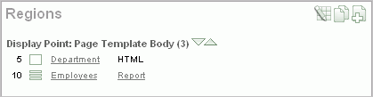

First, create a region on the Employees page to hold the Department select list.
To create a region:
Navigate to the Page Definition for the Employees page, page 3.
In the Regions section, click the Create icon.
For Region:
Identify the type of region to add to this page - Accept the default, HTML, and click Next.
Select the type of HTML region container you wish to create - Accept the default, HTML, and click Next.
For Display Attributes:
Title - Enter Department
Region Template - Select No Template.
This option adds a region without a region title.
Sequence - Change to 5
so that this region displays above Employees.
Accept the remaining defaults and click Next.
Click Create Region.
Note the Regions section now lists a Department region of type HTML.

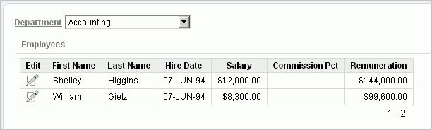

To link the item to the report:
Scroll down to Source.
In Region Source, add the following at the end of the existing code:
WHERE nvl(DEPARTMENT_ID,'-1') = nvl(:P3_DEPARTMENT_ID,'-1')
This WHERE
clause changes the query to display only those employees that belong to the selected department.
When a page is submitted, the branches defined for the page determine which page to display next. Because you want this page to redisplay when a user submits it, create a branch to the same page.
To create a branch:
Under Page Processing, Branches, click the Create icon.
For Point and Type, accept the defaults and click Next.
For Target:
Page - Enter 3
Select the reset pagination for this page check box.
When you select the reset pagination option, the application displays the first set of data meeting a user's new query. Otherwise, if the user was on the third page of data and then selected another department, the user would see the third page of data for the new or revised query.
Click Next.
Click Create Branch.

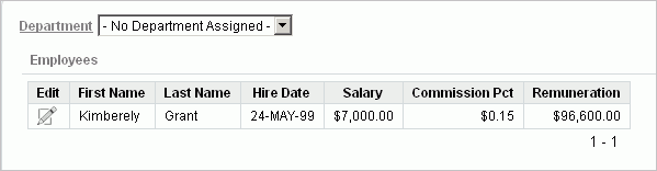

Run the page.
From the Department select list, select Accounting.
Note that the list displays only those employees belonging to that department.
In this exercise, you add a link on the Departments report that will navigate the user to the Employees report. It will also set the focus to the selected department.
To make this change, you edit report attributes on the Departments report.
To change the column value to a link:
Navigate to the Page Definition for the Departments page, page 2.
The Region Attributes page appears.
From Column Alignment, select right for Number of Employees.

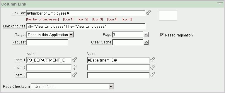

Click the Edit icon next to Number of Employees.
Scroll down to the Column Link section.
Link Attributes - Enter the following:
alt="View Employees" title="View Employees"
Page - Enter 3
Select the Reset Pagination check box.
Item 1, Name - Select P3-DEPARTMENT_ID.
Item 1, Value - Select #Department ID#.
The Column Link section shows all the options you selected.
In summary, these options enable the following behavior when the end user clicks the link:
The end user is navigated to page 3, the Employees report.
On the Employees report, the selected department is in focus.
The user is returned to the first set of employee records when the user selects another department.
Note that in the Column Attributes section, the Number of Employees row contains a check mark in the Link column, reflecting the change you just made.
Run the page.
Note that end users can now drill down on the data in the Number of Employees column.
In the Number of Employees column, click a number to test the link.
Only those employees that belong to the department you selected appear in the Employees report.

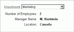

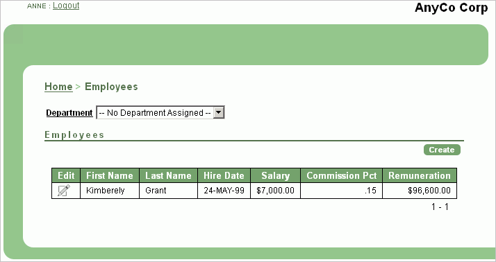

Run the page.
From the Department list, select No Department Assigned.
Employee Kimberely Grant appears. This employee is not currently assigned to a department. Therefore, no department details appear. The 1 - 1 you see on this form is part of the Employees report, not part of the Department Details region you just edited.
From the Department list, select Marketing.
Note the details under Department.

Click Switch Theme.
For Identify Theme, accept the default, 11. Round Green, and click Next.
For Verify Compatibility, review the information, accept the defaults, and click Next.
The wizard verifies that corresponding templates exist in the new theme for all templates used in your current application. If a template is missing, it warns you with a message in the Status column. For this tutorial, you can ignore this message because Application Express maps missing region templates to existing ones.
For Confirm Switch, click Switch Theme.
Run the page.
The new color scheme and display layouts are changed in all your pages.
