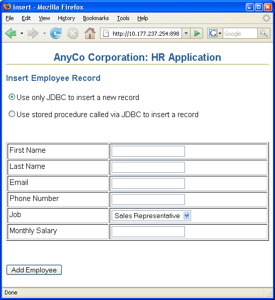

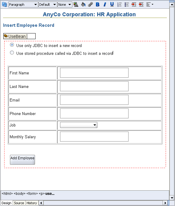

The steps in this section add a radio button group to the insert.jsp page, which allows a user to choose between inserting an employee record using the stored procedure, or by using a SQL query in Java code.
Open insert.jsp in the Visual Editor, if it is not already open.
Create a new line after the Insert Employee Record heading. With the cursor on this new line, drag UseBean from the JSP page of the Component Palette to add a jsp:useBean tag to the page. Enter empsbean as the ID, browse to select hr.DataHandler as the Class, and set the Scope to session. With the UseBean still selected on the page, set the style of this line to None instead of Heading 3.
Drag a Radio Button component from the HTML Forms page of the Component Palette onto the page inside the form above the table. In the Insert Radio Button dialog, enter useSP as the Name, false as the Value, and select Checked. Click OK.
In the Visual Editor, position the cursor to the right of the button, and enter text to describe the purpose of the button, for example, 'Use only JDBC to insert a new record'.
Press Enter at the end of the current line to create a new line.
Drag a second Radio Button below the first one. In the Insert Radio Button dialog, use useSP as the Name, true as the Value, and ensure that the Checked checkbox is not selected.
In the Visual Editor, position the cursor directly to the right of the button, and enter text to describe the purpose of the button, for example, 'Use stored procedure called via JDBC to insert a record'.
Save the page.
Figure 6-1 shows insert.jsp with the radio button that provides the option to use a stored procedure.
Figure 6-1 Adding a Link to Provide the Stored Procedure Option

To create the drop down list displaying the list of job IDs and job titles in the Insert page, you hard-coded the job IDs and job titles. In the following steps, you replace this with a dynamically-generated list provided by the REF CURSOR created in the previous section.
Double-click insert.jsp in the Application Navigator to open it in the Visual Editor, if it is not already open.
Drag a Page Directive onto the page to the right of the useBean tag. In the Insert Page Directive dialog box, enter Java as the Language, and in the Import field, browse to select java.sql.ResultSet. Click OK.
Drag a scriptlet onto the page next to the Page Directive. In the Insert Scriptlet dialog box, add the following code to execute the getJobs method and return a result set containing a list of jobs.
ResultSet rset = empsbean.getJobs();
Select the ListBox component in the page, and click Scriptlet in the JSP Component Palette. (You need not drag and drop the scriptlet onto the page in this case.) The Insert Scriptlet dialog box appears.
Enter the following code into the Insert Scriptlet dialog box. Click OK.

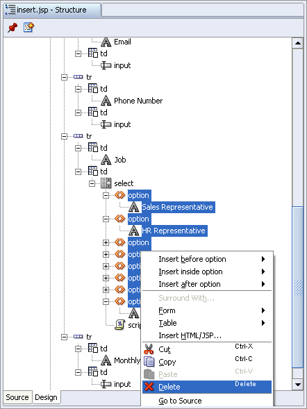

Remove the hard-coded values as follows.
With the ListBox component still selected, in the Structure window scroll to Job field. Examine the list of hard-coded options below the select keyword. Delete each of the options, ensuring that you retain the scriptlet.
Figure 6-3 Structure View of Dropdown ListBox Options
Save the page.

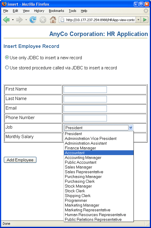

Now run the application, click to insert a new employee and use the list to display a list of available jobs. Figure 6-4 shows the dynamic jobs list in the browser.
Figure 6-4 Dynamically Generated List in Browser
