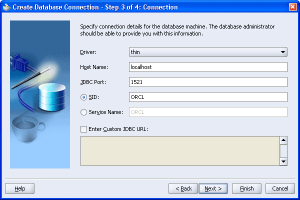

In the Connection screen, you must provide information about the computer where your database is located. Your database administrator should provide you with this information.
Enter the following information:
Host Name: Host name of the computer where Oracle Database is installed
If database is on the same computer, then for the Host Name parameter, enter localhost
Figure 3-1 shows the Connection screen where you enter these details.

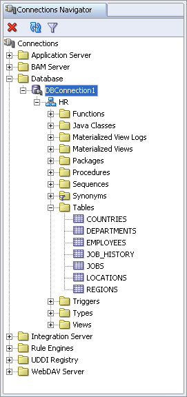

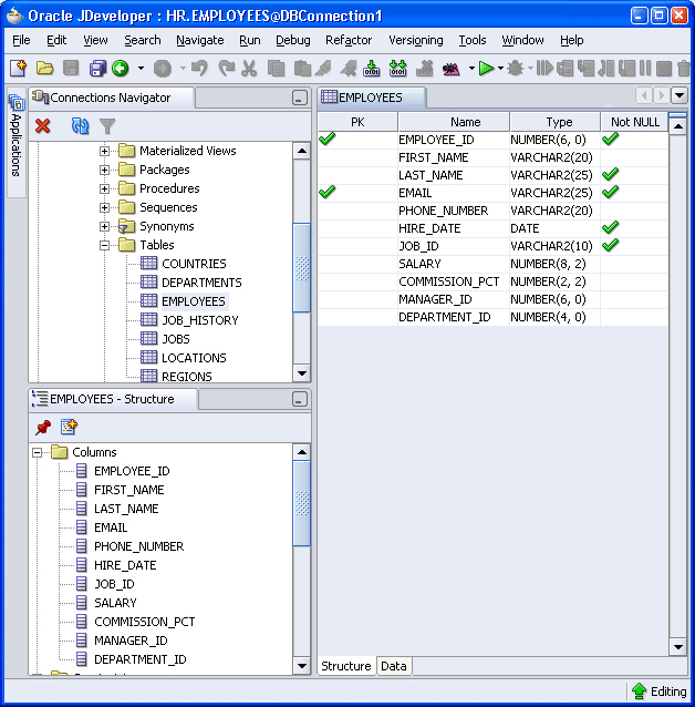

After you have successfully established a connection to the database, you can browse its contents through the Connection Navigator. The Connection Navigator displays a navigable, hierarchical tree structure for the database, its objects, their instances, and the contents of each. To view the contents at each level of the hierarchy of the database connection that you created, do the following:
The Database node in the Connection Navigator now shows a node with the name of your connection. Click the plus symbol (+) to the left of the connection name to expand the navigation tree. The name of the schema to which you connected, in this case HR
, is displayed.
To view the list of all the objects in the HR
schema, expand the HR navigation tree. To display a list of the instances of an object type, for example Tables, expand the Table navigation tree.
Figure 3-2 Accessing Database Objects in the Connection Navigator
The Structure window below the navigator shows the detailed structure of any object selected in the navigator. Select a table in the navigator (for example Employees) to see the columns of that table in the Structure window.
Figure 3-3 Viewing the Table Structure and Data
If you double-click a table in the navigator, the structure of that table is displayed in the main editing area of the window. It includes details about all the columns, such as Name, Type, and Size, so you can browse the table definition.
To view the data from a table, select the Data tab below the table structure. You can now view and browse through the table data.
You can also edit the objects in the Connection Navigator. To edit a table, right-click the table and select Edit from the shortcut menu. A dialog box allows you to make changes to the selected table.

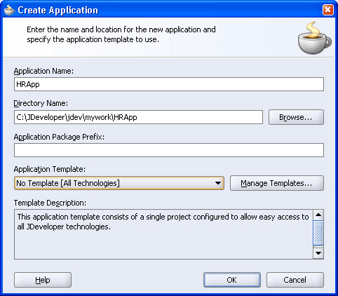

To get started with JDeveloper, you must create an application and at least one project in which to store your work, as follows:
In the Application Navigator, right-click Applications, and select New Application from the shortcut menu. The Create Application Workspace dialog box is displayed, which is shown in Figure 3-4.
Enter HRApp
in the Application Name field, and in the Application Template list, select No Template [All Technologies]. Click OK. The Create Project dialog box is displayed.
On the Create Project dialog box, enter view
as the name of the project.
The new HRApp
application is displayed in the Application Navigator.

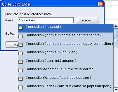

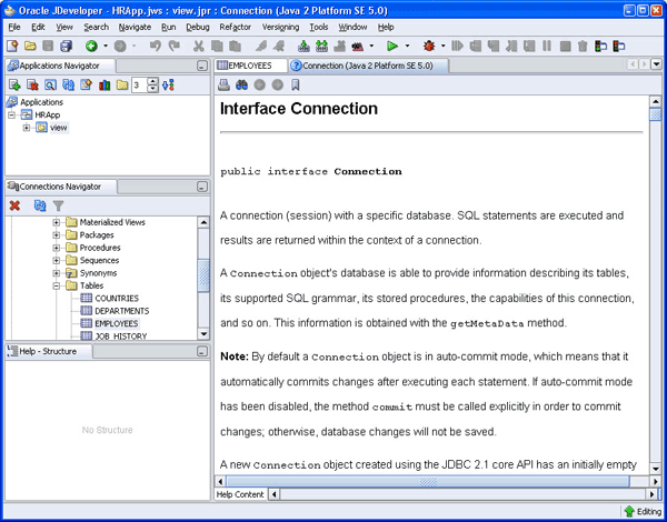

You can view the Javadoc or the code for any of the classes available in the project technology scope within JDeveloper. In addition, you can view the details of all the methods available for those classes.
For example, to see the code or Javadoc for the Connection
class, do the following:
With your project selected in the Application Navigator, from the Navigate menu select Go to Java Class. You can also do this for a specific file in your project.
In the Go to Java Class dialog box, select Source or Javadoc.
Enter the name of the class you want to view in the Name field, or click Browse to find the class. For the Connection
class, start to enter Connection
, and from the displayed list select Connection (java.sql).
Figure 3-5 Selecting the Class to View the Javadoc in JDeveloper
Click OK.

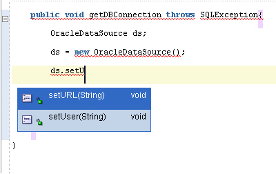

You can either set properties using appropriate set
xxx
methods for the DataSource
object or use the getConnection
method that accepts these properties as input parameters.

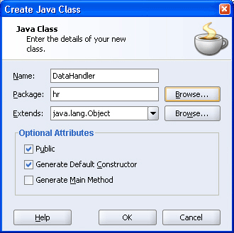

, which will contain the methods for querying the database and modifying the data in it.
In the Application Navigator, right-click the View project, and from the shortcut menu, select New.
In the New Gallery, select the General category. In the Items list, select Java Class, and click OK. The Create Java Class dialog box is displayed.
In the Create Java Class dialog box, enter DataHandler
as the class Name, and hr
as the Package. Do not change the default values of the Optional Attributes, and click OK. The Create Java Class dialog box with the appropriate values specified is shown in Figure 3-7.

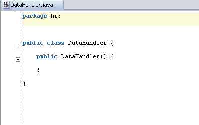

The skeleton DataHandler
class is created and is displayed in the Java Source Editor. The package declaration, the class declaration, and the default constructor are created by default. Figure 3-8 shows the class displayed in the Java Source Editor, ready for you to add your Java code:

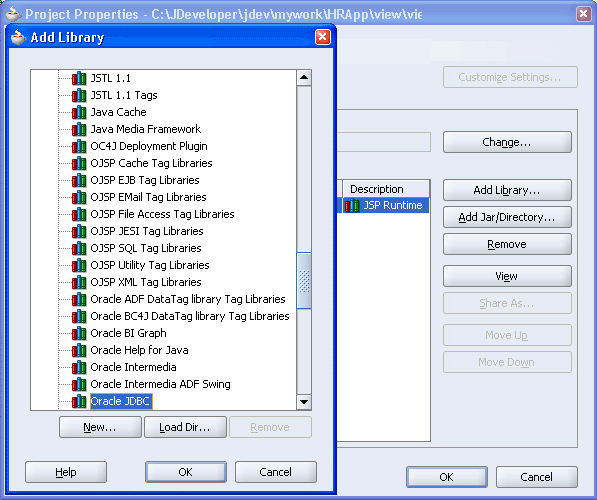

To include libraries in your project, perform the following steps:
Double-click the View project in the Application Navigator to display the Project Properties dialog box.
Click Libraries, and then click Add Library. The Add Library dialog box is displayed with a list of the available libraries for the Java2 Platform, Standard Edition (J2SE) version is displayed.
In the Add Library dialog box, scroll through the list of libraries in the Extension folder. Select the JSP Runtime library and click OK to add it to the list of selected libraries for your project. Similarly, add the Oracle JDBC library. Figure 3-9 shows the Oracle JDBC library added to the view
project.
Click OK.

Connection information is passed to the connection method by using the following connection variables: the connection URL, a user name, and the corresponding password.
Use the Java Source Editor of JDeveloper to edit the DataHandler.java
class as follows:
After the DataHandler
constructor, on a new line, declare the three connection variables as follows:

Start to enter the following to set the URL for the DataSource
object:
ds.setURL(jdbcUrl);
Java Code Insight prompts you by providing you with a list of available OracleDataSource
methods. Scroll through the list to select the setURL(String)
method, and press the Enter key to select it into your code. In the parentheses for this function, enter jdbcUrl
Figure 3-10 shows how the Java Code Insight feature in JDeveloper helps you with inserting code.
