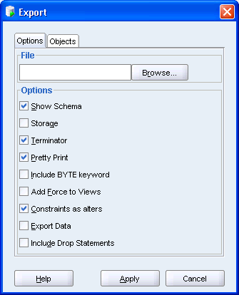

From the SQL Developer main menu, select Tools, then Export DDL (and Data).
Click the Options tab (it should be selected by default).
In the File field, specify the name and location of the export file to be created that will contain the SQL statements to create the objects and insert data. For example: C:\my_exports\hr_export.sql
Under Options, select from the following options to specify objects within object types, or to specify options for the generated SQL statements.
Show Schema: If this option is checked, the schema name is included in CREATE statements. If this option is not checked, the schema name is not included in CREATE statements, which is convenient if you want to re-create the exported objects under a schema that has a different name.
Storage: If this option is checked, any STORAGE clauses in definitions of the database objects are preserved in the exported DDL statements. If you do not want to use the current storage definitions (for example, if you will re-create the objects in a different system environment), uncheck this option.
Terminator: If this option is checked, a line terminator character is inserted at the end of each line.
Pretty Print: If this option is checked, the statements are attractively formatted in the output file, and the size of the file will be larger than it would otherwise be.
Include BYTE Keyword: If this option is checked, column length specifications refer to bytes; if this option is not checked, column length specifications refer to characters.
Add Force to Views: If this option is checked, the FORCE option is added to any CREATE VIEW statements, causing each view to be created even if it contains errors.
Constraints as Alters: If this option is checked, constraints for each table are defined in separate ALTER TABLE statements instead of in the CREATE TABLE statement.
Export Data: If this option is checked, statements are included to insert the data for an exported table or view. If this option is not checked, statements are not included to insert the data for an exported table or view; that is, only the DDL statements are included.
Include Drop Statements: If this option is checked, DROP statements are included before the CREATE statements, to delete any existing objects with the same names.

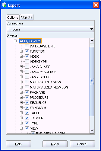

Click the Objects tab.
In the Objects tab:
Under Objects, select All, and then select All My Objects to display the available objects in the hr_conn connection.
Ensure that the types of objects (Constraints, Database Links, Functions, and so on) to be exported are checked. If you want INSERT statements created to insert table data, ensure that Data is checked. If you want certain object types or the table data not to be exported, uncheck the appropriate options.
Click Apply to generate the script.

In the Export dialog box, specify the name and location of the to be created that will contain the SQL statements to create the objects and insert data. For example: C:\my_exports\2day_tables.sql
Under Options, specify the following options for creating the tables for this example:
Show Schema: Uncheck. In this example, if you check this option, it might be inappropriate because the schema name in your test or production environment might not be the same as that in your development environment.
Storage: Uncheck. If you have specified specific storage clauses for your tables that you want to preserve, check this option; however, if you have not specified storage clauses or if you have specified storage clauses that are specific to your development or test environment (that will be different in the production environment), uncheck this option.
Terminator: Check. This is necessary because you want to be able run the resulting script.
Pretty Print: Check. If you check this option, the output is more readable.
Include BYTE Keyword: Uncheck, unless you are working with a multibyte character set, in which case you should check this option.
Add Force to Views: Uncheck, because views will be added in another script for this example.
Constraints as Alters: Check, to have constraints added in separate SQL statements after each CREATE TABLE.
Export Data: Uncheck, because you will export the data separately for this example.
Include Drop Statements: Uncheck. If you want these objects to replace any existing objects with the same name, you can include this. However, a better practice is to have a separate drop script that can be run to remove an older version of your objects before creation. This avoids the chance of accidentally removing an object you did not intend to drop.
In the Objects tab:
