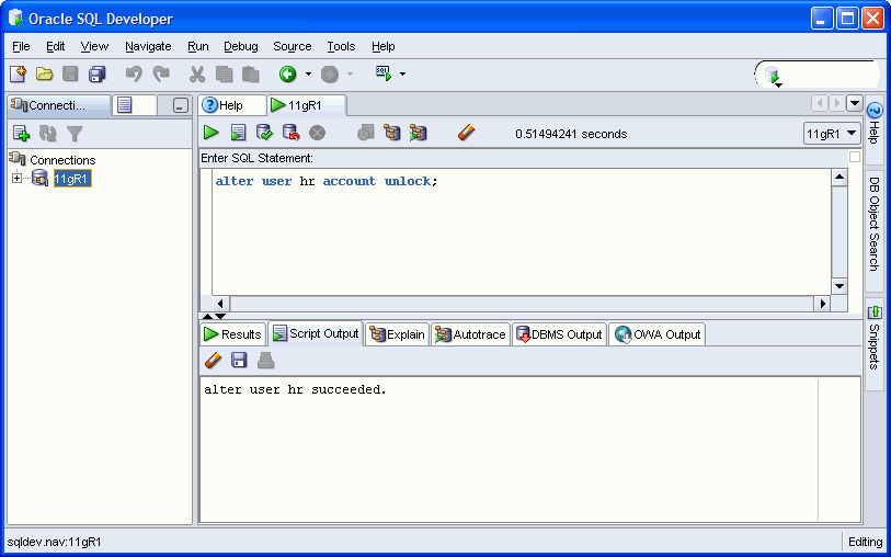

The PHP application connects to the database as the HR user. You may need to unlock the HR account as a user with DBA privileges. To unlock the HR user:
Open SQL Developer and open a connection to your Oracle database.
Login to your Oracle database as system.
Open SQL Workheet or SQL*Plus and run the following SQL statement:
alter user hr account unlock;
For further information about unlocking an Oracle Database account, see Chapter 6, "Managing Users and Security," in the Oracle Database 2 Day DBA guide.

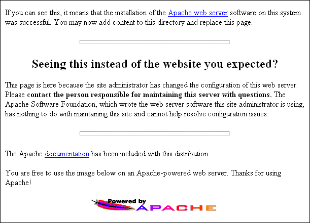

To test the Apache HTTP Server installation:
Start your Web browser on the host on which you installed Apache.
Enter the following URL:
http://localhost/
Your Web browser will display a page similar to the following:
If this page does not appear check your Apache configuration. Common problems are that Apache is not running, or that it is listening on a non-default port.

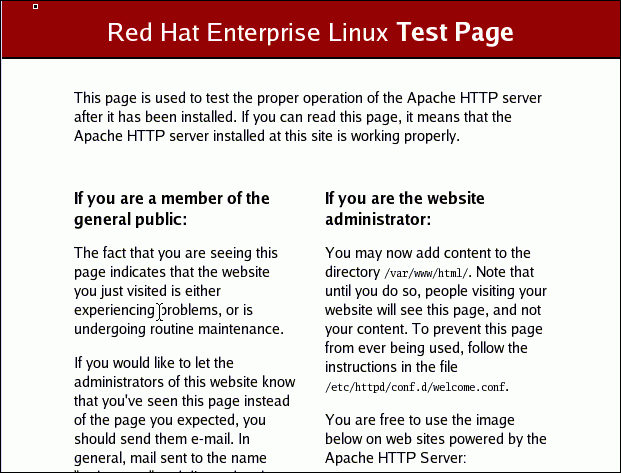

Start your Web browser on the host on which you installed Apache, and enter the following URL:
http://localhost/
If this page does not appear, check your Apache configuration. Common problems are that Apache is not running, or that it is listening on a nondefault port.

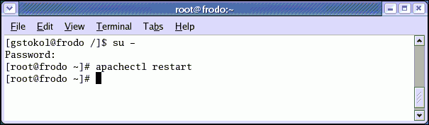

To use the new Apache configuration file, in a command window, restart Apache by entering the following commands:
su - Password: <enter your su (root) password> apachectl restart

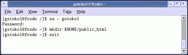

In the command window, log in (not root) and create a public_html subdirectory in the $HOME directory with the following command:
mkdir $HOME/public_html

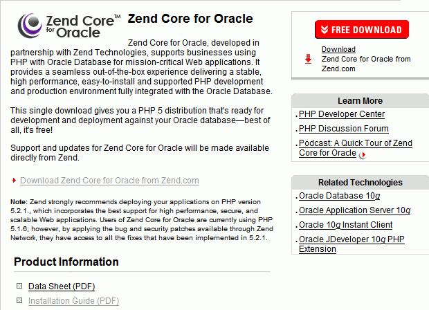

Perform the following steps to obtain Zend Core for Oracle for Windows or Linux:
Enter the following URL in your Web browser:
http://www.oracle.com/technology/tech/php/zendcore/index.html
To the right of the Zend Core for Oracle Web page, click the Free Download button.
Save the downloaded file in a temporary directory, such as c:\tmp on Windows or \tmp on Linux.

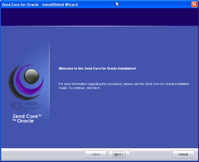

In the initial Zend Core for Oracle Installation page, click Next.
Copyright, 2006, Zend Technologies Ltd.

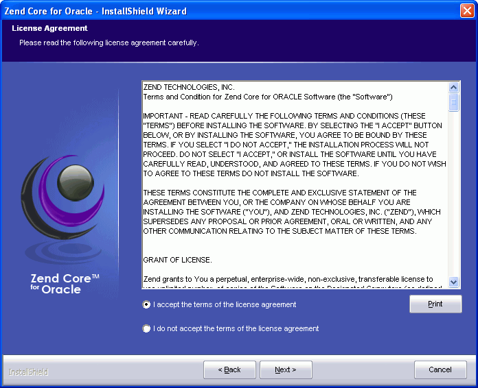

In the Zend Core for Oracle License Agreement page, read the license agreement. To continue with the installation, select I accept the terms of the license agreement, and click Next.

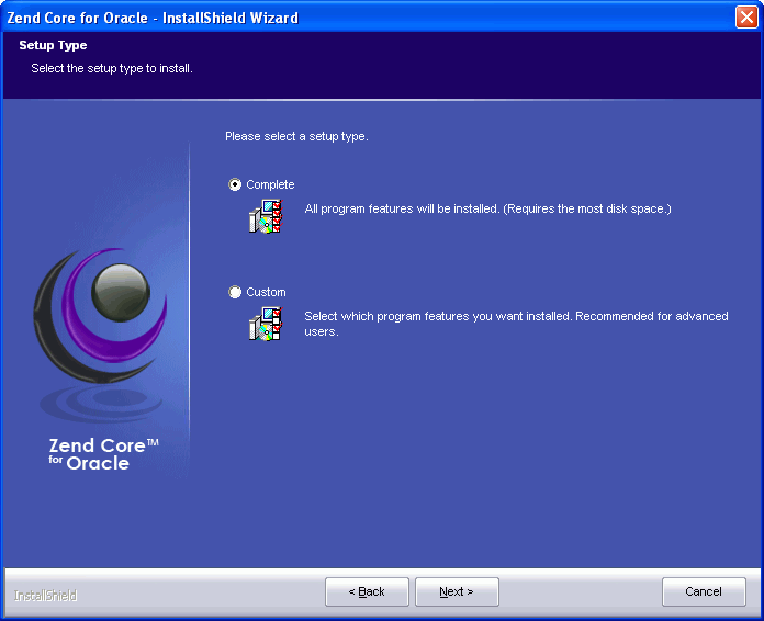

You are prompted to select the type of installation you want. Select Complete, and click Next.

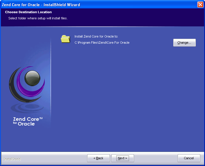

When you are prompted to specify the location for installing Zend Core for Oracle, accept the default (or enter your preferred location), and click Next.

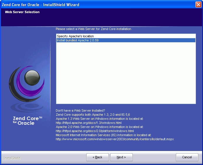

The next page prompts you to select the Web server for Zend Core installation. Accept the Install Bundled Apache option, and click Next.

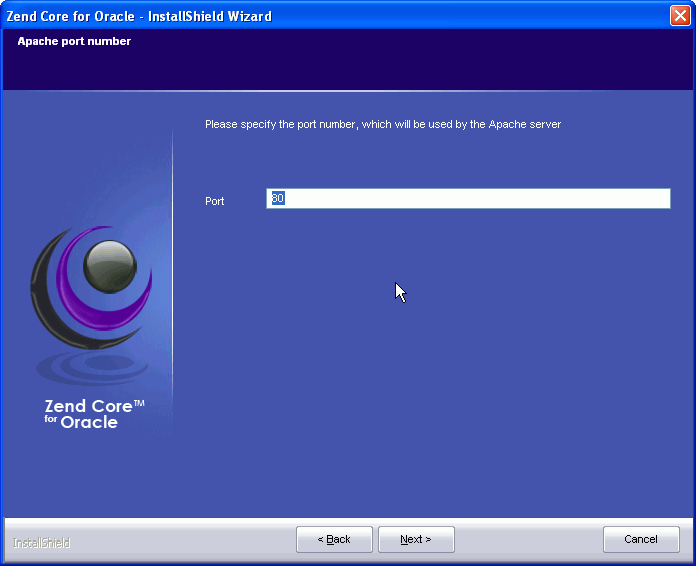

You are then prompted to enter the port number Apache will use. Accept the default value 80, and click Next.

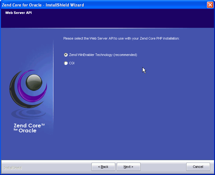

You are then prompted to select the Web Server API to use. Select Apache Module, and click Next.

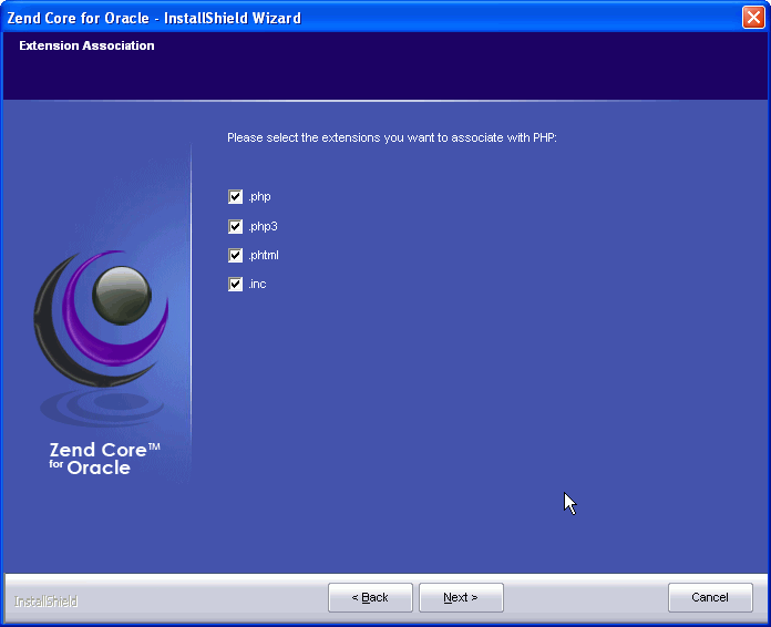

When you are prompted to select extensions to associate with your Zend Core for Oracle installation, select all four, and click Next.

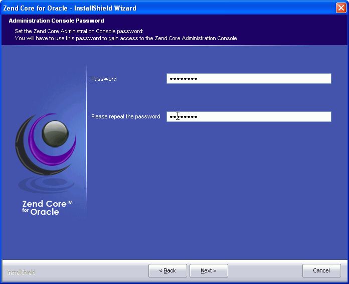

You are now prompted to enter a Zend Core GUI password. This password enables you to log in to the Zend Core Console to configure directives or property values.
Enter the password you want to use to access the Zend Core Console, and click Next.

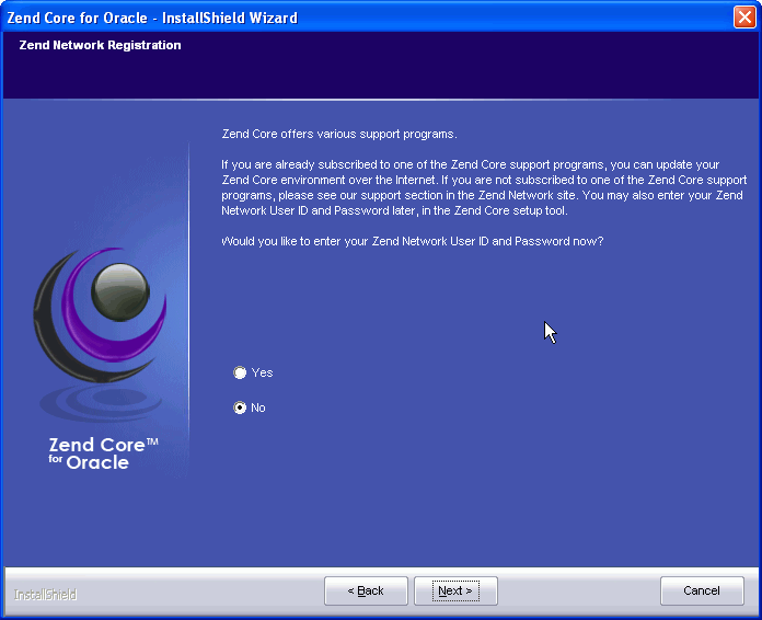

You can optionally enter your Zend network user ID and password to be able to use the Zend Core Console to track when updates to Zend Core and PHP components are available. If you have not registered, or do not want to track updates, select No, and click Next.

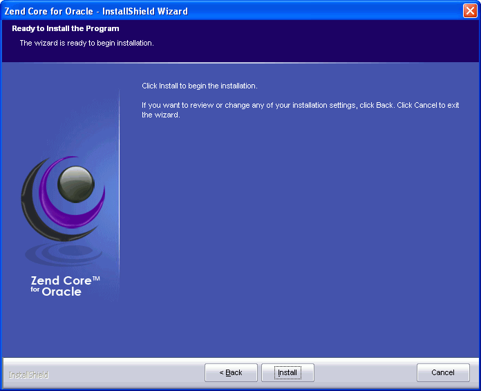

The installation wizard is now ready to begin installing Zend Core for Oracle on your computer. To start the installation wizard, click Install.

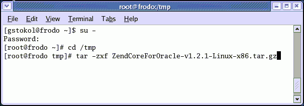

Enter the following commands in a command window to extract the contents of the downloaded Zend Core for Oracle software:
su - Password: <enter the root password> cd /tmp tar -zxf ZendCoreForOracle-v1.2.1-Linux-x86.tar.gz
By default, files are extracted to a subdirectory called ZendCoreForOracle-v1.2.1-Linux-x86.

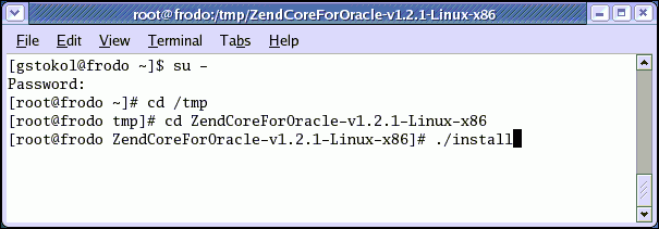

To start the Zend Core for Oracle installation process, enter the following commands:
cd ZendCoreForOracle-v1.2.1-Linux-x86 ./install
The install command must be executed with root user privileges. After you enter the ./install command, the installation process begins (documented in subsequent steps).

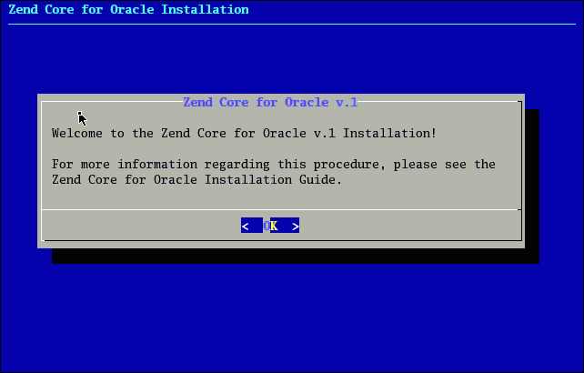

Use the Tab or arrow keys, or use your mouse to move between input fields and buttons in the Zend installer. Press Enter or click with the mouse to select a button.
In the initial Zend Core for Oracle Installation page, click OK.

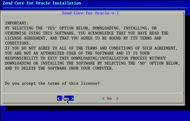

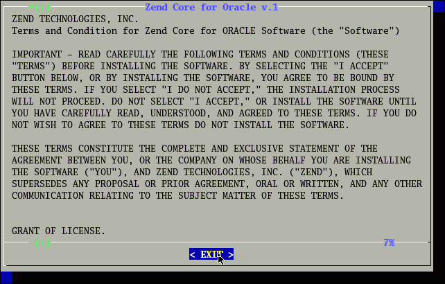

In the Zend Core for Oracle V.1 page, read the license agreement. To continue with the installation, click Exit.
When you are prompted to accept the terms of the license, click Yes.

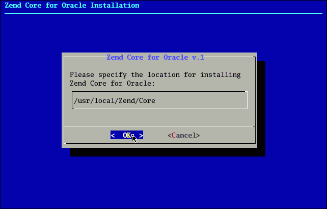

When you are prompted to specify the location for installing Zend Core for Oracle, accept the default (or enter your preferred location), and click OK.

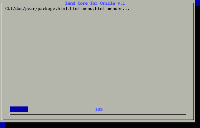

The installer begins extracting the files required for the installation. The following progress screen is visible during the installation process:

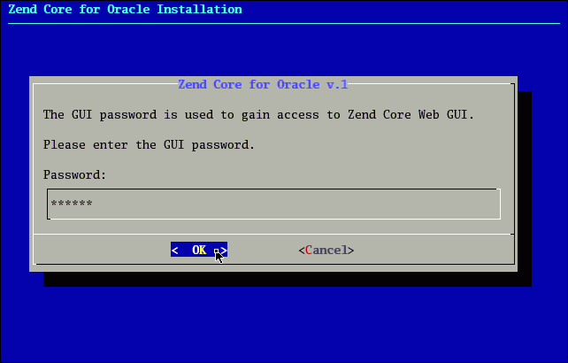

The password you specify here lets you log in to the Zend Core for Oracle administration Web pages. These pages enable you to configure Zend Core for Oracle engine directives and property values.

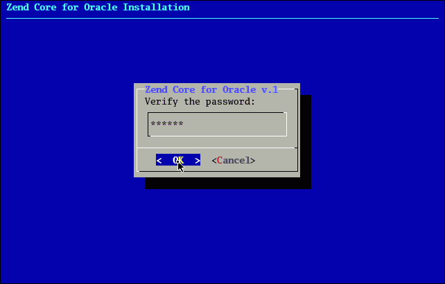

When you are prompted to Verify the password, enter the same password that you specified in Step 7, and click OK.

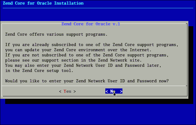

In the Zend Core support page, you can optionally enter your Zend network user ID and password to be able to use the Zend Core Console to track when updates to Zend Core and PHP components are available. If you have not registered, or do not want to track updates, click No.

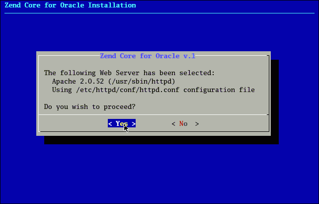

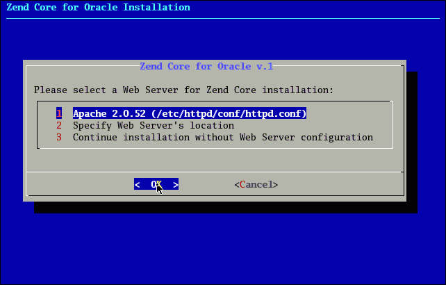

The next page prompts you to select the Web server for Zend Core installation. Select the default (Apache installed with Linux), and click OK.
If you choose, you can install Zend Core for Oracle with another supported Web server that is installed on your system.
In the page confirming your Web server selection, you are prompted whether or not to proceed. Click Yes.

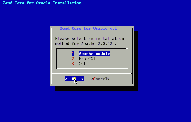

In the next installation page you are prompted to select an installation method for Apache 2.0.52. Select Apache module as the method, and click OK.

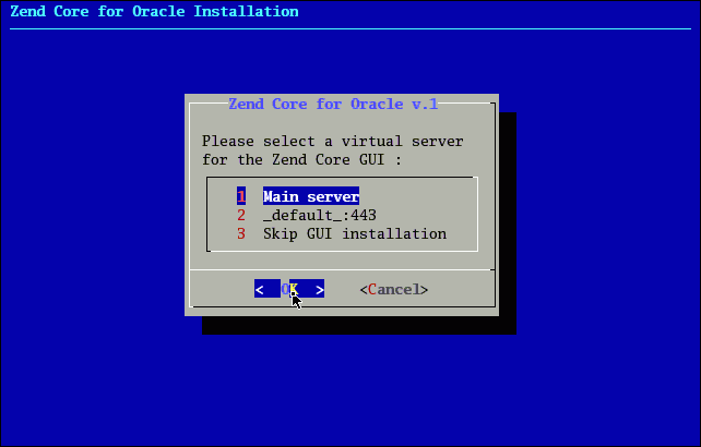

In the next installation page you are prompted to select a virtual server for the Zend Core GUI. Select Main Server, and click OK.

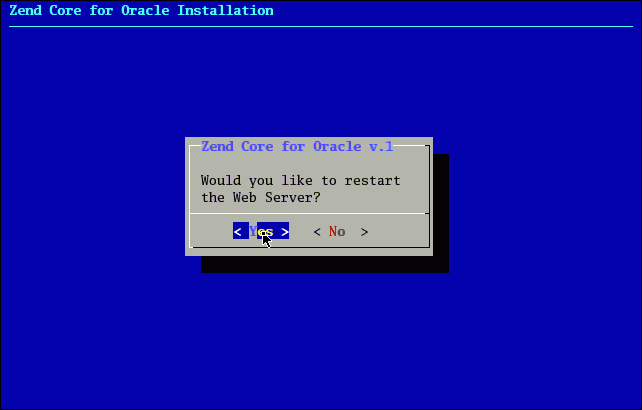

In the next installation page, you are prompted whether or not to restart the Web Server. Click Yes.

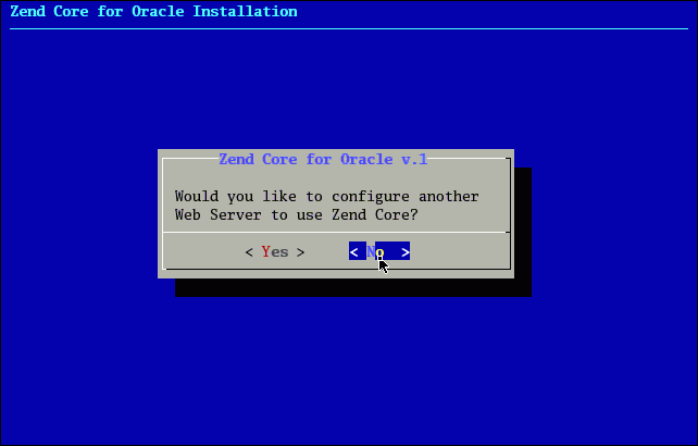

In the next installation page, you are asked whether or not to configure another Web Server to use Zend Core for Oracle. Click No.

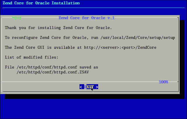

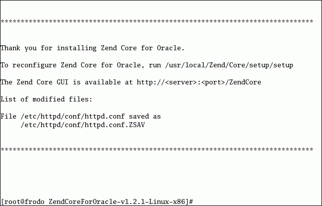

The final installation page lists useful configuration commands and a Web page for the administration of the Zend Core engine. Take note of the information, and click EXIT.
When the Zend Core installation ends, the text from the final installation screen is displayed in your terminal.

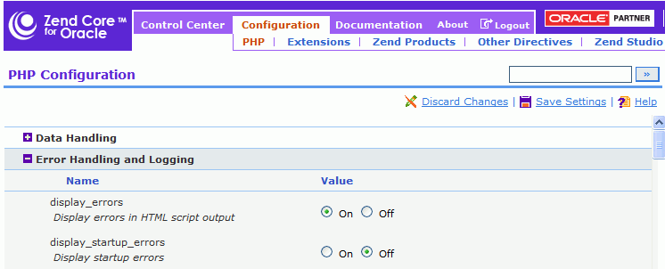

To display the configuration options, click the Configuration tab.
To expand the Error Handling and Logging configuration entry, click the (+) icon .
To enable the display of errors in the HTML script output during development, set the display_errors directive to On.
To save the configuration changes, click Save Settings.

On Linux:
mkdir $HOME/public_html/chap2 cd $HOME/public_html/chap2
