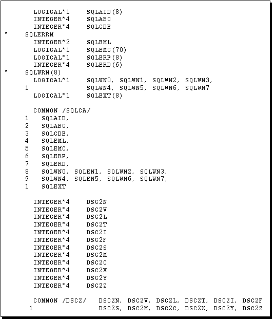

Oracle uses the SQL Communications Area (SQLCA) to store status information passed to your program at run time. The SQLCA is a record-like, FORTRAN data structure that is updated after each executable SQL statement, so it always reflects the outcome of the most recent SQL operation. To determine that outcome, you can check variables in the SQLCA explicitly with your own FORTRAN code or implicitly with the WHENEVER statement.
When MODE={ORACLE|ANSI13}, the SQLCA is required; if the SQLCA is not declared, compile-time errors will occur. The SQLCA is optional when MODE={ANSI|ANSI14}, but you cannot use the WHENEVER SQLWARNING statement without the SQLCA. So, if you want to use the WHENEVER SQLWARNING statement, you must declare the SQLCA.
When MODE={ANSI|ANSI14}, you must declare either SQLSTA (see "Declaring SQLSTA") or SQLCOD (see "Declaring SQLCOD") or both. The SQLSTA status variable supports the SQLSTA status variable specified by the SQL92 standard. You can use the SQLSTA status variable with or without SQLCOD. For more information see Chapter 8 of the Programmer's Guide to the Oracle Precompilers.
The SQLCA contains runtime information about the execution of SQL statements, such as Oracle error codes, warning flags, event information, rows-processed count, and diagnostics.
Figure 2-1 shows all the variables in the SQLCA. However, SQLWN2, SQLWN5, SQLWN6, SQLWN7, and SQLEXT are not currently in use.
Figure 2-1 SQLCA Variable Declarations for Pro*FORTRAN
To ensure portability, LOGICAL variables are used in the SQLCA instead of CHARACTER variables. For a full description of the SQLCA, its fields, and the values its fields can store, see Chapter 8 of the Programmer's Guide to the Oracle Precompilers.
To declare the SQLCA, simply include it (using an EXEC SQL INCLUDE statement) in your Pro*FORTRAN source file outside the Declare Section as follows:
* Include the SQL Communications Area (SQLCA). EXEC SQL INCLUDE SQLCA
Because it is a COMMON block, the SQLCA must be declared outside the Declare Section. Furthermore, the SQLCA must come before the CONNECT statement and the first executable FORTRAN statement.
You must declare the SQLCA in each subroutine and function that contains SQL statements. Every time a SQL statement in one of the subroutines or functions is executed, Oracle updates the SQLCA held in the COMMON block.
Ordinarily, only the order and datatypes of variables in a COMMON-list matter, not their names. However, you cannot rename the SQLCA variables because the precompiler generates code that refers to them. Thus, all declarations of the SQLCA must be identical.
When you precompile your program, the INCLUDE SQLCA statement is replaced by several variable declarations that allow Oracle to communicate with the program.

The SQLCA handles standard SQL communications. The Oracle Communications Area (ORACA) is a similar structure that you can include in your program to handle Oracle-specific communications. When you need more runtime information than the SQLCA provides, use the ORACA.
Besides helping you to diagnose problems, the ORACA lets you monitor your program's use of Oracle resources such as the SQL Statement Executor and the cursor cache, an area of memory reserved for cursor management.
The ORACA contains option settings, system statistics, and extended diagnostics. Figure 2-2 shows all the variables in the ORACA.
Figure 2-2 ORACA Variable Declarations for Pro*FORTRAN
To ensure portability, LOGICAL variables are used in the ORACA instead of CHARACTER variables. For a full description of the ORACA, its fields, and the values its fields can store, see Chapter 8 of the Programmer's Guide to the Oracle Precompilers.
To declare the ORACA, simply include it (using an EXEC SQL INCLUDE statement) in your Pro*FORTRAN source file outside the Declare Section as follows:
* Include the Oracle Communications Area (ORACA). EXEC SQL INCLUDE ORACA
Because it is a COMMON block, the ORACA must be declared outside the Declare Section. Furthermore, the ORACA must come before the CONNECT statement and the first executable FORTRAN statement.
You can redeclare the ORACA in any subroutine or function that contains SQL statements. Every time a SQL statement in the subroutine or function is executed, Oracle updates the ORACA held in COMMON.
Ordinarily, only the order and datatypes of variables in a COMMON-list matter, not their names. However, you cannot rename the ORACA variables because the precompiler generates code that refers to them. Thus, all declarations of the ORACA must be identical.
