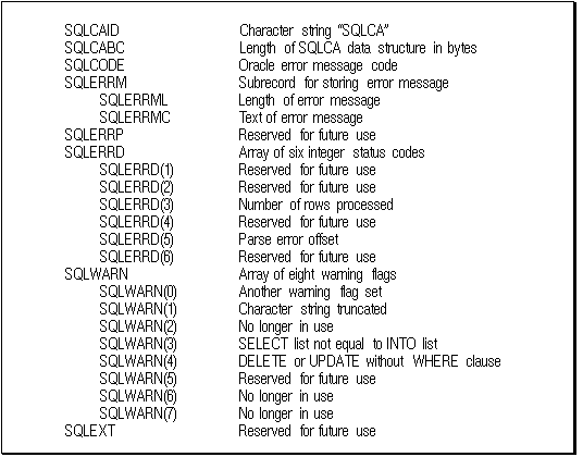

The SQLCA is a record-like, host-language data structure. Oracle updates the SQLCA after every executable SQL statement. (SQLCA values are undefined after a declarative statement.) By checking Oracle return codes stored in the SQLCA, your program can determine the outcome of a SQL statement. This can be done in two ways:
Implicit checking with the WHENEVER statement
Explicit checking of SQLCA variables
You can use WHENEVER statements, code explicit checks on SQLCA variables, or do both. Generally, using WHENEVER statements is preferable because it is easier, more portable, and ANSI-compliant.

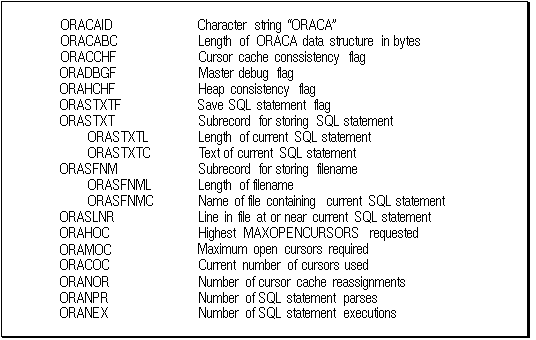

When more information is needed about runtime errors than the SQLCA provides, you can use the ORACA, which contains cursor statistics, SQL statement data, option settings, and system statistics.
The ORACA is optional and can be declared regardless of the MODE setting. For more information about the ORACA status variable, refer to "Using the Oracle Communications Area.

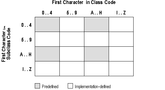

WhenMODE={ORACLE|ANSI13}, declarations of SQLCODE are ignored.SQLSTATE status codes consist of a two-character class code followed by a three-character subclass code. Aside from class code 00 (successful completion), the class code denotes a category of exceptions. Aside from subclass code 000 (not applicable), the subclass code denotes a specific exception within that category. For example, the SQLSTATE value `22012' consists of class code 22 (data exception) and subclass code 012 (division by zero).
Each of the five characters in a SQLSTATE value is a digit (0..9) or an uppercase Latin letter (A..Z). Class codes that begin with a digit in the range 0..4 or a letter in the range A..H are reserved for predefined conditions (those defined in SQL92). All other class codes are reserved for implementation-defined conditions. Within predefined classes, subclass codes that begin with a digit in the range 0..4 or a letter in the range A..H are reserved for predefined subconditions. All other subclass codes are reserved for implementation-defined subconditions. Figure 8-1 shows the coding scheme.
Table 8-5 shows the classes predefined by SQL92.

The SQLCA contains the following runtime information about the outcome of SQL statements:
Oracle error codes
Warning flags
Event information
Rows-processed count
Diagnostics
Figure 8-2 shows all the variables in the SQLCA. To see the SQLCA structure and variable names in a particular host language, refer to your supplement to this Guide.

This section describes the structure of the SQLCA, its fields, and the values they can store.
This integer field holds the status code of the most recently executed SQL statement. The status code, which indicates the outcome of the SQL operation, can be any of the following numbers:
0
Oracle executed the statement without detecting an error or exception.
> 0
Oracle executed the statement but detected an exception. This occurs when Oracle cannot find a row that meets your WHERE-clause search condition or when a SELECT INTO or FETCH returns no rows.
< 0
When MODE={ANSI|ANSI14|ANSI13}, +100 is returned to SQLCODE after an INSERT of no rows. This can happen when a subquery returns no rows to process.
Oracle did not execute the statement because of a database, system, network, or application error. Such errors can be fatal. When they occur, the current transaction should, in most cases, be rolled back.
Negative return codes correspond to error codes listed in Oracle database version 7 Server Messages.
This subrecord contains the following two fields:
This integer field holds the length of the message text stored in SQLERRMC.
This string field holds the message text for the error code stored in SQLCODE and can store up to 70 characters. For the full text of messages longer than 70 characters, use the SQLGLM function.
Verify SQLCODE is negative
before you reference SQLERRMC. If you reference SQLERRMC when SQLCODE is zero, you get the message text associated with a prior SQL statement.
This array of binary integers has six elements. Descriptions of the fields in SQLERRD (called SQLERD in FORTRAN) follow:
SQLERRD(1)
This field is reserved for future use.
SQLERRD(2)
SQLERRD(3)
This field holds the number of rows processed by the most recently executed SQL statement. However, if the SQL statement failed, the value of SQLERRD(3) is undefined, with one exception. If the error occurred during an array operation, processing stops at the row that caused the error, so SQLERRD(3) gives the number of rows processed successfully.
The rows-processed count is zeroed after an OPEN statement and incremented after a FETCH statement. For the EXECUTE, INSERT, UPDATE, DELETE, and SELECT INTO statements, the count reflects the number of rows processed successfully. The count does not include rows processed by an update or delete cascade. For example, if 20 rows are deleted because they meet WHERE-clause criteria, and 5 more rows are deleted because they now (after the primary delete) violate column constraints, the count is 20 not 25.
SQLERRD(4)
This field holds an offset that specifies the character position at which a parse error begins in the most recently executed SQL statement. The first character occupies position zero.
SQLERRD(6)
This array of single characters has eight elements. They are used as warning flags. Oracle sets a flag by assigning it a "W" (for warning) character value. The flags warn of exceptional conditions.
For example, a warning flag is set when Oracle assigns a truncated column value to an output host variable.
Also note that, while Figure 8-2 illustrates SQLWARN as an array, it is implemented in Pro*COBOL as a group item with elementary PIC X items named SQLWARN0 through SQLWARN7. The Pro*FORTRAN implementation is composed of the LOGICAL variables, SQLWN0 through SQLWN7.
Descriptions of the fields in SQLWARN follow:
SQLWARN(0)
This flag is set if another warning flag is set.
SQLWARN(1)
This flag is set if a truncated column value was assigned to an output host variable. This applies only to character data. Oracle truncates certain numeric data without setting a warning or returning a negative SQLCODE value.
To find out if a column value was truncated and by how much, check the indicator variable associated with the output host variable. The (positive) integer returned by an indicator variable is the original length of the column value. You can increase the length of the host variable accordingly.
SQLWARN(2)
This flag is set if one or more nulls were ignored in the evaluation of a SQL group function such as AVG, COUNT, or MAX. This behavior is expected because, except for COUNT(*), all group functions ignore nulls. If necessary, you can use the SQL function NVL to temporarily assign values (zeros, for example) to the null column entries.
SQLWARN(3)
This flag is set if the number of columns in a query select list does not equal the number of host variables in the INTO clause of the SELECT or FETCH statement. The number of items returned is the lesser of the two.
SQLWARN(4)
This flag is set if every row in a table was processed by an UPDATE or DELETE statement without a WHERE clause. An update or deletion is called unconditional if no search condition restricts the number of rows processed. Such updates and deletions are unusual, so Oracle sets this warning flag. That way, you can roll back the transaction if necessary
SQLWARN(5)
This flag is set when an EXEC SQL CREATE {PROCEDURE|FUNCTION|PACKAGE|PACKAGE BODY} statement fails because of a PL/SQL compilation error.
SQLWARN(6)
This flag is no longer in use.
SQLWARN(7)

By default, precompiled programs ignore Oracle error and warning conditions and continue processing if possible. To perform automatic condition checking and error handling, use the WHENEVER statement.
With the WHENEVER statement, you can specify actions to be taken when Oracle detects an error, warning condition, or "not found" condition. These actions include continuing with the next statement, calling a routine, branching to a labeled statement, or stopping.
You code the WHENEVER statement by using the following syntax:
EXEC SQL WHENEVER <condition> <action>;
You can have Oracle automatically check the SQLCA for any of the following conditions.
SQLWARN(0) is set because Oracle returned a warning (one of the warning flags, SQLWARN(1) through SQLWARN(7), is also set) or SQLCODE has a positive value other than +1403. For example, SQLWARN(1) is set when Oracle assigns a truncated column value to an output host variable.
Declaring the SQLCA is optional when MODE={ANSI|ANSI14}. To use WHENEVER SQLWARNING, however, you must declare the SQLCA.
SQLCODE has a value of +1403 (+100 when MODE={ANSI|ANSI14| ANSI13}), because Oracle could not find a row that meets the search condition of a WHERE clause, or a SELECT INTO or FETCH returned no rows. When MODE={ANSI|ANSI14|ANSI13}, +100 is returned to SQLCODE after an INSERT of no rows.
When Oracle detects one of the preceding conditions, you can have your program take any of the following actions.

In the same way the SQLCA handles standard SQL communications; the Oracle Communications Area (ORACA) handles Oracle communications. When you need more information about runtime errors and status changes than the SQLCA provides, use the ORACA. It contains an extended set of diagnostic tools. However, use of the ORACA is optional because it adds to runtime overhead.
Besides helping you to diagnose problems, the ORACA lets you monitor your program's use of Oracle resources such as the SQL Statement Executor and the cursor cache.
In host languages that allow local as well as global declarations, your program can have more than one ORACA. For example, it might have one global ORACA and several local ones. Access to a local ORACA is limited by its scope within the program. Oracle returns information only to the "active" ORACA. The information is available only after a commit or rollback.
To declare the ORACA, simply include it (using an EXEC SQL INCLUDE statement) in your host-language source file as follows:
* Include the Oracle Communications Area (ORACA). EXEC SQL INCLUDE ORACA
The ORACA must be declared outside the Declare Section.
When you precompile your program, the INCLUDE ORACA statement is replaced by several program variable declarations. These declarations allow Oracle to communicate with your program.
To enable the ORACA, you must specify the ORACA option, either on the command line with
ORACA=YES
or inline with
EXEC ORACLE OPTION (ORACA=YES);
Then, you must choose appropriate runtime options by setting flags in the ORACA.
The ORACA contains option settings, system statistics, and extended diagnostics such as
SQL statement text (you can specify when to save the text)
name of the file in which an error occurred
location of the error in a file
cursor cache errors and statistics
Figure 8-3 shows all the variables in the ORACA. To see the ORACA structure and variable names in a particular host language, refer to your supplement to this Guide.
The ORACA includes several option flags. Setting these flags by assigning them nonzero values enables
Save the text of SQL statements
Enable DEBUG operations
Check cursor cache consistency (the cursor cache is a continuously updated area of memory used for cursor management)
Check heap consistency (the heap is an area of memory reserved for dynamic variables)
Gather cursor statistics
The descriptions will help you choose the options you need.
This section describes the structure of the ORACA, its fields, and the values they can store.
If the master DEBUG flag (ORADBGF) is set, this flag lets you check the cursor cache for consistency before every cursor operation.
The Oracle runtime library does the consistency checking and might issue error messages, which are listed in Oracle database version 7 Server Messages. They are returned to the SQLCA just like Oracle error messages.
This flag has the following settings:
0
Disable cache consistency checking (the default).
1
Enable cache consistency checking.
This master flag lets you choose all the DEBUG options. It has the following settings:
0
Disable all DEBUG operations (the default).
1
Enable all DEBUG operations.
If the master DEBUG flag (ORADBGF) is set, this flag tells the Oracle runtime library to check the heap for consistency every time the precompiler dynamically allocates or frees memory. This is useful for detecting program bugs that upset memory.
This flag must be set before the CONNECT command is issued and, once set, cannot be cleared; subsequent change requests are ignored. It has the following settings:
0
Disable heap consistency checking (the default).
1
Enable heap consistency checking.
This flag lets you specify when the text of the current SQL statement is saved. It has the following settings:
0
Never save the SQL statement text (the default).
1
Save the SQL statement text on SQLERROR only.
2
Save the SQL statement text on SQLERROR or SQLWARNING.
3
Always save the SQL statement text.
The SQL statement text is saved in the ORACA subrecord named ORASTXT.
The ORACA provides an enhanced set of diagnostics; the following variables help you to locate errors quickly.
This subrecord helps you find faulty SQL statements. It lets you save the text of the last SQL statement parsed by Oracle. It contains the following two fields:
This integer field holds the length of the current SQL statement.
This string field holds the text of the current SQL statement. At most, the first 70 characters of text are saved.
Statements parsed by the precompiler, such as CONNECT, FETCH, and COMMIT, are not saved in the ORACA.
This subrecord identifies the file containing the current SQL statement and so helps you find errors when multiple files are precompiled for one application. It contains the following two fields:
This integer field holds the length of the filename stored in ORASFNMC.
This string field holds the filename. At most, the first 70 characters are stored.
This integer field identifies the line at (or near) which the current SQL statement can be found.
The variables let you gather cursor cache statistics. They are automatically set by every COMMIT or ROLLBACK statement your program issues. Internally, there is a set of these variables for each CONNECTed database. The current values in the ORACA pertain to the database against which the last commit or rollback was executed.
This integer field records the highest value to which MAXOPENCURSORS was set during program execution.
This integer field records the maximum number of open Oracle cursors required by your program. This number can be higher than ORAHOC if MAXOPENCURSORS was set too low, which forced the precompiler to extend the cursor cache.
This integer field records the current number of open Oracle cursors required by your program.
This integer field records the number of cursor cache reassignments required by your program. This number shows the degree of "thrashing" in the cursor cache and should be kept as low as possible.
This integer field records the number of SQL statement executions required by your program. The ratio of this number to the ORANPR number should be kept as high as possible. In other words, avoid unnecessary reparsing. For help, refer to Appendix C, "Performance Tuning".
