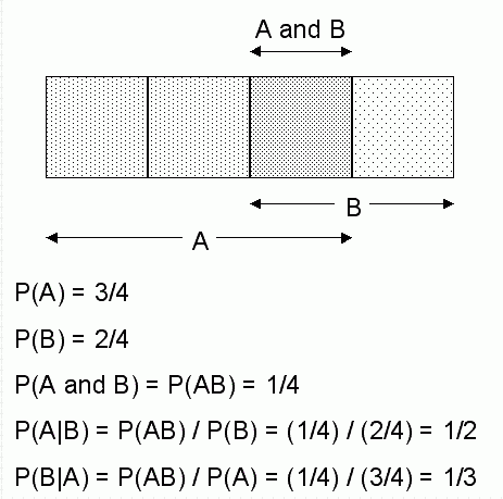

A visual representation of the conditional relationships used in Bayes' Theorem is shown in Figure 15-1.
Figure 15-1 Conditional Probabilities in Bayes' Theorem
For purposes of illustration, Example 15-1 and Figure 15-1 show a dependent event based on a single independent event. In reality, the Naive Bayes algorithm must usually take many independent events into account. In Example 15-1, factors such as income, education, gender, and store location might be considered in addition to age.
