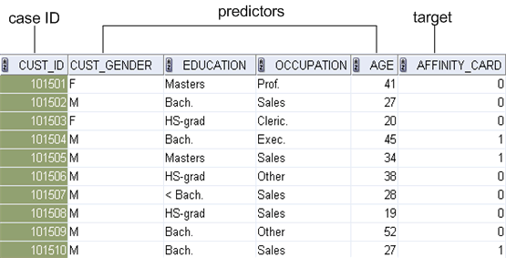

Figure 9-1 shows six columns and ten rows from the case table used to build the Oracle Data Mining sample attribute importance model, ai_sh_sample. A target value of 1 has been assigned to customers who increased spending with an affinity card; a value of 0 has been assigned to customers who did not increase spending.
Figure 9-1 Sample Build Data for Attribute Importance

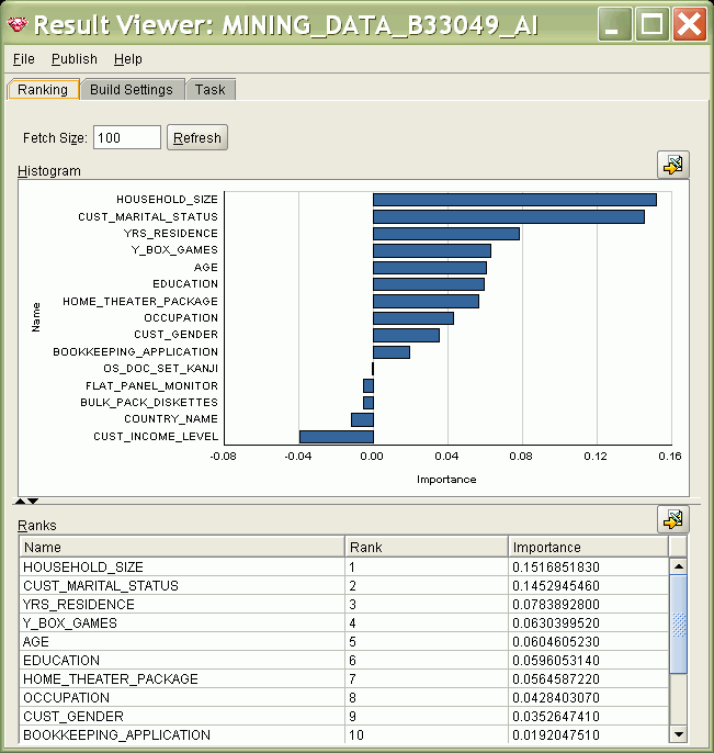

Figure 9-2 shows the results returned by the model ai_sh_sample. The attributes used to build the model are ranked in order of their significance in predicting the target. The results show that household size and marital status have the most effect on whether or not the customer will increase spending with an affinity card. Household size is approximately twice as important as length of residence.
Figure 9-2 Attribute Importance in Oracle Data Miner
Negative ranking indicates noise. Attributes ranked at zero or less do not contribute to the prediction and should probably be removed from the data.

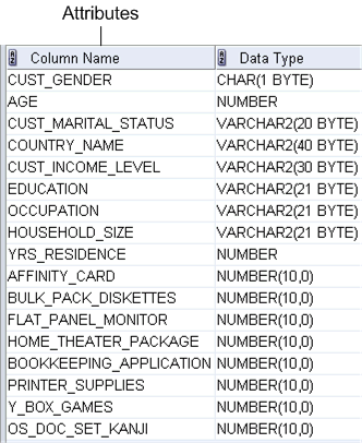

Chapter 20, "Text Mining"Figure 9-4 shows the columns in the case table used to build the Oracle Data Mining sample feature extraction model, nmf_sh_sample. The CUST_ID column holds the case identifier. No column is designated as a target for feature extraction since the algorithm is unsupervised.
Figure 9-4 Sample Build Data for Feature Extraction

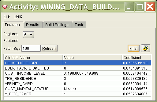

Figure 9-5 shows information about a feature in Oracle Data Miner. It shows the attribute values with coefficients between .05 and .09 for feature 5 extracted from the build data. A coefficient is a constant multiplicative factor of an attribute. A higher coefficient absolute value indicates a higher influence of the attribute on the feature.
Typically these features would be used as input to another model. For an example, see "Sample Text Mining Problem".

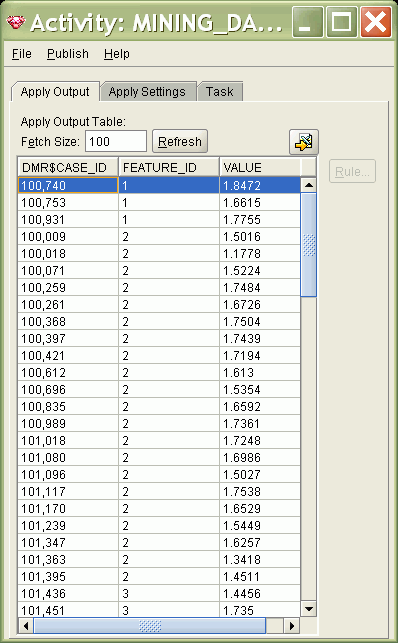

Figure 9-6 shows some of the results when the model is applied to a different set of customer data. Cases are assigned to features with a value that indicates the importance of that feature in that case.
Oracle Data Miner displays the generalized case ID in theDMR$CASE_ID column of the apply output table.See Also:
