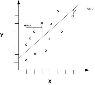

A linear regression technique can be used if the relationship between the predictors and the target can be approximated with a straight line.
Regression with a single predictor is the easiest to visualize. Simple linear regression with a single predictor is shown in Figure 4-1.
Figure 4-1 Linear Regression With a Single Predictor
Linear regression with a single predictor can be expressed with the following equation.
y = θ2x + θ1 + e
The regression parameters in simple linear regression are:
The term multivariate linear regression refers to linear regression with two or more predictors (x1, x2, …, xn). When multiple predictors are used, the regression line cannot be visualized in two-dimensional space. However, the line can be computed simply by expanding the equation for single-predictor linear regression to include the parameters for each of the predictors.
y = θ1 + θ2x1 + θ3x2 + ..... θn xn-1 + e
In multivariate linear regression, the regression parameters are often referred to as coefficients. When you build a multivariate linear regression model, the algorithm computes a coefficient for each of the predictors used by the model. The coefficient is a measure of the impact of the predictor x on the target y. Numerous statistics are available for analyzing the regression coefficients to evaluate how well the regression line fits the data. ("Regression Statistics".)

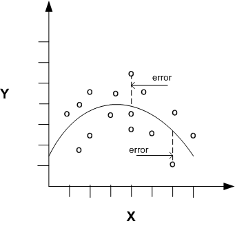

Often the relationship between x and y cannot be approximated with a straight line. In this case, a nonlinear regression technique may be used. Alternatively, the data could be preprocessed to make the relationship linear.
Nonlinear regression models define y as a function of x using an equation that is more complicated than the linear regression equation. In Figure 4-2, x and y have a nonlinear relationship.
Figure 4-2 Nonlinear Regression With a SIngle Predictor
The term multivariate nonlinear regression refers to nonlinear regression with two or more predictors (x1, x2, …, xn). When multiple predictors are used, the nonlinear relationship cannot be visualized in two-dimensional space.

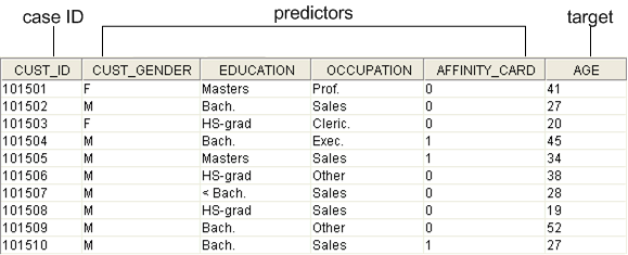

Suppose you want to learn more about the purchasing behavior of customers of different ages. You could build a model to predict the ages of customers as a function of various demographic characteristics and shopping patterns. Since the model will predict a number (age), we will use a regression algorithm.
This example uses the regression model, svmr_sh_regr_sample, which is created by one of the Oracle Data Mining sample programs. Figure 4-3 shows six columns and ten rows from the case table used to build the model. The affinity_card column can contain either a 1, indicating frequent use of a preferred-buyer card, or a 0, which indicates no use or infrequent use.
Figure 4-3 Sample Build Data for Regression
After undergoing testing (see "Testing a Regression Model"), the model can be applied to the data set that you wish to mine.

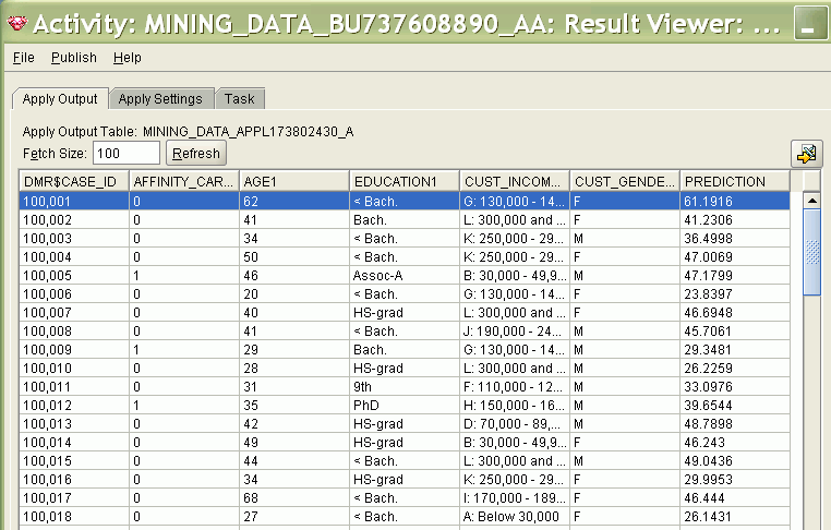

Figure 4-4 shows some of the predictions generated when the model is applied to the customer data set provided with the Oracle Data Mining sample programs. Several of the predictors are displayed along with the predicted age for each customer.
Figure 4-4 Regression Results in Oracle Data Miner
Oracle Data Miner displays the generalized case ID in theDMR$CASE_ID column of the apply output table. A "1" is appended to the column name of each predictor that you choose to include in the output. The predictions (the predicted ages in Figure 4-4) are displayed in the PREDICTION column.See Also:

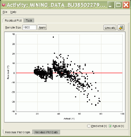

A residual plot is a scatter plot where the x-axis is the predicted value of x, and the y-axis is the residual for x. The residual is the difference between the actual value of x and the predicted value of x.
Figure 4-5 shows a residual plot for the regression results shown in Figure 4-4. Note that most of the data points are clustered around 0, indicating small residuals. However, the distance between the data points and 0 increases with the value of x, indicating that the model has greater error for people of higher ages.

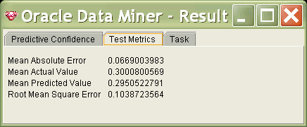

The Root Mean Squared Error and the Mean Absolute Error are commonly used statistics for evaluating the overall quality of a regression model. Different statistics may also be available depending on the regression methods used by the algorithm.
The Root Mean Squared Error (RMSE) is the square root of the average squared distance of a data point from the fitted line.
This SQL expression calculates the RMSE.
SQRT(AVG((predicted_value - actual_value) * (predicted_value - actual_value)))
This formula shows the RMSE in mathematical symbols. The large sigma character represents summation; j represents the current predictor, and n represents the number of predictors.
The Mean Absolute Error (MAE) is the average of the absolute value of the residuals (error). The MAE is very similar to the RMSE but is less sensitive to large errors.
This SQL expression calculates the MAE.
AVG(ABS(predicted_value - actual_value))
This formula shows the MAE in mathematical symbols. The large sigma character represents summation; j represents the current predictor, and n represents the number of predictors.
Oracle Data Miner calculates the regression test metrics shown in Figure 4-6.

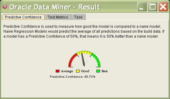

Oracle Data Miner calculates the predictive confidence for regression models. Predictive confidence is a measure of the improvement gained by the model over chance. If the model were "naive" and performed no analysis, it would simply predict the average. Predictive confidence is the percentage increase gained by the model over a naive model. Figure 4-7 shows a predictive confidence of 43%, indicating that the model is 43% better than a naive model.
