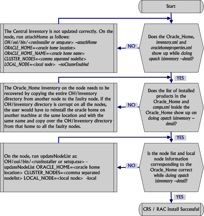

Troubleshooting Real Application Clusters / Oracle Clusterware Installation

After completing a Real Application Clusters installation, it is advisable that you perform the following tasks:
After your Oracle product with Real Application Clusters installation is complete, go to $ORACLE_HOME/Opatch on each node and execute the following command:
$ORACLE_HOME/OPatch/opatch lsinventory -detail
This command lists the components installed inside the Oracle home and also lists the local and remote nodes for the home. Verify this information. You may also want to look at installation logs inventory.xml and oraclehomeproperties.xml.
See "Troubleshooting Real Application Clusters / Oracle Clusterware Installation" in case the check fails.
