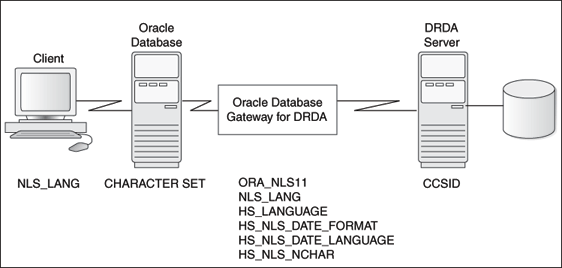

Figure E-1 illustrates Globalization Support interactions within your computer, including each component of your computer and the parameters of each component that affect Globalization Support processing in a distributed environment.
Figure E-1 Architecture of Globalization Support Interactions with Your System Components
Table E-1 describes the architecture illustrated in Figure E-1.
The table discusses describes in detail the parameters and variables needed for Globalization Support processing within each of your computer's environments: the client environment, the Oracle database, the gateway and the DRDA Server.
Parameters Needed for Globalization Support Processing in Your System's Environments
Table E-1 Parameters Needed for Globalization Support Processing in Your Systems Environments

A number of Globalization Support parameters control Globalization Support processing between the Oracle database and client. You can set language-dependent behavior defaults for the server, as well as for the client that overrides these defaults. For a complete description of Globalization Support parameters, refer to the Globalization Support chapter in the Oracle Database Administrator's Guide. These parameters do not directly affect gateway processing. However, you must ensure that the client character set (which is specified by the Oracle database NLS_LANG environment variable) is compatible with the character sets that you specify on the gateway and on the DRDA Server.
When you create an Oracle database, the character set that is used to store data is specified by the CHARACTER SET clause of the CREATE DATABASE statement. After the database is created, the database character set cannot be changed unless you re-create the database.
Normally, the default for CHARACTER SET is US7ASCII, which supports only the 26 Latin alphabetic characters. If you have specified 8-bit character sets on the gateway and the DRDA Server, then you must have a compatible 8-bit character set defined on your database. To check the character set of an existing database, issue the command:
SELECT USERENV('LANGUAGE') FROM DUAL;
For more information, refer to "Specifying Character Sets" in the Oracle Database Administrator's Guide.
Note that this does not mean that the gateway character set must be the same as the Oracle database character set. The Oracle Net facility performs implicit conversion between the Oracle database character set and the gateway character set.
During logon of the gateway to the DRDA Server, initial language information is exchanged between the gateway and the server. First, the gateway sends to the DRDA Server the CCSID in which it will be conversing. In the following example, the Oracle database character set WE8ISO8859P1 is mapped to CCSID 819 (an ASCII Code Page). This CCSID is sent to the DRDA Server. The DRDA Server responds with the CCSID in which it will be conversing. This will be the CCSID with which the DB2 database was generated. Also in the following example, this is CCSID 500, an EBCDIC Code Page. Figure E-2, "Gateway Language Interaction with DRDA Server", illustrates this process.
A DB2 instance maps unknown CCSIDs using the SYSIBM.SYSSTRINGS table. This table has different names for the various DB2 versions. It is possible to add additional character set mappings to this table by using DB2 utilities. Refer to the DB2 Installation documentation for details.
The setting of the HS_LANGUAGE parameter in the gateway initsid.ora determines which CCSID is used by the gateway for the conversation. Similarly, the setting of the HS_NLS_NCHAR parameter determines which CCSID is used by the gateway for GRAPHIC data interchange. For the list of supported ASCII-based Oracle database character sets that are mapped to CCSIDs, refer to "Gateway Codepage Map Facility" .
Note that it is not necessary for the gateway character set to be the same as the Oracle database character set. In many cases, it is not feasible to set the gateway character set equal to the Oracle database character set because the DRDA Server does not have a valid translation for it. Instead, choose a character set that haves the complete intersection with the character set that is used by the DRDA Server. The Oracle Net facility do as any translation between the gateway character set and the Oracle database character set.
