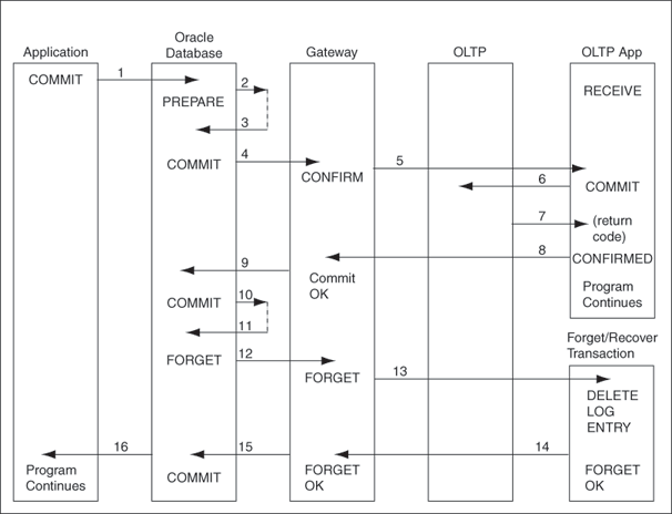

The flow of control for a successful commit between an Oracle application and an OLTP transaction is described in the following section and illustrated in Figure 5-1, "Commit-Confirm Flow with Synclevel 1". The figure assumes that both Oracle and OLTP resources have been updated. The following steps in Section 5.6.1 outline the commit-confirm logic flow.
The application issues a COMMIT
to the Oracle database.
The Oracle database sends PREPARE
to each participant in the distributed transaction other than the gateway.
Each participant prepares its database updates and responds PREPARE OK
The Oracle database sends COMMIT
to the gateway. The gateway receives the COMMIT
from the Oracle database and inserts a new pending transaction row into the PGA_CC_PENDING
table.
The gateway sends an APPC CONFIRM
to the OLTP application. The OLTP application receives the CONFIRM
request in the form of a status from the last APPC RECEIVE
The OLTP application issues a COMMIT
using an appropriate OLTP function. The OLTP commits all database updates made by the application since the last COMMIT
, including the commit-confirm transaction log update.
Once the database updates have been committed, the OLTP returns control to the application with a return code indicating the status of the COMMIT
The OLTP application sends an APPC CONFIRMED
to the gateway.
The gateway receives the CONFIRMED
and returns COMMIT OK
Each participant commits its database updates and responds COMMIT OK
The Oracle database sends a FORGET
to the gateway.
The gateway receives the FORGET
and starts a new APPC conversation with the FORGET/RECOVERY
transaction at the OLTP, sends it a FORGET
request and an APPC CONFIRM
. The FORGET/RECOVERY
transaction receives the FORGET
request and deletes the entry from the commit-confirm transaction log for the current Oracle transaction, and commits the delete.
The FORGET/RECOVERY
transaction sends an APPC CONFIRMED
to the gateway to indicate that the FORGET
was processed, and then terminates. The gateway receives the CONFIRMED
and deletes the pending transaction row from the PGA_CC_PENDING
table.
The gateway returns FORGET OK
The Oracle database returns control to the Oracle application.
Figure 5-1, "Commit-Confirm Flow with Synclevel 1" illustrates the Commit-Confirm logic flow described in the previous section.
Figure 5-1 Commit-Confirm Flow with Synclevel 1
