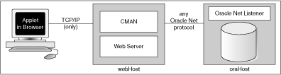

However, a Web server and database server both require many resources. You seldom find both servers running on the same computer. Usually, your applet connects to a database on a host other than the one on which the Web server runs. If you want your applet to connect to a database running on a different computer, then you have the following options:
Use the Oracle Connection Manager on the host computer. The applet can connect to the Connection Manager, which connects to a database on another computer.
Your applet can also take advantage of the data encryption and integrity checksum features of the Advanced Security option of Oracle Database.
If you are connecting to a database on a host other than the one on which the Web server is running, then you must overcome applet security restrictions. You can do this in the following ways:
The Oracle Connection Manager is a lightweight, highly scalable program that can receive Oracle Net packets and retransmit them to a different server. To a client running Oracle Net, the Connection Manager looks exactly like a database server. An applet that uses the JDBC Thin driver can connect to a Connection Manager running on the Web server host and have the Connection Manager redirect the Oracle Net packets to an Oracle server running on a different host.
Figure 5-1 illustrates the relationship between the applet, the Oracle Connection Manager, and the database.
Figure 5-1 Applet, Connection Manager, and Database Relationship

The following text describes how to write the URL in your applet, so that the applet connects to the Connection Manager and the Connection Manager connects with the database. In the URL, you specify an address list that lists the protocol, port, and name of the Web server host on which the Connection Manager is running, followed by the protocol, port, and name of the host on which the database is running.
The following example describes the configuration illustrated in Figure 5-1. The Web server on which the Connection Manager is running is on host webHost and is listening on port 1610. The database to which you want to connect is running on host oraHost, listening on port 1521, and SID ORCL. You write the URL in TNS keyword-value format:
String myURL =
"jdbc:oracle:thin:@(description=(address_list=
(address=(protocol=tcp)(port=1610)(host=webHost))
(address=(protocol=tcp)(port=1521)(host=oraHost)))
(connect_data=(INSTANCE_NAME=orcl))
(source_route=yes))";
OracleDataSource ods = new OracleDataSource();
ods.setURL(myURL);
ods.setUser("scott");
ods.setPassword("tiger");
Connection conn = ods.getConnection();
The first element in the address_list entry represents the connection to the Connection Manager. The second element represents the database to which you want to connect. The order in which you list the addresses is important.
When your applet uses a URL, such as the preceding one, it will function exactly as if it were connected directly to the database on the host oraHost.
