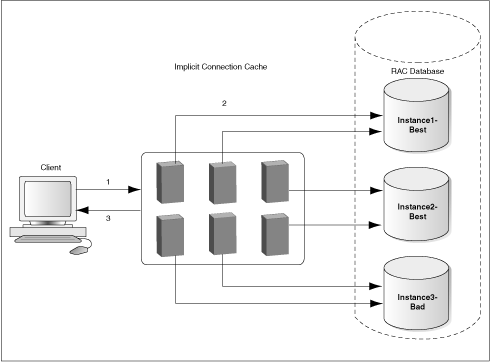

In an Oracle Real Application Clusters environment, a connection could belong to any instance that provides the relevant service. In the best case, all instances perform equally well and randomly retrieving a connection from the cache is appropriate. However, when one instance performs better than others, random selection of a connection is inefficient. The run-time connection load balancing feature enables routing of work requests to an instance that offers the best performance, minimizing the need to relocate work.
Figure 22-1 illustrates run-time connection load balancing. When run-time connection load balancing is enabled on the implicit connection cache, the following steps occur:
A client requests a connection from the connection cache by calling the getConnection
method on the DataSource
object.
The run-time connection load balancing mechanism selects the connection that belongs to the best instance from the connection cache. In Figure 22-1, this could be either Instance1 or Instance2.
The client receives the connection that would process the work request with the best response time.
Figure 22-1 Run-Time Connection Load Balancing
