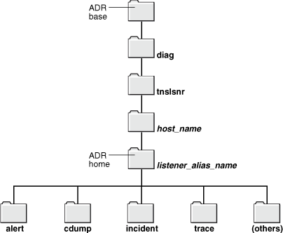

The ADR Home is the unit of the ADR directory that is assigned to an instance of an Oracle product. Each database instance will have its own ADR Home. Similarly, each listener, connection manager (CMAN), and client instance will have its own ADR Home.
The location of an ADR Home is given by the following path, which starts at the ADR base directory:
diag/product_type/product_id/instance_id
Table 16-1 lists the values of the various path components for an Oracle Net Listener instance.
Table 16-1 ADR Home Path Components for an Oracle Net Listener Instance
| Path Component | Value for Oracle Net Listener |
product_type
 | tnslsnr |
product_id
 | host name |
instance_id
 | listener alias name |
Figure 16-1 illustrates the directory hierarchy of the ADR for an Oracle Net Listener instance. Other ADR homes for other Oracle products or components (such as ASM or Oracle Database) can exist within this hierarchy, under the same ADR base.
Figure 16-1 Directory Structure for an Oracle Net Listener Instance

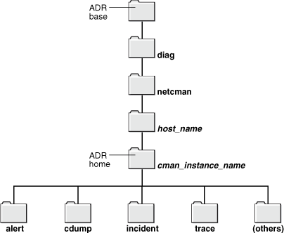

Table 16-2 lists the values of the various path components for a CMAN instance.
Table 16-2 ADR Home Path Components for a CMAN Instance
product_type
 | netcman |
product_id
 | host name |
instance_id
 | CMAN instance name |
Within the ADR Home directory are subdirectories where each instance (be it database, listener, CMAN, or client) stores diagnostic data. Table 16-3 lists some of these subdirectories and their contents.
Figure 16-2 illustrates the directory hierarchy of the ADR for a CMAN instance. Other ADR homes for other Oracle products or components (such as ASM or Oracle Database) can exist within this hierarchy, under the same ADR base.
Figure 16-2 Directory Structure for a CMAN Instance
Table 16-3 ADR Home Subdirectories
| Subdirectory Name | Contents |
| alert | The XML-formatted alert log |
| cdump | Core files |
| incident | Multiple subdirectories, where each subdirectory is named for a particular incident, and where each contains dumps pertaining only to that incident |
| trace | Background and server process trace files and SQL trace files |
| (others) | Other subdirectories of ADR Home, which store incident packages, health monitor reports, and other information |
