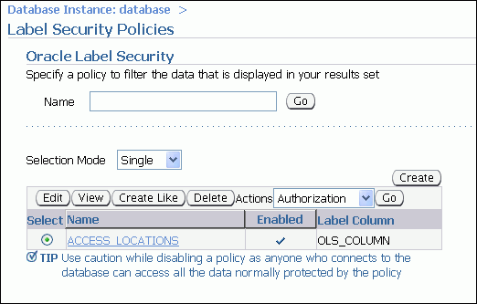

You begin by defining a policy name, label column, and enforcement options for the policy.
To create a policy with default policy enforcement options:
Log in to Oracle Enterprise Manager Database Control using the LBACSYS account.
Click the Server tab.
Click Oracle Label Security under Security. The Label Security Policies page appears.
Click Create to start creating a new label security policy.
The Create Label Security Policy page appears.
Define the policy's name, label column, and the default policy enforcement options.
Name: Enter a name for the policy, for example, ACCESS_LOCATIONS.
Label Column: Enter a name for the label column, for example, OLS_COLUMN. Later on, when you apply the policy to a table, the label column is added to that table. By default, the data type of the policy label column is NUMBER(10). You can also use an existing table column of the NUMBER(10) data type as the label column.
Hide Label Column: Select to hide the column. When you first create the policy, you may want to disable Hide Label Column during the development phase of the policy. When the policy is satisfactory and ready for use by users, hide the column so that it is transparent to applications.
Enabled: Toggle to enable or disable the policy.
Enforcement Options: The default policy enforcement options are used when the policy is applied. Ensure that these meet the needs of the application to which you are applying the policy.
Select from the following options:
Apply No Policy Enforcements (NO_CONTROL)
Apply Policy Enforcements
For all queries (READ_CONTROL)
For Insert operations (INSERT_CONTROL)
For Update Operations (UPDATE_CONTROL)
Use session's default label for label column update (LABEL_DEFAULT)
Operations that update the label column (LABEL_UPDATE)
Update and Insert operations so that they are read accessible (CHECK_CONTROL)
Click OK.
The new policy appears in the Oracle Label Security Policies page.

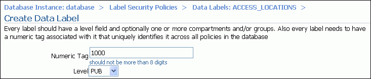

You are now ready to create data labels for the policy. Each data label must have exactly one level associated with it. You can optionally add one or more compartments and groups to the label.
To create a data label, you need to assign a numeric tag to the label. Later on, the tag number will be stored in the security column when you apply the policy to a table. The label tag is not linked to the sensitivity (level) of the label. It is only used to identify the label.
To create data labels for each level:
In the Label Security Policies page, select the policy that needs to have labels linked to levels.
In the Actions box, select Data Labels. Click Go.
The Data Labels page appears.
The Create Data Label page appears.
Enter the following information:
Numeric Tag: Enter a number that uniquely identifies the label. This number should be unique across all policies.
Level: Select a level from the list.
You can optionally select Compartments to add to the label. To add compartments, click Add under Compartments. Select the compartments to be added to the label. Click Select to add the compartments.
You can optionally select Groups to add to the label. To add groups, click Add under Groups. Select the groups to be added to the label. Click Select to add the groups.
Click OK in the Create Data Label page.
The data label appears in the Data Labels page.

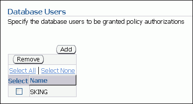

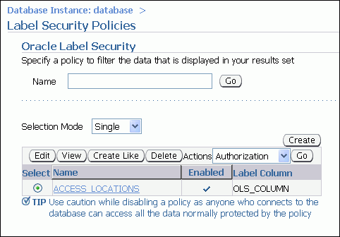

To authorize users for the OLS policy:
In the Label Security Policies page, select the policy that needs authorization.
In the Actions box, select Authorization. Click Go.
The Create User page appears.
Add users as follows:
Under Database Users, click Add. In the Search and Select window, select users that you want and then click Select.
Under Non Database Users, click Add 5 Rows, and then add the user names of the non-database users that you want to add. Most application users are considered non-database users. A non-database user does not exist in the database. This can be any user name that meets the Oracle Label Security naming standards and can fit into the VARCHAR2(30) length field. However, be aware that Oracle Database does not automatically configure the associated security information for the non-database user when the application connects to the database. In this case, the application needs to call an Oracle Label Security function to assume the label authorizations of the specified user who is not a real database user.

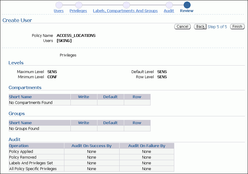

The Labels, Compartments, and Groups step appears.
Next, you need to create the user label for the user. Under Levels, use the flashlight icon to select data to enter for the following fields:
Maximum Level: Enter the highest level for read and write access for this user.
Minimum Level: Enter the lowest level for write access.
Default Level: Enter the default level when the user logs in.
This value is equal to or greater than the minimum level and equal to or less than the maximum level.
Row Level: Enter the level given to the row when user writes to the table.
Click Add under Compartments, to add compartments to the user label. Select the compartments to add. Click Select.
For each compartment that you add, you can select the following properties:
Write: Allows the user to write to data that has the compartment as part of it's label
Default: Adds the compartment to the user's default session label
Row: Adds the compartment to the data label when the user writes to the table
Click Add under Groups, to add groups to the user label. Select the groups and click Select.
For each group that you add, you can select the following properties:
Write: Allows the user to write to data that has the group as part of it's label
Default: Adds the group to the user's default session label
Row: Adds the group to the data label when the user writes to the table
Click Next.
The Audit step appears.
Next, you can choose to set the policy audit options for the selected user. You can set audit options for the following operations:
Policy Applied:
Audit On Success By audits successful application of the policy to a table or schema. Select ACCESS to audit by access or SESSION to audit by session.
Audit On Failure By audits failed application of the policy to a table or schema. Select ACCESS to audit by access or SESSION to audit by session.
Policy Removed:
Audit On Success By audits successful removal of the policy from a table or schema. Select ACCESS to audit by access or SESSION to audit by session.
Audit On Failure By audits failed removal of the policy from a table or schema. Select ACCESS to audit by access or SESSION to audit by session.
Labels And Privileges Set:
Audit On Success By audits successful setting of user authorizations and privileges. Select ACCESS to audit by access or SESSION to audit by session.
Audit On Failure By audits failed setting of user authorizations and privileges. Select ACCESS to audit by access or SESSION to audit by session.
All Policy Specific Privileges:
Audit On Success By audits successful use of policy privileges. Select ACCESS to audit by access or SESSION to audit by session.
Audit On Failure By audits failed use of policy privileges. Select ACCESS to audit by access or SESSION to audit by session.
Click Next.
You can review the policy authorization settings. Click Finish to create the policy authorization. Alternatively, you can click Back to modify the authorization settings.

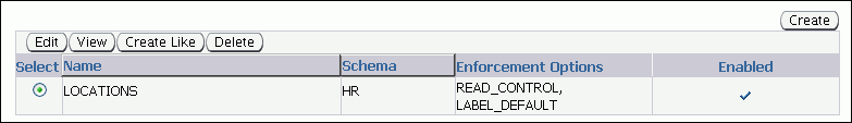

Next, apply the OLS policy to a database table.
To apply the policy to a database table:
In the Label Security Policies page, select the policy that needs to be applied to a table.
Select Apply from the Actions box. Click Go.
The Apply page appears.
Select the Tables tab to apply the policy to a table.
Select the Schemas tab if you are applying the policy to a schema.The process is same as applying the policy to a table.Click Create.
The Add Table page appears.
Next to the Table box, click the flashlight icon.
In the Search and Select window, enter the following information under Search:
Schema: Enter the name of the schema in which the table appears. Leaving this field empty displays tables in all schemas.
Name: Optionally, enter the name of the table. Leaving this box empty displays all the tables within the schema.
To narrow the search by using wildcards, use the percent (%) sign. For example, enter O% to search for all tables beginning with the letter O.
Select the table and click Select.
Policy Enforcement Options: Select enforcement options as needed. These options will apply to the table on top of the enforcement options that you selected when you created the policy in Step 1: Creating the Policy.
To make no change from those enforcement options, that is, to use the same enforcement options created earlier, select Use Default Policy Enforcement. To add more enforcement options, select from the other options listed.
Labeling Function: Optionally, specify a labeling function to automatically compute the label to be associated with a new or updated row. That function is always invoked thereafter to provide the data labels written under that policy, because active labeling functions take precedence over any alternative means of supplying a label.

Return to the Label Security Policies page by selecting the Label Security Policies link.
Select the ACCESS_LOCATIONS policy.
Select Authorization from the Actions box. Click Go.

Click Add.
Numeric Tag: Enter 1000.
Level: From the list, select PUB.
Click OK.

Click Add.
The Search and Select window appears.
Select the check box for user SKING and then click Select.
The Create User page lists user SKING.
Click Next.

Set the following levels for the user SKING:
Maximum Level: SENS (for SENSITIVE)
Minimum Level: CONF (for CONFIDENTIAL)
Default Level: SENS
Row Level: SENS
This allows SKING to read CONFIDENTIAL and SENSITIVE data.
Click Next.
Ensure that all of the audit operations are set to None, and then click Next.
The Review step appears.
The Review step lists all the authorization settings you have selected. Ensure that the settings are correct, and then click Finish.

Ensure that the Tables tab is selected. Click Create.
In the Table field, enter HR.LOCATIONS .
Ensure that the Hide Policy Column check box is not selected.
Ensure that the Enabled check box is selected.
Under Policy Enforcement Options, select Use Default Policy Enforcement.
The default policy enforcement options for ACCESS_LOCATIONS are:
Click OK.
The ACCESS_LOCATIONS policy is applied to the HR.LOCATIONS table.
