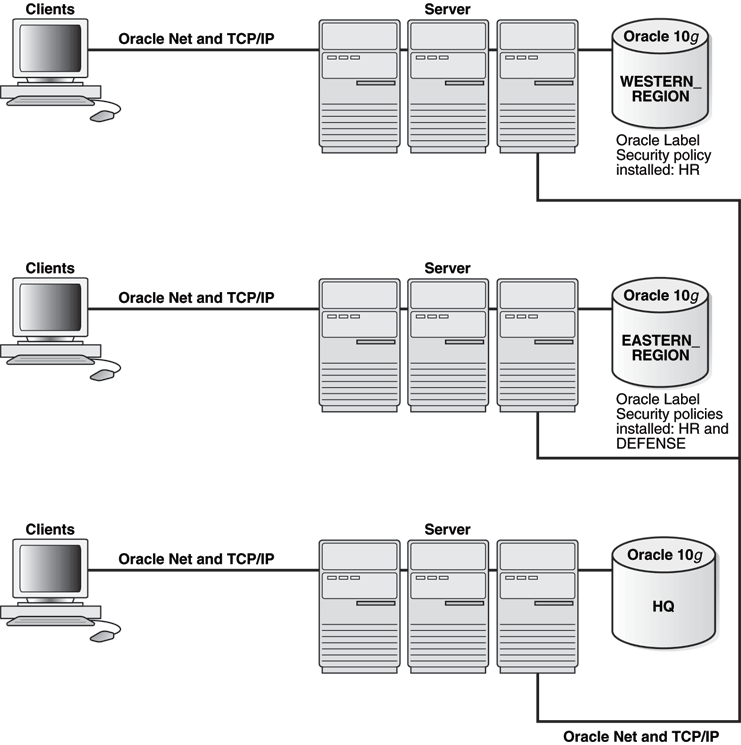

A network configuration that supports distributed databases can include multiple Oracle Database servers, or other database servers, running on the same or different operating systems. Each cooperative server in a distributed system communicates with other clients and servers over a network.
Figure 13-1, "Using Oracle Label Security with a Distributed Database" illustrates a distributed database that includes clients and servers with and without Oracle Label Security. As described in this chapter, if you establish database links from the WESTERN_REGION database to the EASTERN_REGION database, then you can access data if your userid on EASTERN_REGION is authorized to see it, even if locally (on WESTERN_REGION) you do not have this access.
Figure 13-1 Using Oracle Label Security with a Distributed Database
Distributed databases act in the standard way with Oracle Label Security: the local user ends up connected as a particular remote user. Oracle Label Security protects the labeled data, whether you connect locally or remotely. If the remote user has the proper labels, then you can access the data. If not, then you cannot access the data.
The database link sets up the connection to the remote database and identifies the user who will be associated with the remote session. Your Oracle Label Security authorizations on the remote database are based on those of the remote user identified in the database link.
For example, local user JANE might connect as remote user AUSTEN, in the database referenced by the connect string sales, as follows:

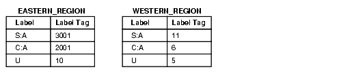

It is advisable to use the same label component definitions and label tags on any database that is to be protected by the policy.
In a distributed environment, you may choose to use the same label tags across multiple databases. However, if you choose not to use the same tags across multiple databases, then you should retrieve the character form of the label when performing remote operations. This will ensure that the labels are consistent.
In the following example, the character string representation of the label string is the same. However, the label tag does not match. If the retrieved label tag has a value of 11 on the WESTERN_REGION database but a tag of 2001 on the EASTERN_REGION database, then the tags have no meaning. Serious consequences can result.
Figure 13-2 Label Tags in a Distributed Database
When retrieving labels from a remote system, you should return the character string representation (rather than the numeric label tag), unless you are using the same numeric labels on both databases.
If you allow Oracle Label Security to automatically generate labels on different databases, then the label tags will not be identical. Character strings will have meaning, but the numeric values will not, unless you have predefined labels with the same label tags on both instances.
To avoid the complexities of label tags, you can convert labels to strings on retrieval (using LABEL_TO_CHAR) and use CHAR_TO_LABEL when you store labels. Operations will succeed as long as the component names are the same.

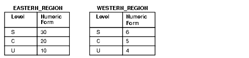

In a distributed environment, you should use the same relative ranking of the numeric form of the level component, to ensure proper sorting of the labels.
In the following example, the levels in the two databases are effectively the same. Although the numeric form is different, the relative ranking of the levels numeric form is the same. As long as the relative order of the components is the same, the labels are perceived as identical.

Oracle Label Security supports all standard Oracle Database distributed configurations. Whether or not you can access protected data depends on the policies installed in each distributed database.
Be sure to take into account the relationships between databases in a distributed environment:
If the same application runs on two databases and you want them to have the same protection, then syou must apply the same Oracle Label Security policy to both the local and the remote databases.
If the local and remote databases have a policy in common, then your local session label and row label will override the default labels for the remote user.
If the remote database has a different policy than the local database, then the remote policy can restrict access to the data independent of your local policies. On the other hand, when you make a connection as a remote user who has authorization on the remote policy, you can access any data to which the remote user has access to, regardless of your local authorizations.
If the remote database has no policy applied to it, you can access its data just as you would with a standard distributed database.
Consider a situation in which three databases exist, with different Oracle Label Security policies in force:
Users authorized for Policy A can obtain protected data from Database 1 and Database 2. If the remote user is authorized for Policy C, then this user can obtain data from Database 3 as well.

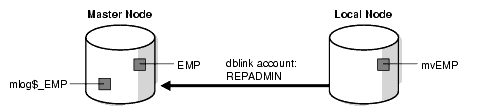

Oracle Database uses materialized views for replicating data. A materialized view is a local copy of a local or remote master table that reflects a recent state of the master table.
As illustrated in Figure 13-4, "Use of Materialized Views for Replication", a master table is a table you wish to replicate, on a node that you designate as the master node. Using a dblink account (such as REPADMIN), you can create a materialized view of the table in a different database. (This can also be done in the same database, and on the same system.) You can select rows from the remote master table, and copy them into the local materialized view. Here, mvEMP represents the materialized view of table EMP, and mlog$_EMP represents the materialized view log.
Figure 13-4 Use of Materialized Views for Replication
In a distributed environment, a materialized view alleviates query traffic over the network and increases data availability when a node is not available.
