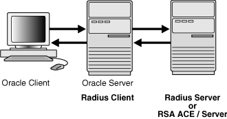

The Oracle/RADIUS environment is displayed in Figure 6-1:
Figure 6-1 RADIUS in an Oracle Environment
The Oracle database server acts as the RADIUS client, passing information between the Oracle client and the RADIUS server. Similarly, the RADIUS server passes information between the Oracle database server and the appropriate authentication servers. The authentication components are listed in Table 6-1:

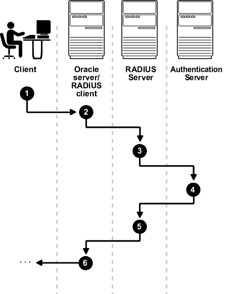

In the synchronous mode, RADIUS lets you use various authentication methods, including passwords and SecurID token cards. Figure 6-2 shows the sequence in which synchronous authentication occurs:
Figure 6-2 Synchronous Authentication Sequence
Following steps describe the Synchronous Authentication Sequence:
A user logs in by entering a connect string, pass code, or other value. The client system passes this data to the Oracle database server.
The Oracle database server, acting as the RADIUS client, passes the data from the Oracle client to the RADIUS server.
The RADIUS server passes the data to the appropriate authentication server, such as Smart Card or SecurID ACE for validation.
The authentication server sends either an Access Accept or an Access Reject message back to the RADIUS server.
The RADIUS server passes this response to the Oracle database server/RADIUS client.
The Oracle database server/RADIUS client passes the response back to the Oracle client.

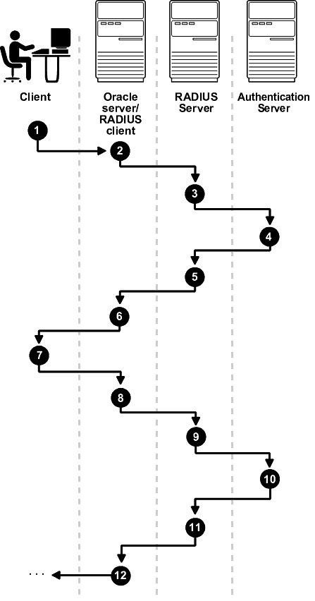

When the system uses the asynchronous mode, the user does not need to enter a user name and password at the SQL*Plus CONNECT string. Instead, a graphical user interface asks the user for this information later in the process.
Figure 6-3 shows the sequence in which challenge-response (asynchronous) authentication occurs.
If the RADIUS server is the authentication server, Steps 3, 4, and 5, and Steps 9, 10, and 11 in Figure 6-3 are combined.Figure 6-3 Asynchronous Authentication Sequence
Following steps describe the Asynchronous Authentication Sequence:
A user seeks a connection to an Oracle database server. The client system passes the data to the Oracle database server.
The RADIUS server passes the data to the appropriate authentication server, such as a Smart Card, SecurID ACE, or token card server.
The authentication server sends a challenge, such as a random number, to the RADIUS server.
The RADIUS server passes the challenge to the Oracle database server/RADIUS client.
The Oracle database server/RADIUS client, in turn, passes it to the Oracle client. A graphical user interface presents the challenge to the user.
The user provides a response to the challenge. To formulate a response, the user can, for example, enter the received challenge into the token card. The token card provides a dynamic password that is entered into the graphical user interface. The Oracle client passes the user's response to the Oracle database server/RADIUS client.
The Oracle database server/RADIUS client sends the user's response to the RADIUS server.
The RADIUS server passes the user's response to the appropriate authentication server for validation.
The RADIUS server passes the response to the Oracle database server/RADIUS client.
The Oracle database server/RADIUS client passes the response to the Oracle client.

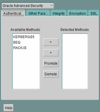

Use Oracle Net Manager to configure RADIUS on the Oracle client (See "Starting Oracle Net Manager"):
Navigate to the Oracle Advanced Security profile (For details, refer to "Navigating to the Oracle Advanced Security Profile") The Oracle Advanced Security tabbed window is displayed (Figure 6-4):
Figure 6-4 Oracle Advanced Security Authentication Window
Click the Authentication tab.
From the Available Methods list, select RADIUS.
Select the right-arrow (>) to move RADIUS to the Selected Methods list. Move any other methods you want to use in the same way.
Arrange the selected methods in order of required usage by selecting a method in the Selected Methods list, and clicking Promote or Demote to position it in the list. For example, put RADIUS at the top of the list for it to be the first service used.
Select File, Save Network Configuration.

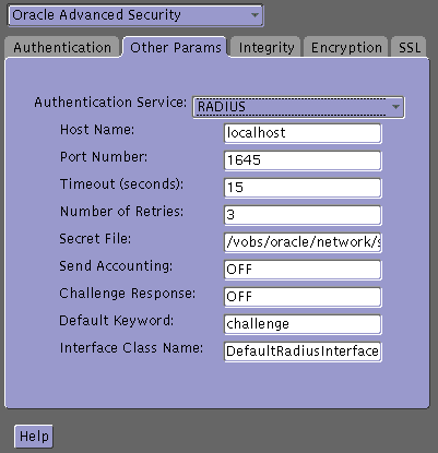

Click Other Params as shown in (Figure 6-5):
Figure 6-5 Oracle Advanced Security Other Params Window
From the Authentication Service list, select RADIUS.
In the Host Name field, accept the localhost as the default primary RADIUS server, or enter another host name.
Ensure that the default value of the Secret File field is valid.

Navigate to the Oracle Advanced Security profile (See "Navigating to the Oracle Advanced Security Profile") The Oracle Advanced Security tabbed window is displayed. (Figure 6-5).
Click the Other Params tab.
Change the default setting for any of the following fields:
| Field | Description |
| Port Number | Specifies the listening port of the primary RADIUS server. The default value is 1645. |
| Timeout (seconds) | Specifies the time the Oracle database server waits for a response from the primary RADIUS server. The default is 15 seconds. |
| Number of Retries | Specifies the number of times the Oracle database server resends messages to the primary RADIUS server. The default is three retries. For instructions on configuring RADIUS accounting, see: Task 5: Configure RADIUS Accounting. |
| Secret File | Specifies the location of the secret key on the Oracle database server. The field specifies the location of the secret key file, not the secret key itself. For information about specifying the secret key, see: Create the RADIUS Secret Key File on the Oracle Database Server. |

Use Oracle Net Manager to enable or disable RADIUS accounting (See "Starting Oracle Net Manager"):
Navigate to the Oracle Advanced Security profile. (See "Navigating to the Oracle Advanced Security Profile") The Other Params window is displayed (Figure 6-5).
In the Send Accounting field, enter ON to enable accounting or OFF to disable accounting.
The sqlnet.ora file is updated with the following entry:
SQLNET.RADIUS_SEND_ACCOUNTING= ON
