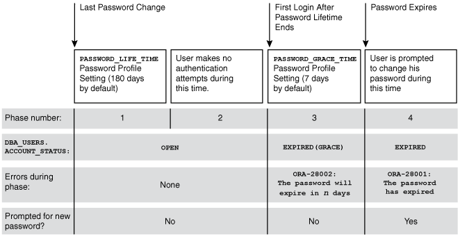

Figure 3-1 shows the life cycle of the password lifetime and grace period.
Phase 1: After the user account is created, or the password of an existing account is changed, the password lifetime period begins.
Phase 2: This phase represents the period of time after the password lifetime ends but before the user logs in again with the correct password. The correct credentials are needed for Oracle Database to update the account status. Otherwise, the account status will remain unchanged. Oracle Database does not have any background process to update the account status. All changes to the account status are driven by the Oracle Database server process on behalf of authenticated users.
Phase 3: When the user finally does log in, the grace period begins. Oracle Database then updates the DBA_USERS.EXPIRY_DATE column to a new value using the current time plus the value of the PASSWORD_GRACE_TIME setting from the account's password profile. At this point, the user receives an ORA-28002 warning message about the password expiring in the near future (for example, ORA-28002 The password will expire within 7 days if PASSWORD_GRACE_TIME is set to 7 days), but the user can still log in without changing the password. The DBA_USERS.EXPIRY_DATE column shows the time in the future when the user will be prompted to change their password.
Phase 4: After the grace period (Phase 3) ends, the ORA-28001: The password has expired error appears, and the user is prompted to change the password after entering the current, correct password before the authentication can proceed. If the user has an Oracle Active Data Guard configuration, where there is a primary and a stand-by database, and the authentication attempt is made on the standby database (which is a read-only database), then the ORA-28032: Your password has expired and the database is set to read-only error appears. The user should log into the primary database and change the password there.
During any of these four phases, you can query the DBA_USERS data dictionary view to find the user's account status in the DBA_USERS.ACCOUNT_STATUS column.

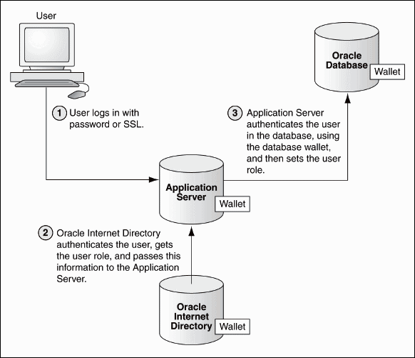

To configure Secure Sockets Layer (SSL) authentication for administrative users:
Configure the client to use SSL:
Configure the client wallet and user certificate. Update the wallet location in the sqlnet.ora configuration file.
You can use Wallet Manager to configure the client wallet and user certificate. See Oracle Database Advanced Security Administrator's Guide for more information.
Configure the Oracle net service name to include server DNs and use TCP/IP with SSL in tnsnames.ora.
Configure TCP/IP with SSL in listener.ora.
Set the client SSL cipher suites and the required SSL version, and then set SSL as an authentication service in sqlnet.ora.
Configure the server to use SSL:
Enable SSL for your database listener on TCPS and provide a corresponding TNS name. You can use Net Configuration Assistant to configure the TNS name.
Store the database PKI credentials in the database wallet. You can use Wallet Manager do this.
Set the LDAP_DIRECTORY_ACCESS initialization parameter to SSL:
ALTER SYSTEM SET LDAP_DIRECTORY_ACCESS = SSL;
See Oracle Database Reference for more information about LDAP_DIRECTORY_ACCESS.
Configure Oracle Internet Directory for SSL user authentications.
See Oracle Database Enterprise User Security Administrator's Guide for information on configuring enterprise user security SSL authentication.
In Oracle Internet Directory, grant the SYSDBA or SYSOPER privilege to the user for the database that the user will administer.
On the server computer, set the LDAP_DIRECTORY_SYSAUTH initialization parameter to YES.
ALTER SYSTEM SET LDAP_DIRECTORY_SYSAUTH = YES;
When set to YES, the LDAP_DIRECTORY_SYSAUTH parameter enables SYSDBA and SYSOPER users to authenticate to the database by using a strong authentication method. See Oracle Database Reference for more information about LDAP_DIRECTORY_SYSAUTH.

Figure 3-2 shows an example of multitier authentication.
The following actions take place:
The user logs on using a password or Secure Sockets Layer. The authentication information is passed through Oracle Application Server.
Oracle Internet Directory authenticates the user, gets the roles associated with that user from the wallet, and then passes this information back to Oracle Application Server.
Oracle Application Server checks the identity of the user in Oracle Database, which contains a wallet that stores this information, and then sets the role for that user.

For enterprise users or database users, Oracle Call Interface, JDBC/OCI, or Thin driver enables a middle tier to set up several user sessions within a single database connection, each of which uniquely identifies a connected user (connection pooling). These sessions reduce the network overhead of creating separate network connections from the middle tier to the database.
If you want to authenticate from clients through a middle tier to the database, the full authentication sequence from the client to the middle tier to the database occurs as follows:
The client authenticates to the middle tier, using whatever form of authentication the middle tier will accept. For example, the client could authenticate to the middle tier by using a user name and password or an X.509 certificate by means of SSL.
The middle tier authenticates itself to the database by using whatever form of authentication the database accepts. This could be a password or an authentication mechanism supported by Oracle Advanced Security, such as a Kerberos ticket or an X.509 certificate (SSL).
The middle tier then creates one or more sessions for users using OCI, JDBC/OCI, or Thin driver.
If the user is a database user, then the session must, as a minimum, include the database user name. If the database requires it, then the session can include a password (which the database verifies against the password store in the database). The session can also include a list of database roles for the user.
If the user is an enterprise user, then the session may provide different information depending on how the user is authenticated.
Example 1: If the user authenticates to the middle tier using SSL, then the middle tier can provide the DN from the X.509 certificate of the user, or the certificate itself in the session. The database uses the DN to look up the user in Oracle Internet Directory.
Example 2: If the user is a password-authenticated enterprise user, then the middle tier must provide, as a minimum, a globally unique name for the user. The database uses this name to look up the user in Oracle Internet Directory. If the session also provides a password for the user, then the database will verify the password against Oracle Internet Directory. User roles are automatically retrieved from Oracle Internet Directory after the session is established.
The middle tier may optionally provide a list of database roles for the client. These roles are enabled if the proxy is authorized to use the roles on behalf of the client.
The database verifies that the middle tier has the privilege to create sessions on behalf of the user.
