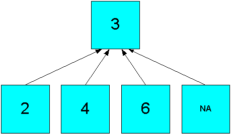

The hierarchical operators include null values in the count of cells. In Figure 9-3, the Hierarchical Average operator produces an aggregate value of ((2 + 4 + 6 +NA)/4)=3.
Figure 9-3 Hierarchical Average Aggregation in a Simple Hierarchy

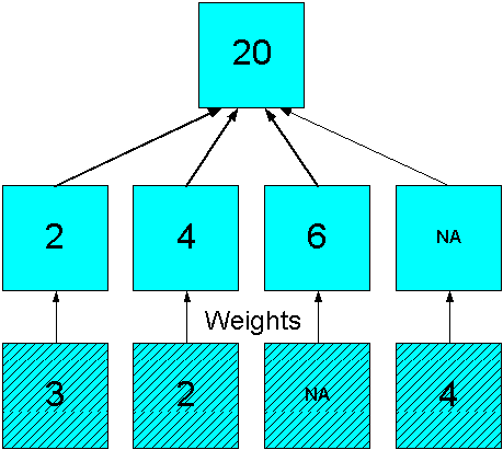

The weighted operators use the values in another measure to generate weighted values before performing the aggregation. Figure 9-4 shows how the simple sum of 12 in Figure 9-1 changes to 20 by using weights ((3*2) + (2*4) + (NA*6) +(4*NA)).
Figure 9-4 Weighted Sum Aggregation in a Simple Hierarchy

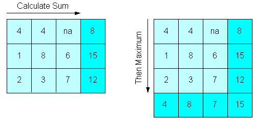

Even though you can use the Sum and Maximum operators alone without ordering the dimensions, you cannot use them together without specifying the order. The following figures show how they calculate different results depending on the order of aggregation. Figure 9-5 shows a cube with two dimensions. Sum is calculated first across one dimension of the cube, then Maximum is calculated down the other dimension.
Figure 9-5 Sum Method Followed by Maximum Method

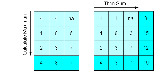

Figure 9-6 shows the same cube, except Maximum is calculated first down one dimension of the cube, then Sum is calculated across the other dimension. The maximum value of the sums in Figure 9-5 is 15, while the sum of the maximum values in Figure 9-6 is 19.
Figure 9-6 Max Method Followed by Sum Method

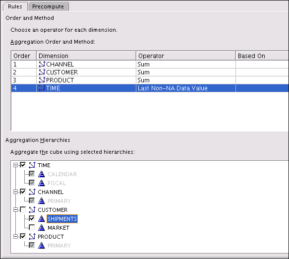

This example describes changes to the default aggregation of the Units cube in the GLOBAL analytic workspace. These changes will take effect in the next data refresh.
Analytic Workspace Manager initially sets all dimensions to use the Sum operator and aggregates all levels of all dimensions. To change these default settings, use the Rules subtab of the Aggregation tab.
Figure 9-7 shows the operators for the Units Cube. Time is now set to Last Non-NA Data Value, and it will be aggregated after the other dimensions. For operators like First and Last, the order in which the dimensions are aggregated can change the results.
Another change is that only the Shipments hierarchy of the Customer dimension will be aggregated during data maintenance. Because the Segment hierarchy is seldom queried, the Global DBA chose not to calculate these aggregate values in order to save maintenance time and storage space. However, response time will be slower for queries that request Segment aggregations.
Figure 9-7 Selecting the Aggregation Operators

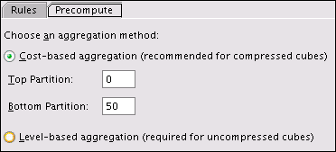

Analytic Workspace Manager initially chooses cost-based aggregation with 20% precomputed values for the bottom partitions and 0% for the top partition. An unpartitioned cube is also set to 20%. This setting means that 20% of the aggregate values will be calculated and stored during data maintenance, and 80% will be calculated in response to a query. These settings optimize data maintenance.
Increasing the materialization of the bottom partitions improves querying of both the bottom and the top partitions. Increasing the materialization of the top partition improves querying of the most aggregate data and any other hierarchies of the partitioned dimension.
Figure 9-8 shows the settings for the Units Cube. In this case, the Global DBA chose to keep the top partition at 0%, and to increase the bottom partitions from 20 to 50%. This change will increase maintenance costs in time and storage space, but will improve runtime performance of all partitions.
Figure 9-8 Setting Cost-Based Presummarization
