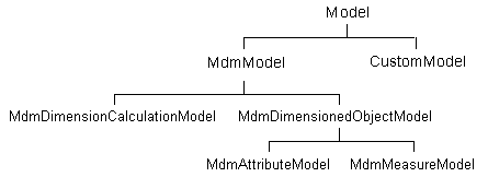

Figure 5-1 illustrates the class hierarchy of the Model
interface and the classes that implement it. The oracle.olapi.metadata.mdm.MdmModel
class implements the Model
interface for MdmObject
objects. Another implementation of the Model
interface is the CustomModel
class in the oracle.olapi.data.source
package.
