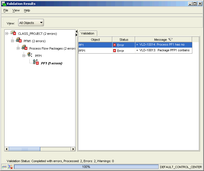

In Warehouse Builder, you can validate all objects by selecting the objects from the console tree and then selecting Validate from the Object menu. After the validation is complete, the validation messages are displayed in the Validation Results window, as shown in Figure 28–1.
You can also validate mappings from the Mapping Editor by selecting Mapping, then Validate. The validation messages and errors are displayed in the Validation Results window.
On the Validation tab of the Validation Results window, double-click an object name in the Object column to display the editor for that object. You can fix errors in the editor. Double-click a message in the Message column to display the detailed error message in a message editor window. To save the message to your local system, select Code in the menu bar, then select Save as File.
Warehouse Builder saves the last validation messages for each previously validated objects. You can access these messages at any time by selecting the object from the console tree in the Project Explorer, select View from the menu bar, and then click Validation Messages. The messages are displayed in the Validation Results window.

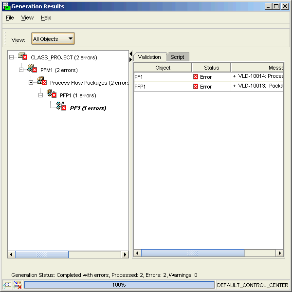

After you generate scripts for Warehouse Builder objects, the Generation Results window displays the generation results and errors, as shown in Figure 28–2. Double-click an error under the Messages column on the Validation tab to display a message editor that enables you to save the errors to your local system.
