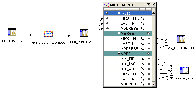

Because the Match-Merge operator only accepts SQL input, you cannot map the output of the Name and Address operator directly to the Match-Merge operator. You must use a staging table.
Because the Match-Merge generates only PL/SQL, you cannot map the Merge or XREF output groups of the Match-Merge operator to a SQL only operator such as a Sort operator or another Match-Merge operator.

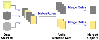

Matching determines which records refer to the same logical data. Warehouse Builder provides a variety of match rules to compare records. Match rules range from an exact match to sophisticated algorithms that can discover and correct common data entry errors.
Merging consolidates matched records into a single record that is free from duplicate records, omissions, misspellings, and unnecessary variations. You can define merge rules to select the preferred data values for use in the consolidated record.

You use the Match-Merge operator to match and merge records. This operator accepts records from an input source, determines the records that are logically the same, and constructs a new merged record from the matched records.
Figure 24-1 represents high-level tasks involved in the matching and merging process. These include the following:
The match bin is constructed using the match bin attributes. Records with the same match bin attribute values will reside in the same match bin. A small match bin is desirable for efficiency.
Match rules are applied to all the records in each match bin to generate one or more match record sets. Match rules determine if two records match. A match rule is an n X n algorithm where all records in the match bin are compared.

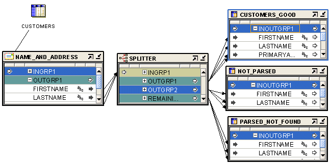

This example uses a mapping with a Name and Address operator to cleanse name and address records, followed by a Splitter operator to load the records into separate targets depending on whether they were successfully parsed. This section explains the general steps required to design such a mapping.
To make the listed changes to the sample record:
In the Mapping Editor, begin by adding the following operators to the canvas:
A CUSTOMERS table from which you extract the records. This is the data source. It contains the data in Table 24-18.
A Name and Address operator. This action starts the Name and Address Wizard. Follow the steps of the wizard.
A Splitter operator. For information on using this operator, see "Splitter Operator".
Three target operators into which you load the successfully parsed records, the records with parsing errors, and the records whose addresses are parsed but not found in the postal matching software.
Map the attributes from the CUSTOMERS table to the Name and Address operator ingroup. Map the attributes from the Name and Address operator outgroup to the Splitter operator ingroup.
You are not required to use the Splitter operator, but it provides an important function in separating good records from problematic records.
Define the split conditions for each of the outgroups in the Splitter operator and map the outgroups to the targets.
Figure 24-2 shows a mapping designed for this example. The data is mapped from the source table to the Name and Address operator, and then to the Splitter operator. The Splitter operator separates the successfully parsed records from those that have errors. The output from OUTGRP1 is mapped to the CUSTOMERS_GOOD target. The split condition for OUTGRP2 is set such that records whose Is Parsed flag is False are loaded to the NOT_PARSED target. That is, the Split Condition for OUTGRP2 is set as INGRP1.ISPARSED='F'. The Records in the REMAINING_RECORDS group are successfully parsed, but their addresses are not found by the postal matching software. These records are loaded to the PARSED_NOT_FOUND target.
Figure 24-2 Name and Address Operator Used with a Splitter Operator in a Mapping
If you run the mapping designed in this example, the Name and Address operator standardizes, corrects, and completes the address data from the source table. In this example, the target table contains the address data as shown in Table 24-19. Compare it with the input record from Table 24-18 .

The Is Parsed flag indicates success or failure of the parsing process. If Is Parsed indicates parsing success, you may still wish to check the parser warning flags, which indicate unusual data. You may want to check those records manually.
If Is Parsed indicates parsing failure, you must preserve the original data to prevent data loss.
Use the Splitter operator to map successful records to one target and failed records to another target.
Use the Match-Merge operator to identify matching records in a data source and merge them into a single record.
The Match-Merge operator has one input group and two output groups, Merge and Xref. The source data is mapped to the input group. The Merge group contains records that have been merged after the matching process is complete. The Xref group provides a record of the merge process. Every record in the input group will have a corresponding record in the Xref group. This record may contain the original attribute values and the merged attributes.
The Match-Merge operator uses an ordered record stream as input. From this stream, it constructs the match bins. From each match bin, matched sets are constructed. From each matched set, a merged record is created. The initial query will contain an ORDER BY clause consisting of the match bin attributes.
To match and merge source data using the Match-Merge operator:
Drag and drop the operators representing the source data and the operator representing the merged data onto the mapping editor canvas:
For example, if your source data is stored in a table, and the merged data will be stored in another table, drag and drop two Table operators that are bound to the tables onto the canvas.
Drag and drop a Match-Merge operator onto the mapping editor canvas.
The MatchMerge wizard is displayed.
On the Name and Address page, the Name field contains a default name for the operator. You can change this name or accept the default name.
You can enter an optional description for the operator.

Map the Merge group of the Match-Merge operator to the input group of the operator that stores the merged data.
Figure 24-3 shows a mapping you can design using a Match-Merge operator. Notice that the Match-Merge operator is preceded by a Name and Address operator, NAMEADDR, and a staging table, CLN_CUSTOMERS. You can design your mapping with or without a Name and Address operator. Preceding the Match-Merge operator with a Name and Address operator provides clean and standardized data before starting time consuming match and merge operations
Figure 24-3 Match-Merge Operator in a Mapping

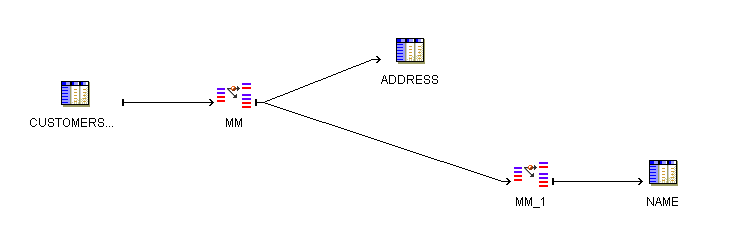

Most match-merge operations can be performed by a single match-merge operator. However, if you are directing the output to two different targets, then you may need to use two match-merge operators in succession.
For example, when householding name and address data, you may need to merge the data first for addresses and then again for names. Assuming you map the MERGE output to a target table, you can map the XREF group to another Match-Merge operator. Although you could map the XREF group to a staging table, this practice can lead to significant loss of performance.
Figure 24-4 shows a mapping that uses two match-merge operators. The XREF group from MM is mapped directly to MM_1. For this mapping to be valid, you must assign the Match ID generated for the first XREF group as the Match Bin rule on the second Match-Merge operator.
Figure 24-4 Householding Data: XREF Group Merged to Second Match-Merge Operator
