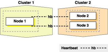

For example, you can use cloning to quickly duplicate a successfully installed Oracle Clusterware environment to create a new cluster. Figure 3-1 shows the end result of a cloning procedure in which the Oracle Clusterware home on Node 1 has been cloned to Node 2 and Node 3 on Cluster 2, making Cluster 2 a new two-node cluster.
Figure 3-1 Cloning to Create a New Oracle Clusterware Environment
At a high level, the steps to create a new cluster through cloning are as follows:
