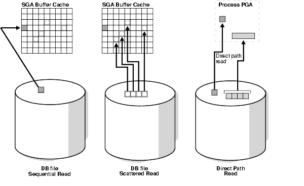

"db file scattered read" and "db file sequential read" for the difference between a scattered read and a sequential read, and how this affects I/O

Figure 10-1 depicts the differences between the following wait events:
db file sequential read (single block read into one SGA buffer)
db file scattered read (multiblock read into many discontinuous SGA buffers)
direct read (single or multiblock read into the PGA, bypassing the SGA)
Figure 10-1 Scattered Read, Sequential Read, and Direct Path Read
When a session is reading buffers from disk directly into the PGA (opposed to the buffer cache in SGA), it waits on this event. If the I/O subsystem does not support asynchronous I/Os, then each wait corresponds to a physical read request.
If the I/O subsystem supports asynchronous I/O, then the process is able to overlap issuing read requests with processing the blocks already existing in the PGA. When the process attempts to access a block in the PGA that has not yet been read from disk, it then issues a wait call and updates the statistics for this event. Hence, the number of waits is not necessarily the same as the number of read requests (unlike db file scattered read and db file sequential read).
