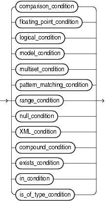

Conditions can have several forms, as shown in the following syntax.
If you have installed Oracle Text, then you can create conditions with the built-in operators that are part of that product, including CONTAINS, CATSEARCH, and MATCHES. For more information on these Oracle Text elements, refer to Oracle Text Reference.
If you are using Oracle Expression Filter, then you can create conditions with the built-in EVALUATE operator that is part of that product. For more information, refer to Oracle Database Rules Manager and Expression Filter Developer's Guide.
The sections that follow describe the various forms of conditions. You must use appropriate condition syntax whenever condition appears in SQL statements.
