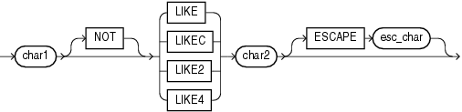

The LIKE conditions specify a test involving pattern matching. Whereas the equality operator (=) exactly matches one character value to another, the LIKE conditions match a portion of one character value to another by searching the first value for the pattern specified by the second. LIKE calculates strings using characters as defined by the input character set. LIKEC uses Unicode complete characters. LIKE2 uses UCS2 code points. LIKE4 uses UCS4 code points.
In this syntax:
char1 is a character expression, such as a character column, called the search value.
char2 is a character expression, usually a literal, called the pattern.
esc_char is a character expression, usually a literal, called the escape character.
The LIKE condition is the best choice in almost all situations. Use the following guidelines to determine whether any of the variations would be helpful in your environment:
Use LIKE2 to process strings using UCS-2 semantics. LIKE2 treats a Unicode supplementary character as two characters.
Use LIKE4 to process strings using UCS-4 semantics. LIKE4 treats a Unicode supplementary character as one character.
Use LIKEC to process strings using Unicode complete character semantics. LIKEC treats a composite character as one character.
If esc_char is not specified, then there is no default escape character. If any of char1, char2, or esc_char is null, then the result is unknown. Otherwise, the escape character, if specified, must be a character string of length 1.
All of the character expressions (char1, char2, and esc_char) can be of any of the datatypes CHAR, VARCHAR2, NCHAR, or NVARCHAR2. If they differ, then Oracle converts all of them to the datatype of char1.
