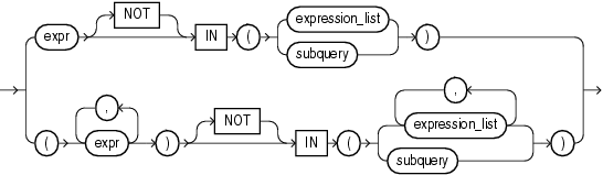

An in_condition is a membership condition. It tests a value for membership in a list of values or subquery
If you use the upper form of the in_condition condition (with a single expression to the left of the operator), then you must use the upper form of expression_list. If you use the lower form of this condition (with multiple expressions to the left of the operator), then you must use the lower form of expression_list, and the expressions in each expression_list must match in number and datatype the expressions to the left of the operator.
See Also:
"Expression Lists"Table 7-12 lists the form of IN condition.
