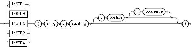

The INSTR
functions search string
for substring
. The function returns an integer indicating the position of the character in string
that is the first character of this occurrence. INSTR
calculates strings using characters as defined by the input character set. INSTRB
uses bytes instead of characters. INSTRC
uses Unicode complete characters. INSTR2
uses UCS2 code points. INSTR4
uses UCS4 code points.
