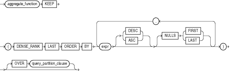

FIRST
and LAST
are very similar functions. Both are aggregate and analytic functions that operate on a set of values from a set of rows that rank as the FIRST
or LAST
with respect to a given sorting specification. If only one row ranks as FIRST
or LAST
, then the aggregate operates on the set with only one element.
This function takes as an argument any numeric datatype or any nonnumeric datatype that can be implicitly converted to a numeric datatype. The function returns the same datatype as the numeric datatype of the argument.
