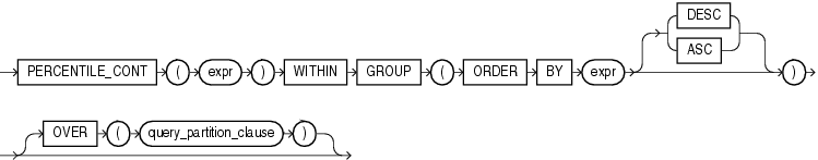

"Analytic Functions" for information on syntax, semantics, and restrictions of theOVER clausePERCENTILE_CONT is an inverse distribution function that assumes a continuous distribution model. It takes a percentile value and a sort specification, and returns an interpolated value that would fall into that percentile value with respect to the sort specification. Nulls are ignored in the calculation.
This function takes as an argument any numeric datatype or any nonnumeric datatype that can be implicitly converted to a numeric datatype. The function returns the same datatype as the numeric datatype of the argument.
See Also:
Table 2-10, "Implicit Type Conversion Matrix" for more information on implicit conversionThe first expr must evaluate to a numeric value between 0 and 1, because it is a percentile value. This expr must be constant within each aggregation group. The ORDER BY clause takes a single expression that must be a numeric or datetime value, as these are the types over which Oracle can perform interpolation.
The result of PERCENTILE_CONT is computed by linear interpolation between values after ordering them. Using the percentile value (P) and the number of rows (N) in the aggregation group, you can compute the row number you are interested in after ordering the rows with respect to the sort specification. This row number (RN) is computed according to the formula RN = (1+ (P*(N-1)). The final result of the aggregate function is computed by linear interpolation between the values from rows at row numbers CRN = CEILING(RN) and FRN = FLOOR(RN).

You can use the PERCENTILE_CONT function as an analytic function. You can specify only the query_partitioning_clause in its OVER clause. It returns, for each row, the value that would fall into the specified percentile among a set of values within each partition.
The MEDIAN function is a specific case of PERCENTILE_CONT where the percentile value defaults to 0.5. For more information, refer to MEDIAN.
