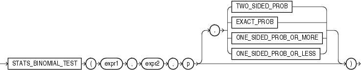

STATS_BINOMIAL_TEST
Syntax
Description of stats_binomial_test.gif follows
Purpose
STATS_BINOMIAL_TEST is an exact probability test used for dichotomous variables, where only two possible values exist. It tests the difference between a sample proportion and a given proportion. The sample size in such tests is usually small.
This function takes four arguments: expr1 is the sample being examined. expr2 contains the values for which the proportion is expected to be, and p is a proportion to test against. The fourth argument is a return value of type VARCHAR2. If you omit the fourth argument, then the default is TWO_SIDED_PROB. The meaning of the return values is shown in Table 5-3.
