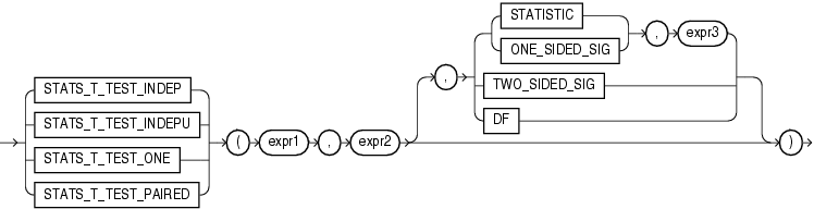

Syntax
stats_t_test::=
Description of stats_t_test.gif follows
