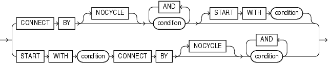

If a table contains hierarchical data, then you can select rows in a hierarchical order using the hierarchical query clause:
START WITH specifies the root row(s) of the hierarchy.
CONNECT BY specifies the relationship between parent rows and child rows of the hierarchy.
The NOCYCLE parameter instructs Oracle Database to return rows from a query even if a CONNECT BY loop exists in the data. Use this parameter along with the CONNECT_BY_ISCYCLE pseudocolumn to see which rows contain the loop. Refer to CONNECT_BY_ISCYCLE Pseudocolumn for more information.
In a hierarchical query, one expression in condition must be qualified with the PRIOR operator to refer to the parent row. For example,
... PRIOR expr = expr or ... expr = PRIOR expr
