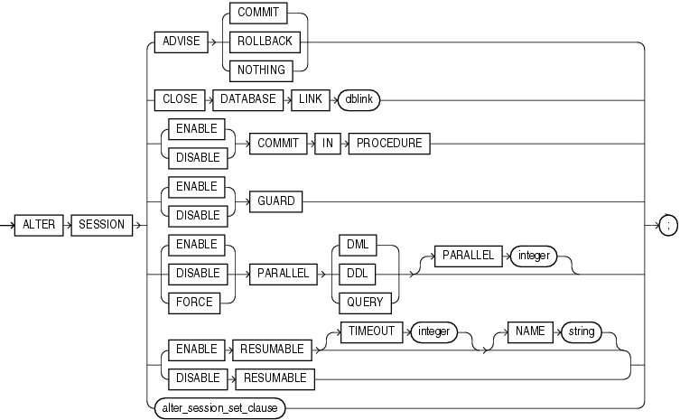

Use the ALTER SESSION statement to set or modify any of the conditions or parameters that affect your connection to the database. The statement stays in effect until you disconnect from the database.
To enable and disable the SQL trace facility, you must have ALTER SESSION system privilege.
To enable or disable resumable space allocation, you must have the RESUMABLE system privilege.
You do not need any privileges to perform the other operations of this statement unless otherwise indicated.
The ADVISE clause sends advice to a remote database to force a distributed transaction. The advice appears in the ADVICE column of the DBA_2PC_PENDING view on the remote database (the values are 'C' for COMMIT, 'R' for ROLLBACK, and '  ' for NOTHING). If the transaction becomes in doubt, then the administrator of that database can use this advice to decide whether to commit or roll back the transaction.
You can send different advice to different remote databases by issuing multiple ALTER SESSION statements with the ADVISE clause in a single transaction. Each such statement sends advice to the databases referenced in the following statements in the transaction until another such statement is issued.

The security_clause of ALTER DATABASE lets you prevent anyone other than the SYS user from making any changes to data or database objects on the primary or standby database. This clause lets you override that setting for the current session.
The PARALLEL parameter determines whether all subsequent DML, DDL, or query statements in the session will be considered for parallel execution. This clause enables you to override the degree of parallelism of tables during the current session without changing the tables themselves. Uncommitted transactions must either be committed or rolled back prior to executing this clause for DML.

These clauses let you enable and disable resumable space allocation. This feature allows an operation to be suspended in the event of an out-of-space error condition and to resume automatically from the point of interruption when the error condition is fixed.

Use the alter_session_set_clause to set initialization parameter values for the session.
Initialization Parameters You can set two types of parameters using this clause:
Initialization parameters that are dynamic in the scope of the ALTER SESSION statement (listed in "Initialization Parameters and ALTER SESSION")
Session parameters (listed in "Session Parameters and ALTER SESSION")
You can set values for multiple parameters in the same alter_session_set_clause.
