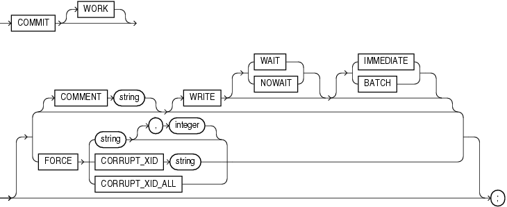

All clauses after the COMMIT keyword are optional. If you specify only COMMIT, then the default is COMMIT WORK WRITE IMMEDIATE WAIT.
The WORK keyword is supported for compliance with standard SQL. The statements COMMIT and COMMIT WORK are equivalent.
This clause is supported for backward compatibility. Oracle recommends that you used named transactions instead of commit comments.

You can specify the WAIT | NOWAIT and IMMEDIATE | BATCH clauses in any order.
if you omit this clause, then the behavior of the commit operation is controlled by theCOMMIT_WRITE initialization parameter, if it as been set. The default value of the parameter is the same as the default for this clause. Therefore, if the parameter has not been set and you omit this clause, then commit records are written to disk before control is returned to the user.WAIT | NOWAIT Use these clauses to specify when control returns to the user.

Oracle Database Advanced Application Developer's Guide for more information on asynchronous commitUse this clause to manually commit an in-doubt distributed transaction or a corrupt transaction.
In a distributed database system, the FORCE string [, integer] clause lets you manually commit an in-doubt distributed transaction. The transaction is identified by the 'string' containing its local or global transaction ID. To find the IDs of such transactions, query the data dictionary view DBA_2PC_PENDING. You can use integer to specifically assign the transaction a system change number (SCN). If you omit integer, then the transaction is committed using the current SCN.
The FORCE CORRUPT_XID 'string' clause lets you manually commit a single corrupt transaction, where string is the ID of the corrupt transaction. Query the V$CORRUPT_XID_LIST data dictionary view to find the transaction IDs of corrupt transactions. You must have DBA privileges to view the V$CORRUPT_XID_LIST and to specify this clause.
Specify FORCE CORRUPT_XID_ALL to manually commit all corrupt transactions. You must have DBA privileges to specify this clause.
ACOMMIT statement with a FORCE clause commits only the specified transactions. Such a statement does not affect your current transaction.See Also:
