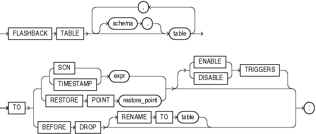

Use the FLASHBACK TABLE statement to restore an earlier state of a table in the event of human or application error. The time in the past to which the table can be flashed back is dependent on the amount of undo data in the system. Also, Oracle Database cannot restore a table to an earlier state across any DDL operations that change the structure of the table.

Specify the schema containing the table. If you omit schema, then the database assumes the table is in your own schema.
Specify the name of one or more tables containing data you want to revert to an earlier version.

Specify the system change number (SCN) corresponding to the point in time to which you want to return the table. The expr must evaluate to a number representing a valid SCN.
Specify a timestamp value corresponding to the point in time to which you want to return the table. The expr must evaluate to a valid timestamp in the past. The table will be flashed back to a time within approximately 3 seconds of the specified timestamp.
Specify a restore point to which you want to flash back the table. The restore point must already have been created.

CREATE RESTORE POINT for information on creating restore pointsBy default, Oracle Database disables all enabled triggers defined on table during the Flashback Table operation and then reenables them after the Flashback Table operation is complete. Specify ENABLE TRIGGERS if you want to override this default behavior and keep the triggers enabled during the Flashback process.
This clause affects only those database triggers defined on table that are already enabled. To enable currently disabled triggers selectively, use the ALTER TABLE ... enable_disable_clause before you issue the FLASHBACK TABLE statement with the ENABLE TRIGGERS clause.
Use this clause to retrieve from the recycle bin a table that has been dropped, along with all possible dependent objects. The table must have resided in a locally managed tablespace other than the SYSTEM tablespace.

Oracle Database attempts to preserve the original table name. If a new table of the same name has been created in the same schema since the original table was dropped, then the database returns an error unless you also specify the RENAME TO clause.
RENAME TO Clause Use this clause to specify a new name for the table being retrieved from the recycle bin.
