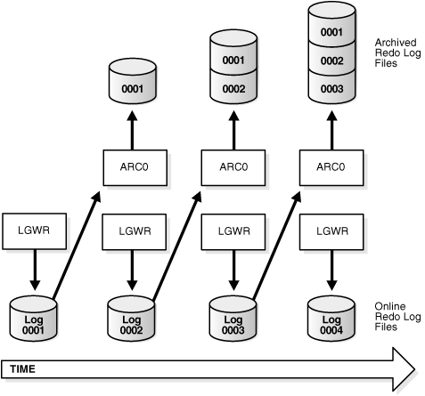

When you run a database in ARCHIVELOG mode, you enable the archiving of the redo log. The database control file indicates that a group of filled redo log files cannot be reused by LGWR until the group is archived. A filled group becomes available for archiving immediately after a redo log switch occurs.

You can configure an instance to archive filled redo log files automatically, or you can archive manually. For convenience and efficiency, automatic archiving is usually best. Figure 11-1 illustrates how the archiver process (ARC0 in this illustration) writes filled redo log files to the database archived redo log.

Figure 11-1 Redo Log File Use in ARCHIVELOG Mode
