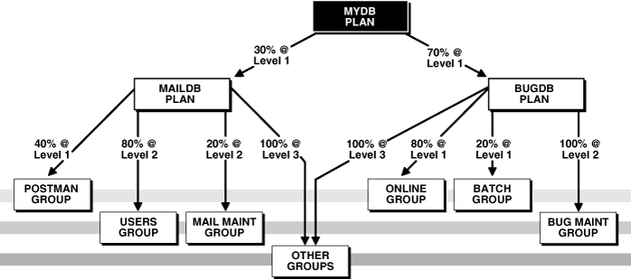

The following PL/SQL block creates a multilevel plan as illustrated in Figure 25-3. Default resource allocation method settings are used for all plans and resource consumer groups.
BEGIN DBMS_RESOURCE_MANAGER.CREATE_PENDING_AREA(); DBMS_RESOURCE_MANAGER.CREATE_PLAN(PLAN => 'bugdb_plan', COMMENT => 'Resource plan/method for bug users sessions'); DBMS_RESOURCE_MANAGER.CREATE_PLAN(PLAN => 'maildb_plan', COMMENT => 'Resource plan/method for mail users sessions'); DBMS_RESOURCE_MANAGER.CREATE_PLAN(PLAN => 'mydb_plan', COMMENT => 'Resource plan/method for bug and mail users sessions'); DBMS_RESOURCE_MANAGER.CREATE_CONSUMER_GROUP(CONSUMER_GROUP => 'Online_group', COMMENT => 'Resource consumer group/method for online bug users sessions'); DBMS_RESOURCE_MANAGER.CREATE_CONSUMER_GROUP(CONSUMER_GROUP => 'Batch_group', COMMENT => 'Resource consumer group/method for batch job bug users sessions'); DBMS_RESOURCE_MANAGER.CREATE_CONSUMER_GROUP(CONSUMER_GROUP => 'Bug_Maint_group', COMMENT => 'Resource consumer group/method for users sessions for bug db maint'); DBMS_RESOURCE_MANAGER.CREATE_CONSUMER_GROUP(CONSUMER_GROUP => 'Users_group', COMMENT => 'Resource consumer group/method for mail users sessions'); DBMS_RESOURCE_MANAGER.CREATE_CONSUMER_GROUP(CONSUMER_GROUP => 'Postman_group', COMMENT => 'Resource consumer group/method for mail postman'); DBMS_RESOURCE_MANAGER.CREATE_CONSUMER_GROUP(CONSUMER_GROUP => 'Mail_Maint_group', COMMENT => 'Resource consumer group/method for users sessions for mail db maint'); DBMS_RESOURCE_MANAGER.CREATE_PLAN_DIRECTIVE(PLAN => 'bugdb_plan', GROUP_OR_SUBPLAN => 'Online_group', COMMENT => 'online bug users sessions at level 1', MGMT_P1 => 80, MGMT_P2=> 0); DBMS_RESOURCE_MANAGER.CREATE_PLAN_DIRECTIVE(PLAN => 'bugdb_plan', GROUP_OR_SUBPLAN => 'Batch_group', COMMENT => 'batch bug users sessions at level 1', MGMT_P1 => 20, MGMT_P2 => 0, PARALLEL_DEGREE_LIMIT_P1 => 8); DBMS_RESOURCE_MANAGER.CREATE_PLAN_DIRECTIVE(PLAN => 'bugdb_plan', GROUP_OR_SUBPLAN => 'Bug_Maint_group', COMMENT => 'bug maintenance users sessions at level 2', MGMT_P1 => 0, MGMT_P2 => 100); DBMS_RESOURCE_MANAGER.CREATE_PLAN_DIRECTIVE(PLAN => 'bugdb_plan', GROUP_OR_SUBPLAN => 'OTHER_GROUPS', COMMENT => 'all other users sessions at level 3', MGMT_P1 => 0, MGMT_P2 => 0, MGMT_P3 => 100); DBMS_RESOURCE_MANAGER.CREATE_PLAN_DIRECTIVE(PLAN => 'maildb_plan', GROUP_OR_SUBPLAN => 'Postman_group', COMMENT => 'mail postman at level 1', MGMT_P1 => 40, MGMT_P2 => 0); DBMS_RESOURCE_MANAGER.CREATE_PLAN_DIRECTIVE(PLAN => 'maildb_plan', GROUP_OR_SUBPLAN => 'Users_group', COMMENT => 'mail users sessions at level 2', MGMT_P1 => 0, MGMT_P2 => 80); DBMS_RESOURCE_MANAGER.CREATE_PLAN_DIRECTIVE(PLAN => 'maildb_plan', GROUP_OR_SUBPLAN => 'Mail_Maint_group', COMMENT => 'mail maintenance users sessions at level 2', MGMT_P1 => 0, MGMT_P2 => 20); DBMS_RESOURCE_MANAGER.CREATE_PLAN_DIRECTIVE(PLAN => 'maildb_plan', GROUP_OR_SUBPLAN => 'OTHER_GROUPS', COMMENT => 'all other users sessions at level 3', MGMT_P1 => 0, MGMT_P2 => 0, MGMT_P3 => 100); DBMS_RESOURCE_MANAGER.CREATE_PLAN_DIRECTIVE(PLAN => 'mydb_plan', GROUP_OR_SUBPLAN => 'maildb_plan', COMMENT=> 'all mail users sessions at level 1', MGMT_P1 => 30); DBMS_RESOURCE_MANAGER.CREATE_PLAN_DIRECTIVE(PLAN => 'mydb_plan', GROUP_OR_SUBPLAN => 'bugdb_plan', COMMENT => 'all bug users sessions at level 1', MGMT_P1 => 70); DBMS_RESOURCE_MANAGER.VALIDATE_PENDING_AREA(); DBMS_RESOURCE_MANAGER.SUBMIT_PENDING_AREA(); END;

In this plan schema, CPU resources are allocated as follows:
Under mydb_plan, 30% of CPU is allocated to the maildb_plan subplan, and 70% is allocated to the bugdb_plan subplan. Both subplans are at level 1. Because mydb_plan itself has no levels below level 1, any resource allocations that are unused by either subplan at level 1 can be used by its sibling subplan. Thus, if maildb_plan uses only 20% of CPU, then 80% of CPU is available to bugdb_plan.
maildb_plan defines allocations at levels 1, 2, and 3, and bugdb_plan defines allocations at levels 1 and 2. The levels in these subplans are independent of levels in their parent plan, mydb_plan. That is, all plans and subplans in a plan schema have their own level 1, level 2, level 3, and so on.
Of the 30% of CPU allocated to maildb_plan, 40% of that amount (effectively 12% of total CPU) is allocated to Postman_group at level 1. Because Postman_group has no siblings at level 1, there is an implied 60% remaining at level 1. This 60% is then shared by Users_group and Mail_Maint_group at level 2, at 80% and 20%, respectively. In addition to this 60%, Users_group and Mail_Maint_group can also use any of the 40% not used by Postman_group at level 1.
CPU resources not used by either Users_group or Mail_Maint_group at level 2 are allocated to OTHER_GROUPS, because in multilevel plans, unused resources are reallocated to consumer groups or subplans at the next lower level, not to siblings at the same level. Thus, if Users_group uses only 70% instead of 80%, the remaining 10% cannot be used by Mail_Maint_group. That 10% is available only to OTHER_GROUPS at level 3.
