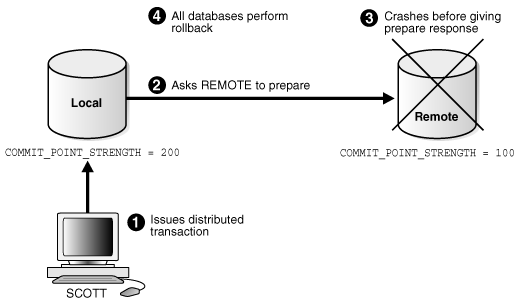

Figure 32-5 illustrates the sequence of events when there is a failure during the prepare phase of a distributed transaction:
The following steps occur:
User SCOTT
connects to Local
and executes a distributed transaction.
The global coordinator, which in this example is also the commit point site, requests all databases other than the commit point site to promise to commit or roll back when told to do so.
The remote
database crashes before issuing the prepare response back to local
The transaction is ultimately rolled back on each database by the RECO process when the remote site is restored.

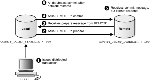

Figure 32-6 illustrates the sequence of events when there is a failure during the commit phase of a distributed transaction:
User Scott
connects to local
The global coordinator, which in this case is also the commit point site, requests all databases other than the commit point site to promise to commit or roll back when told to do so.
The commit point site receives a prepared message from remote
saying that it will commit.
The commit point site commits the transaction locally, then sends a commit message to remote
asking it to commit.
The remote
database receives the commit message, but cannot respond because of a network failure.
The transaction is ultimately committed on the remote database by the RECO process after the network is restored.
